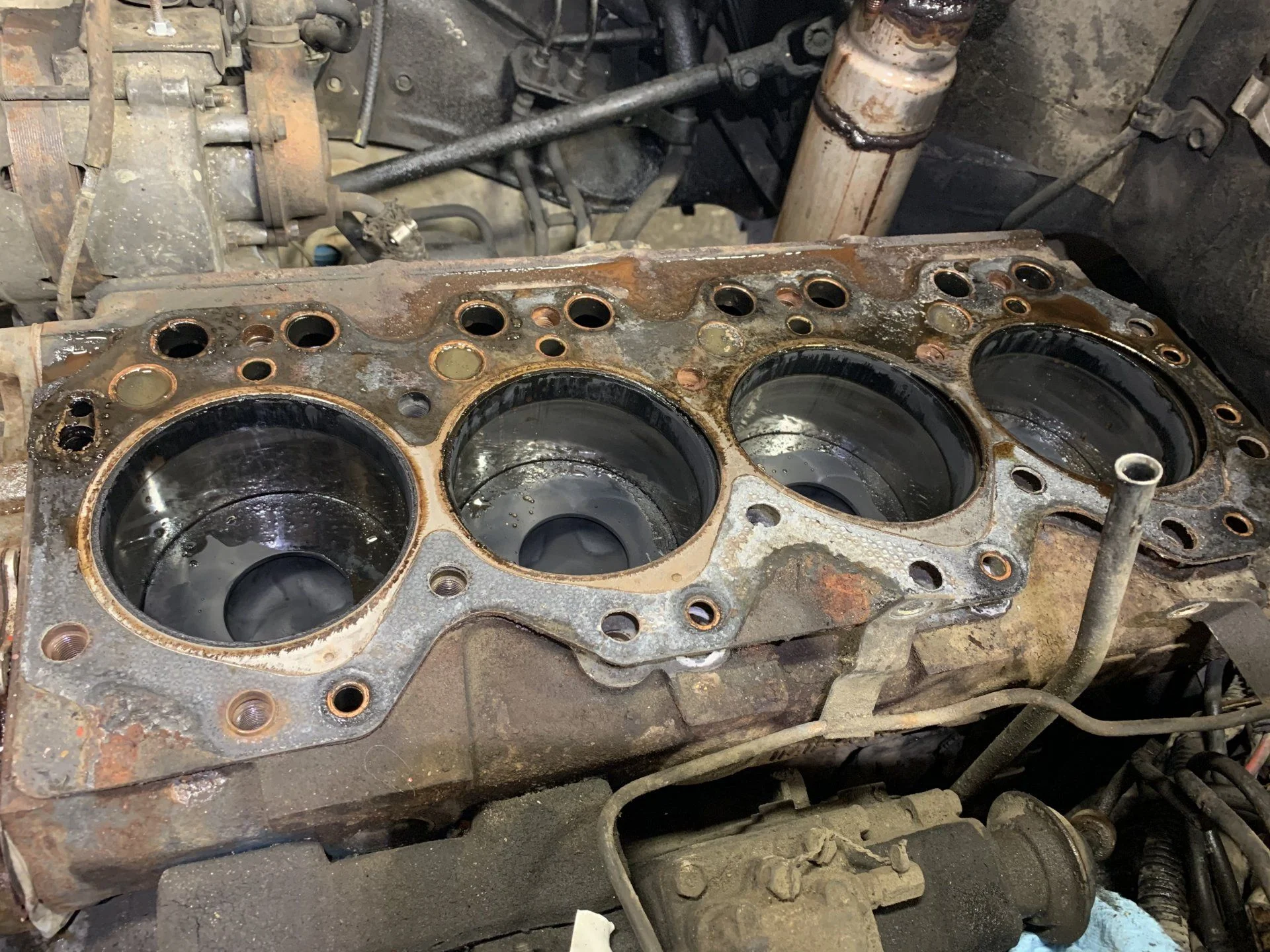

I guess it’s my turn... 1989 BJ74 13BT Head Gasket replacement.

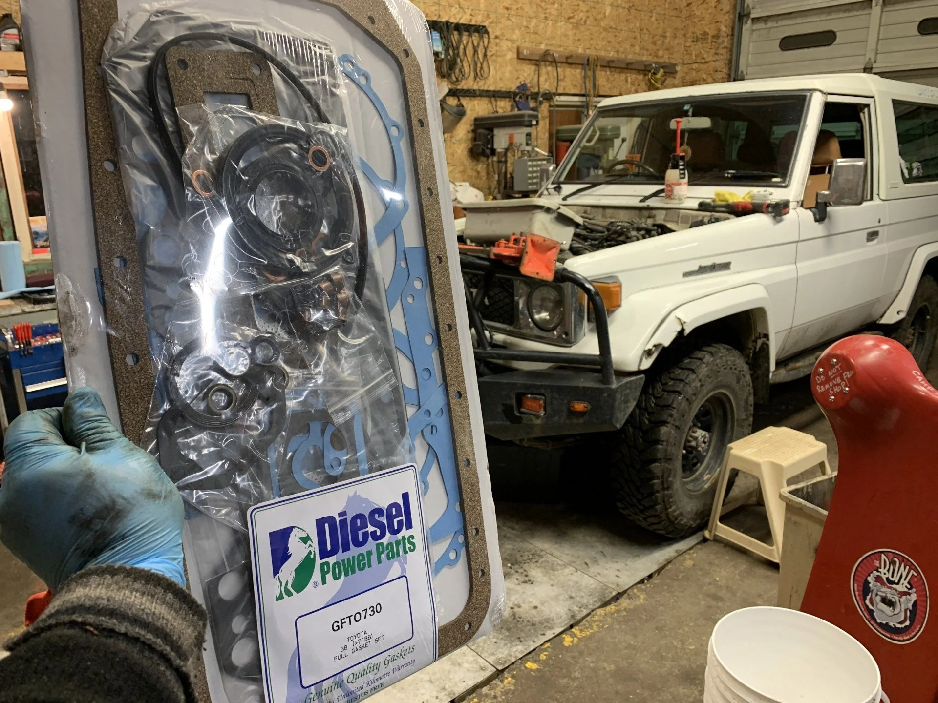

Thank you John @ RADD Cruisers online store for supplying the parts and the write up.
If you need parts to keep your Cruiser running, make sure to go to the on-line store
(RADD Cruisers 4WD Ltd. - https://radd-cruisers.shoplightspeed.com/)
1. Exhaust manifold gasket had two major leaks.

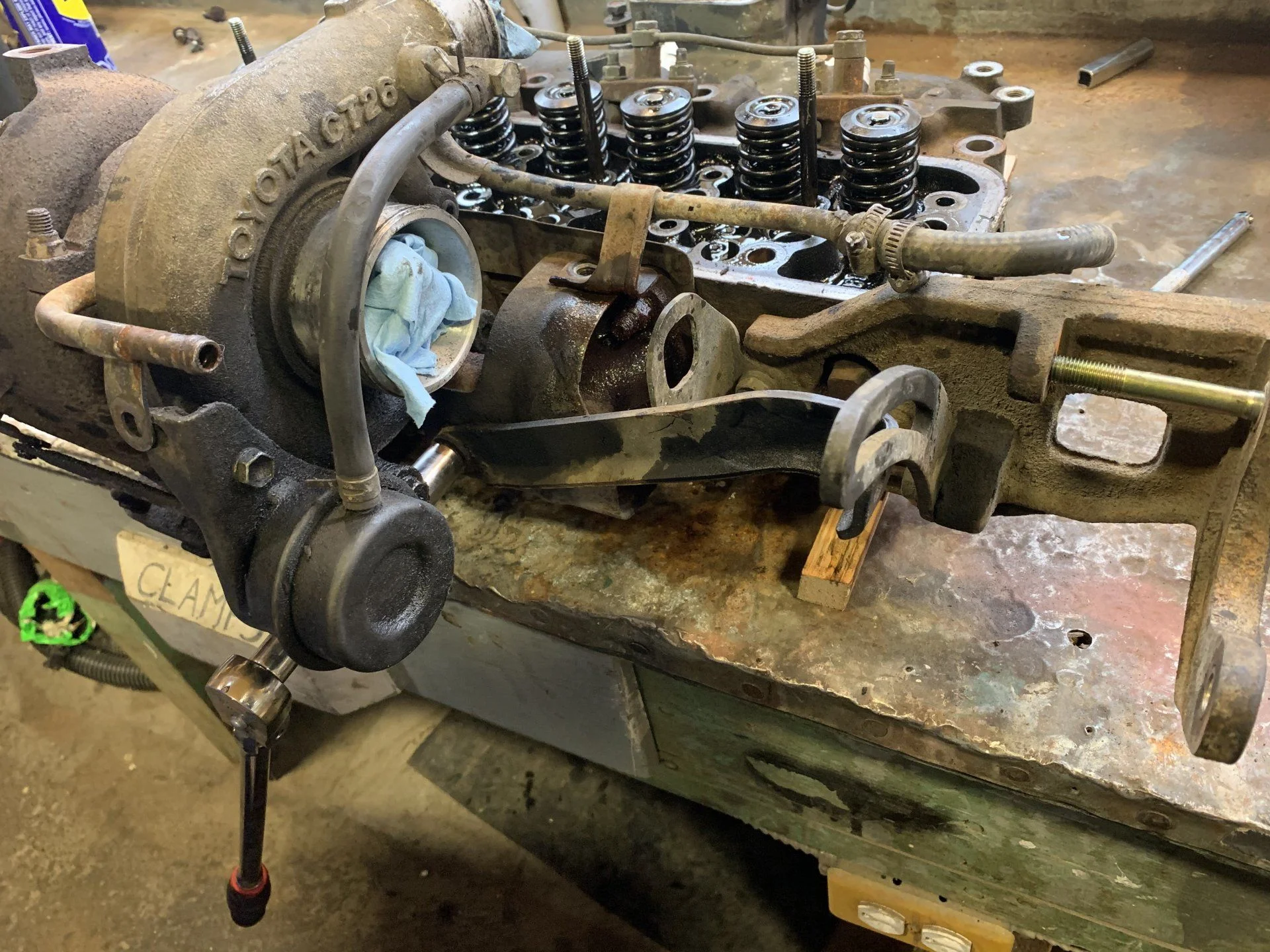

2. Wastegate holds zero pressure, requiring major air to open. Likely need to replace.
Gonna lap the valves, replace wastegate, and with new gaskets all around maybe the turbo will wake this little engine up a little :-)
