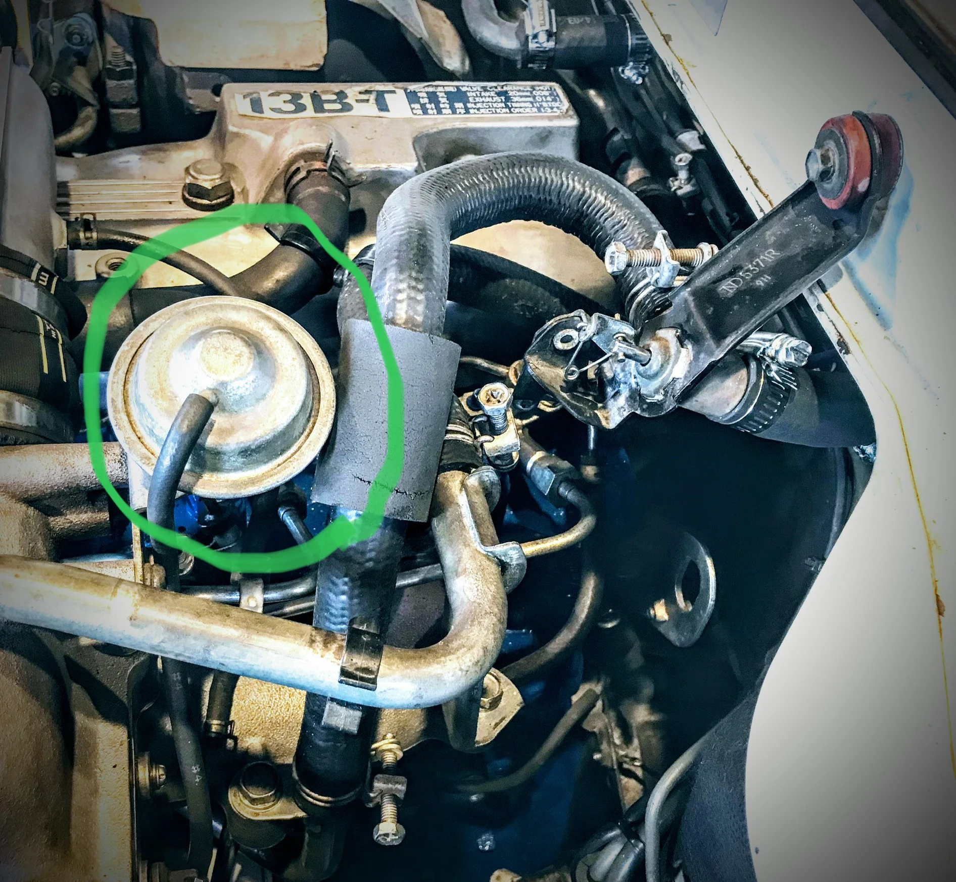

Can anybody provide me a pic of where the shutoff valve is. I’m currently have the same trouble with my BJ74
Left side of engine. Near firewall but you have to reach down fairly far. It has 2 vac hoses and an electrical connector. The main starter wire runs down that way too.

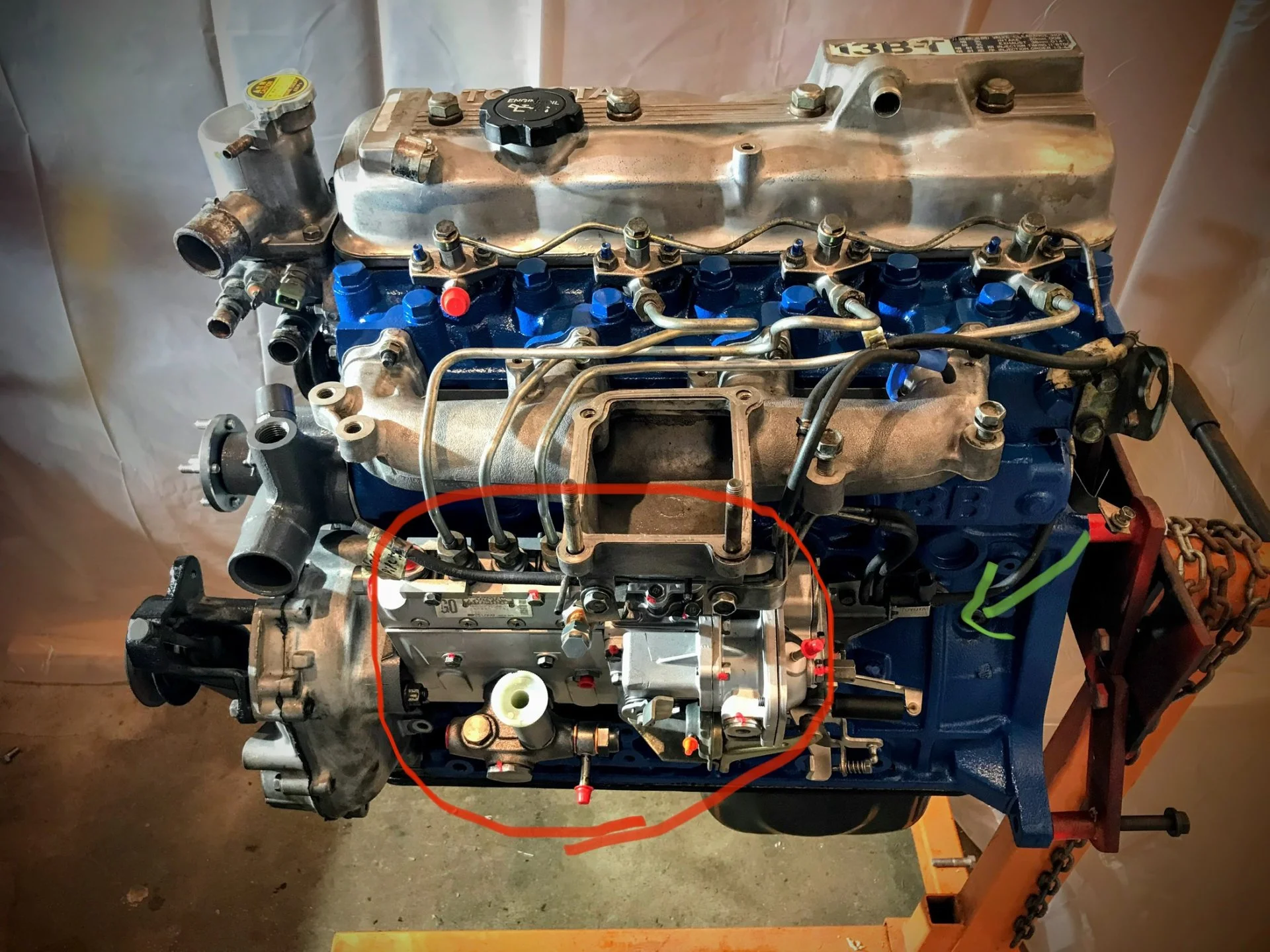

Anybody have a pic of the injector pump.?
Red circle injector pump
Green arrow the vacuum valve. It’s tucked under there and a pain to get to.
This green circle is your shutoff butterfly. When you shut the key off, vacuum is applied and closes the butterfly valve choking off all the air to the engine.
Unhook the vacuum line and it will stay open. If it still dies after starting, then this isn’t your problem.
