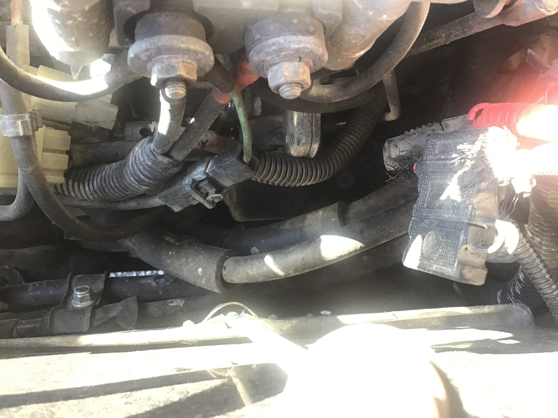

Here’s what I have.
Not sure if it is original but it works.
