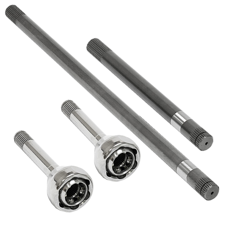

Looks like justdifferentials.com has Chromoly Birfield Kit With Shafts so we are good on the front:
http://www.justdifferentials.com/ProductDetails.asp?ProductCode=AXTBIRF-FJ40KIT

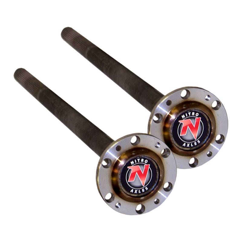

They seem to have a kit of HD shafts dedicated for the rear:
http://www.justdifferentials.com/ProductDetails.asp?ProductCode=AXTFF-FJ40
