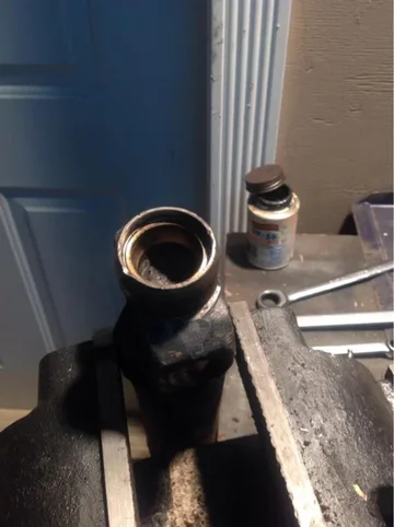

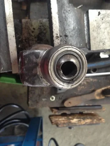

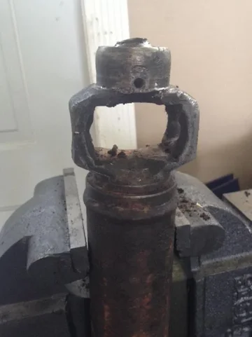

Working on the front driveshaft. Does anyone know how to get this bearing out? image-3963404503.webp image-579055000.webp
Pry the seal out with a flat blade, Pry from the ball side/inside. Dont pry on the outside of the seal. and then turn the bearing sideways and use two small punches or screwdrivers to pop it up and out. A bit of a bitch but youll get it. Try not to marr up the seal surface, put some tape or something on it..
The fun part is putting the assembly back together without messing up the needle bearings inside the ball. I cursed at mine for hours. Ha
Have fun!

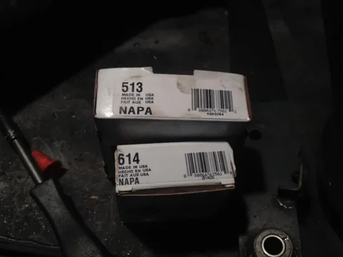

Thanks all for all the help. Repair is done. Driveshaft is back in the truck. Perfect timing because it snowed today and the commute will likely suck tomorrow.
Anyway, here are the parts we used:
