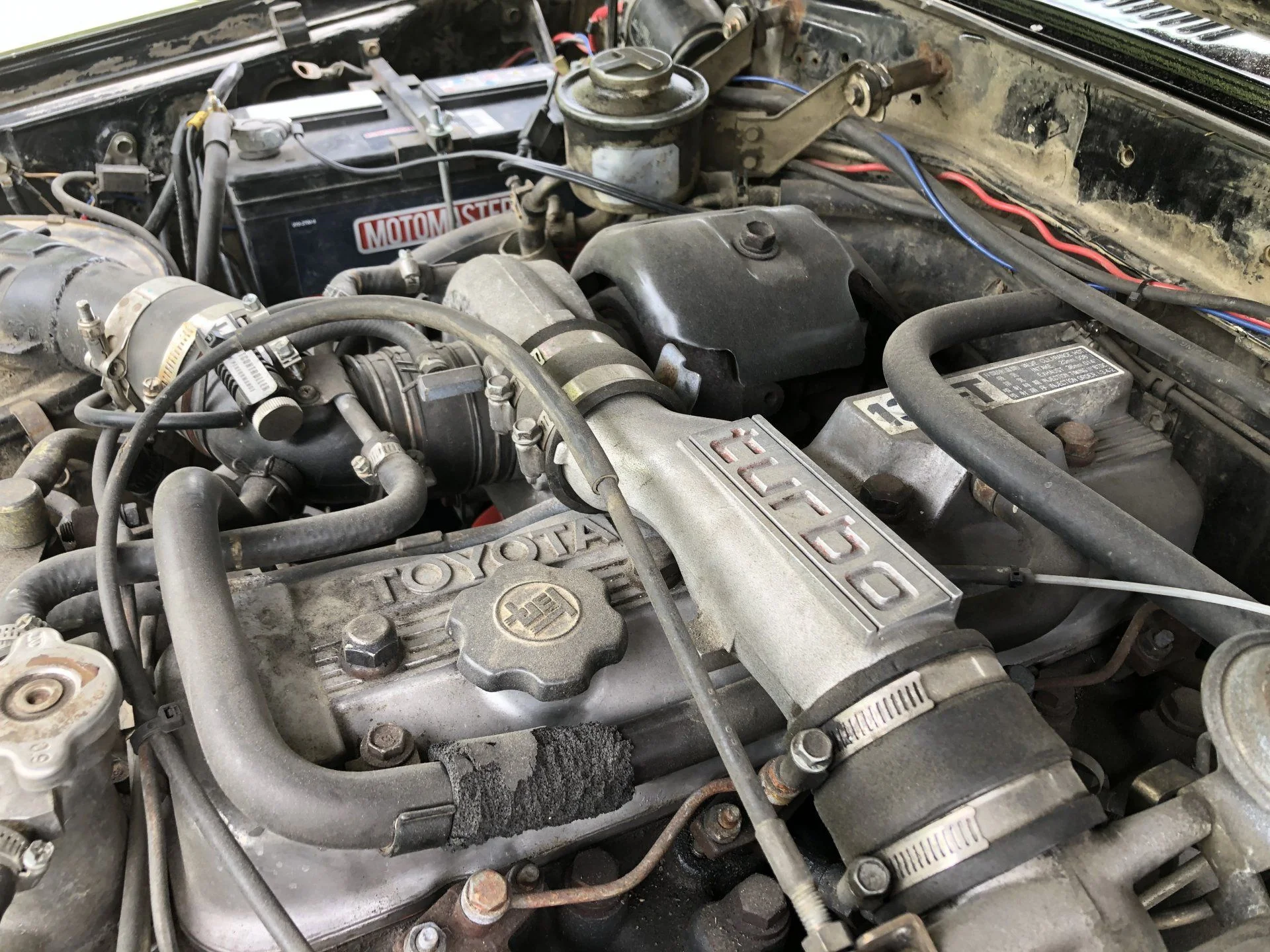

Next was to finally install the 13BT. the plan was to use the 13bt with a new asin clutch kit, with my spare H55 (lowish km) and my original split case because its manual shift.
everything went pretty smooth actually, gave the 13 a bit of a clean up, some blue paint *only becuase it was blue factory lol, then mated it up with the trans and t case.
i was able to break in the garage at my new house with a sketchy solo engine pull, tied the tailshaft of the trans to the rafters while the engine was on the hoist and pulled the 70 back with my 1st gen.
Going back in was pretty smooth, mostly just a bolt in ordeal. Once it went together i do have to say i love the 13BT, i think its gotta be one of the best mixes of technology that was offered. I have touched nothing as far as tuning on the engine, and it preforms as good or better than my strung out turbo 3B.... all while being at least 200deg lighter on the egt.

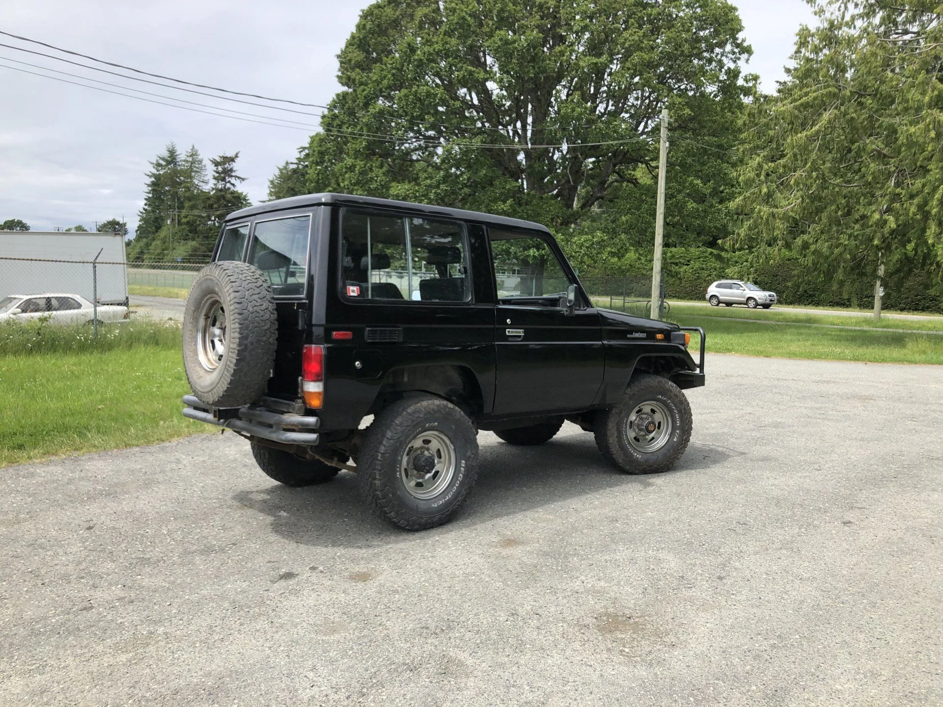

So while being on the fence about selling it, i thought it would be worth it either way to make it as nice as possible. So it was time to change the fenders and redo the C- bodywork at the back.
Lots of bodywork later i'm pretty happy with it. My painting learning curve is starting to flatten out the more that I'm able to try it. Its a strange obsession, i dont really enjoy any part of autobody but yet I'm always compelled to do better.

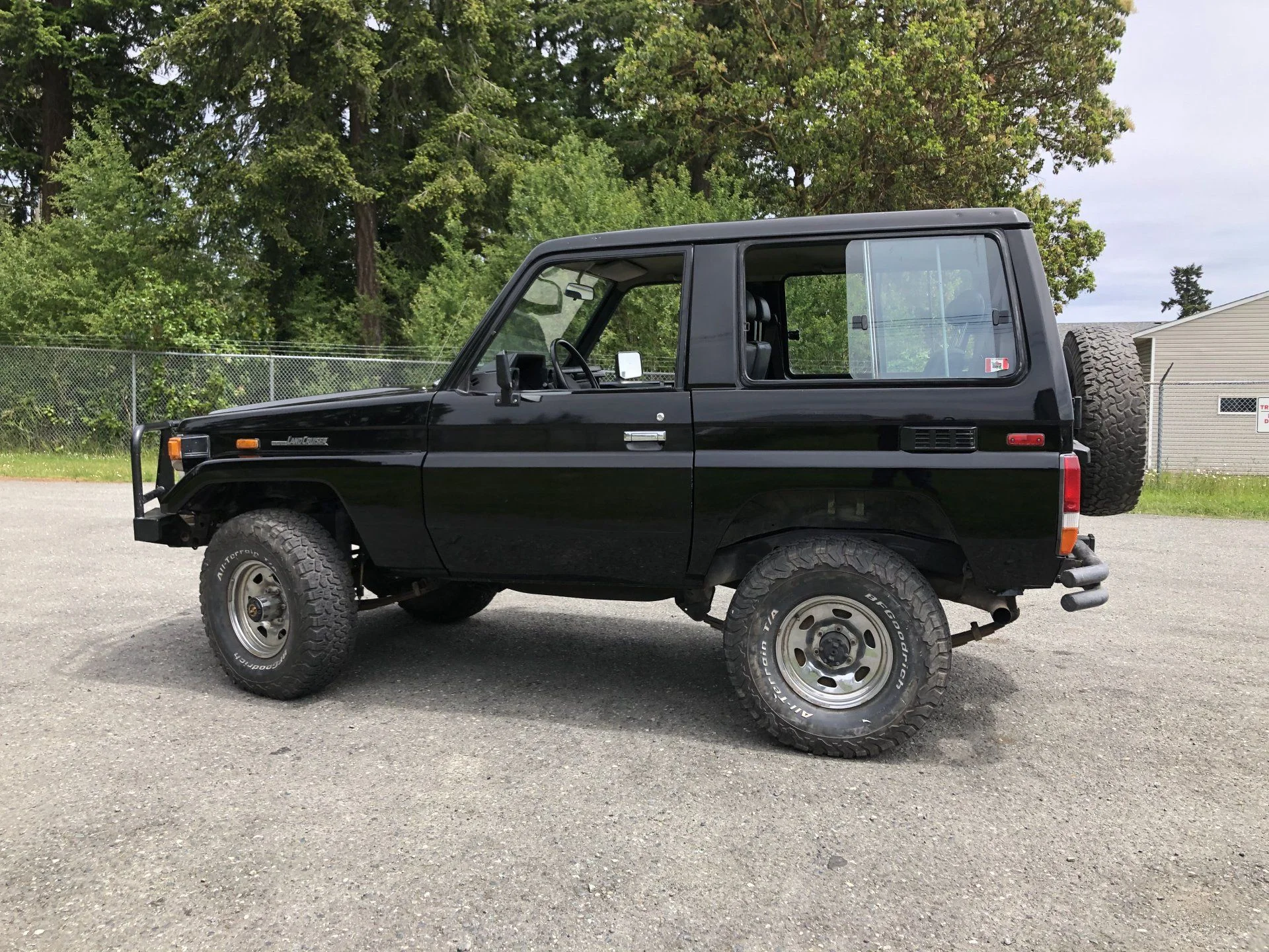

So on to the truck stats i guess, its a 1986 BJ70, original interior, some rust repair in the rear quarters and new fenders. well documented at this point. frame is actually nice, it has never had a hole or a patch, really the best you could ask for in a CDM truck that hasn't hidden in a garage or anything.
drievline is a 1989? 13BT, blue block 8 bolt flywheel if that means anything. H55 and axles from an '89 BJ70, 4.11s and full float rear.
custom bumper with an 8274 that works but could use some attention.
i really believe its a great truck that someone would be really happy with.
pricing is difficult... hard to pace a value on something like this.
I'd like to offer a club/friend price. $18,000
