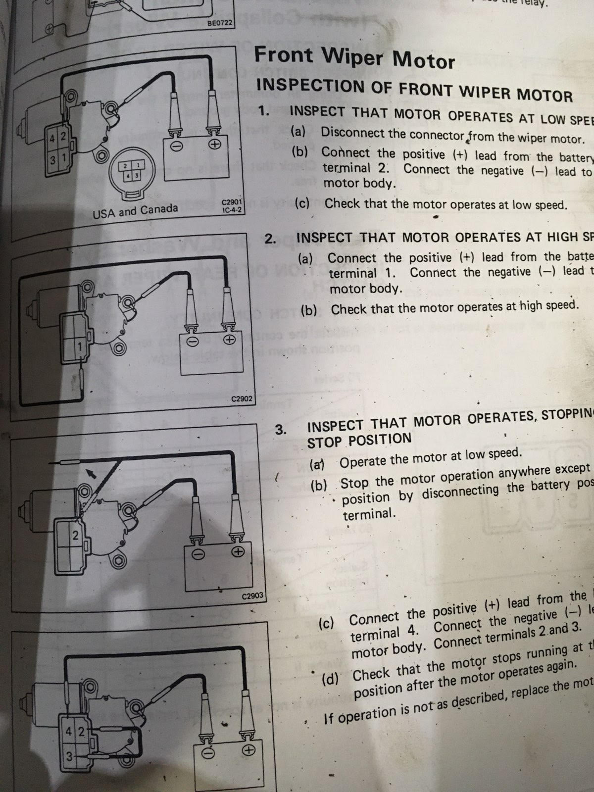

Another quick note. The testing instructions in the Toyota 1984 Manual suggest testing the motor for low speeds with +ve at terminal 2 and high speed at terminal 1. Neither worked for the set up we have. Testing at Terminal 4 worked fine. Installed motor and everything works as it should (intermittent, low, high). Can't explain the difference between the manual for the BJ70 and the actual BJ70 even though our wiring looked Canadian original. Just thought folks may want to be aware.
