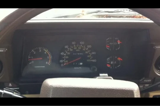

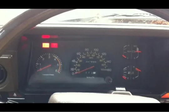

The weird thing is that the temp gauge jumps straight to the top right away when i turn the key to "ON". I dont remember when it started, but it was doing it before i changed the thermostat and still is now.
If the sensor wire is grounded, the gauge will read full hot. Check for a bad connection at the sensor where the wire may have gone to ground. Then, check the sensor for its resistance value and see if it's shagged (fairly likely). The temp sensor is common to a number of models and should be easy to get.
~John
Had the same issue ..... Traced it to a bad "ground" wire.
