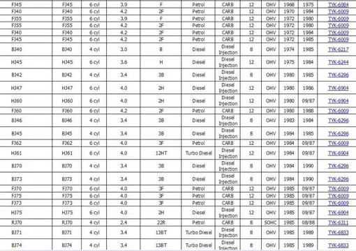

The bellhousings are different too and if I look at an aftermarket clutch-kit supplier like "Exedy", it tells me replacement clutch kits are different between the BJ40 and the BJ42 model (and they give the same kit for all BJ42 models as shown below):
