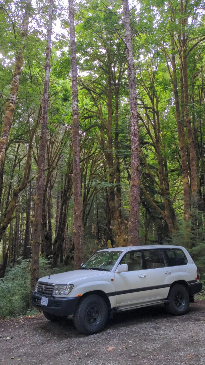

I put new springs with 40mm lifts on both Missus White and Mister Blue, a 2007 and 2003 105 respectively and 285/75R16 fill the wheel wells nicely. I can't remember if I changed the springs before or after putting new tires on, but either way that size is good on a stock 100 series. Just can actually swear to it on a 105. But it would not be the worst thing to put slightly taller springs on as I have.
I'm also very partial to the Kumho AT52 with its very square profile

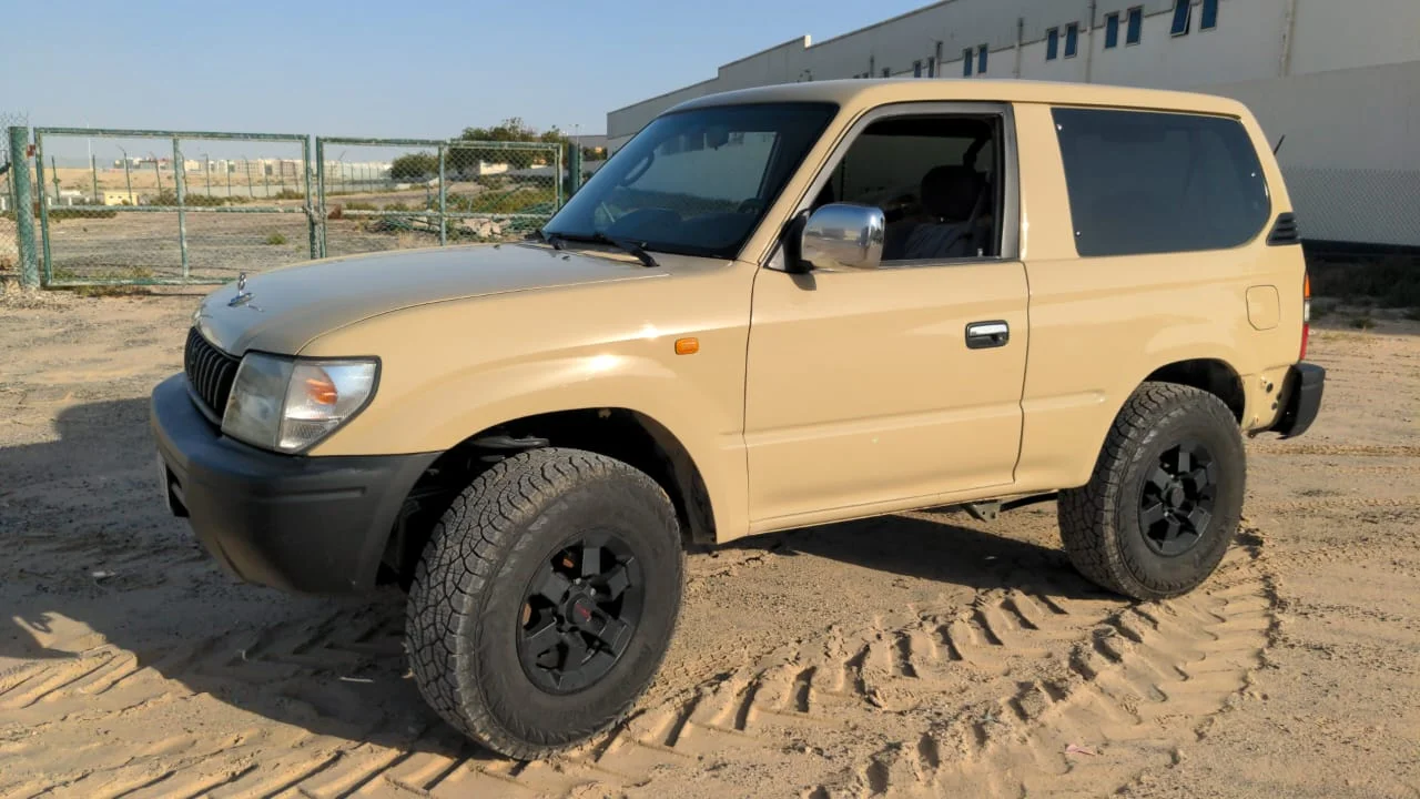

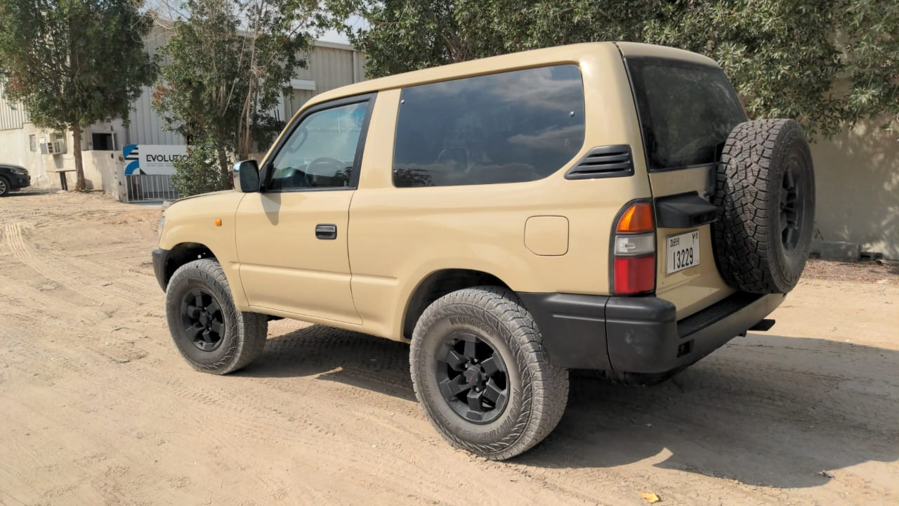

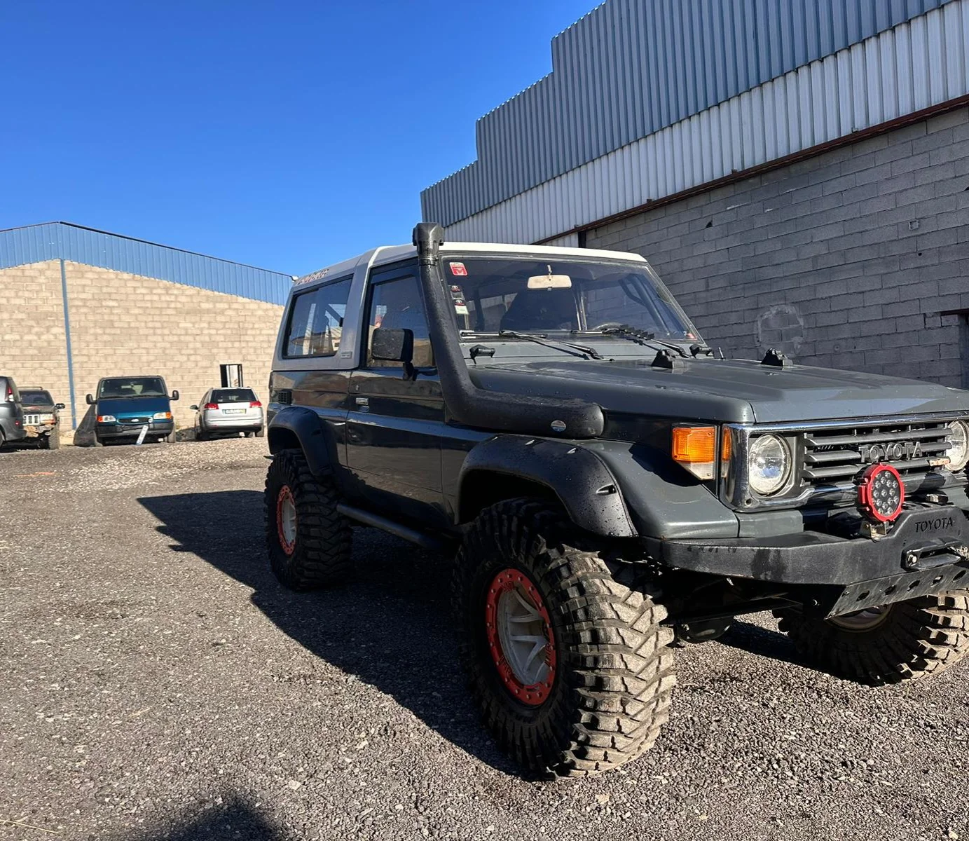

Nice 90 series!
I really like the shorty 90. I think it looks like a baby 100. They are very supportable i the US because the mechanicals are basically mid-90s tacos and 4runners.
Oh, I didn't know about that.
Myself, I was thinking about getting the kzj95 in Europe, but ended up getting this bj73 with the 1kz swap to see if I can do a couple of morroco trips.
