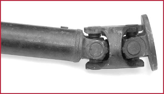

What is the negative effect of a short drive shaft? I guess since I don't know enough about this tranny it's hard for me to weigh the pros and cons. I do know that I want to continue to improve on the drivability of a 40 year vehicle to make it as enjoyable and comfortable as posible whether it be on the road as a daily driver or on the trail.
The shorter the driveshaft, the higher the angle between the pinion and tcase o/p. More prone to CV (Cardan joint to us Toyota folks) wear and tear and vibration. You would absolutely have to run a Double Cardan in lieu of a u-joint style driveshaft. Those can be had from some minitrucks pretty easily - that's what I run front and rear.
:beer: R
Double Cardan joint:
