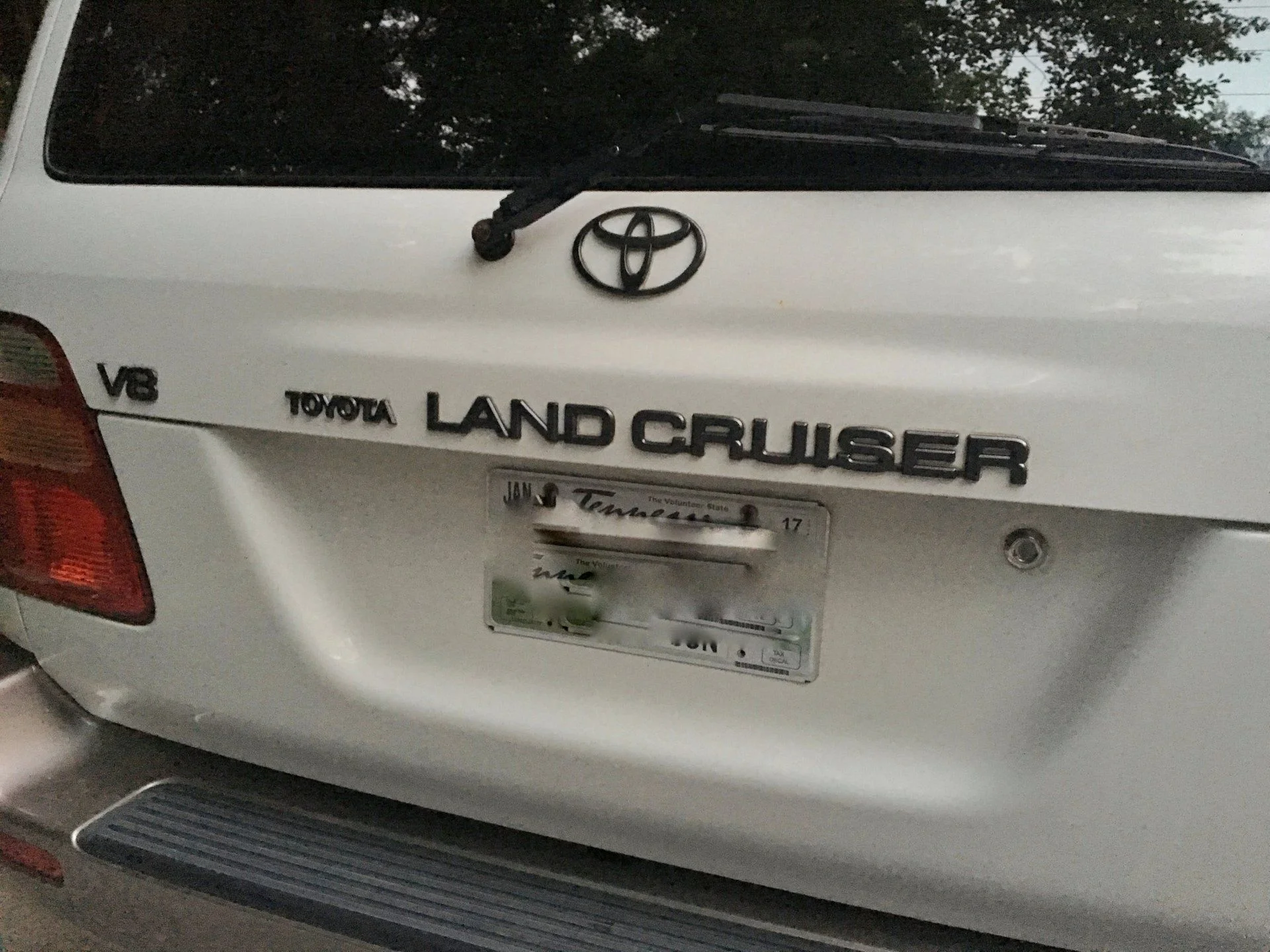

Sorry that the photo quality is lousy but after the plastidip suggestion and OG 91 LX's link, I ended up doing some searching and ran across this awesome Mazda Graphite metallic that several people have used for repainting their trim and wheels.
Couldn't resist getting it done, so I pulled all of the gold and sprayed it this afternoon. Really digging how it turned out. Wish the light was better. I'll take more tomorrow.
Great job! Looks bad ass!!!!
