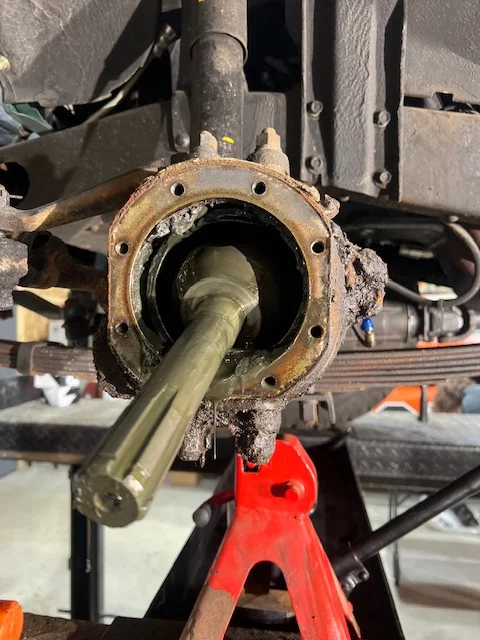

Jesse @Jdc1 put me in the front row of his shop to sit and watch this transformation. The photos will speak for themselves… here is a small preview with more to come.

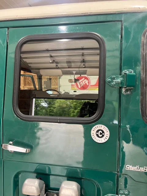

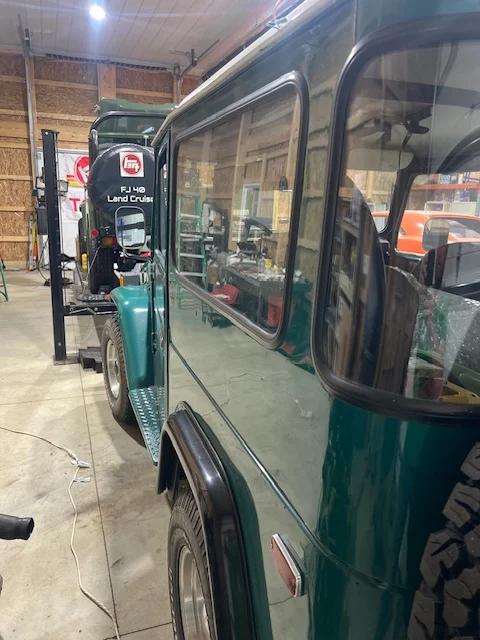

Just so it’s understood… I removed the rear ambulance door window last August …it finally back in
View attachment 3920311View attachment 3920312View attachment 3920313

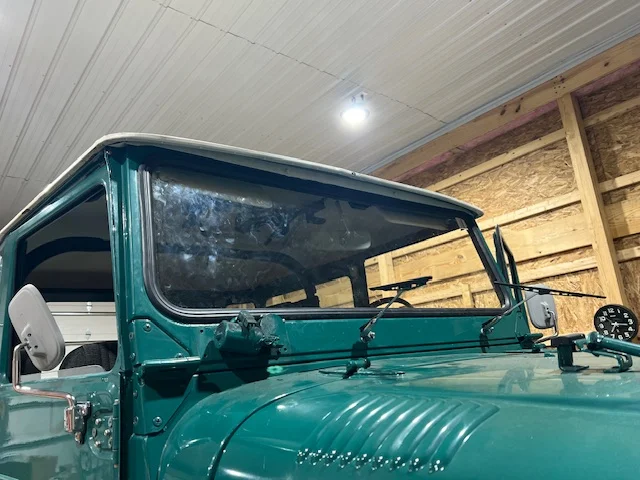

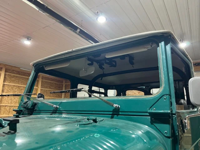

I have to send the pic of the clean windshield lol.
So, you see that…. @Jdc1 pays attention to the details… I’m happy to know there is a new windshield…he has to see it polished and clean…

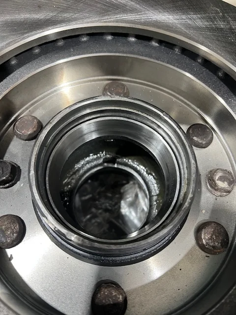

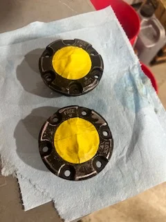

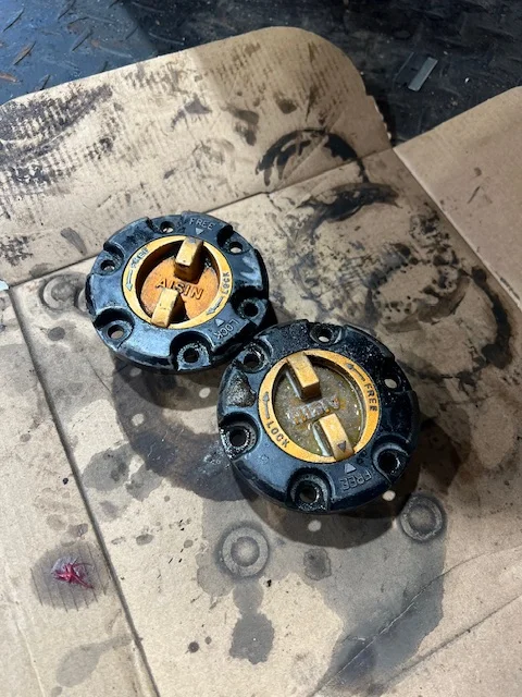

@Jdc1 has been sending me photos during his late night sessions. This man loves Land Cruiser stuff. Jesse works til 11;00pm some nights and deals with many other daytime activities for family. Look at these…. Plain old greasy, dirty, sticky locking hubs… well, not any more.. they look new but he wants to touch up the black

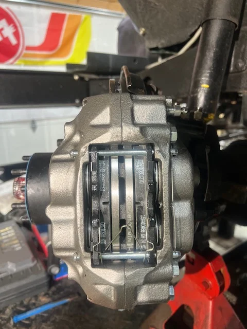

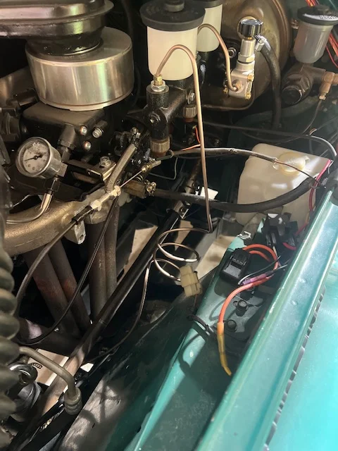

Here is another update from @Jdc1 … “it’s freakin’ hot today here.” On the other hand progress has been very steady and moving right along. Naturally I am excited to enjoy the pictures but there ain’t nothin’ like getting in there yourself….so THIS is the meaning of vicarious? As you can see from the list, almost all of it is complete. Jesse bled the brakes and while not without a a mild issue, like the flare tool breaking, Jesse ran out and bought another one to not let anything slow him down

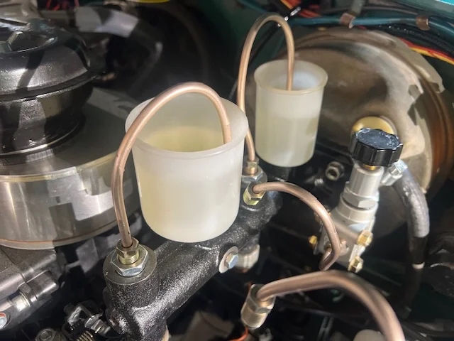

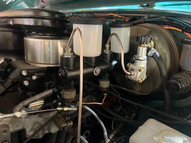

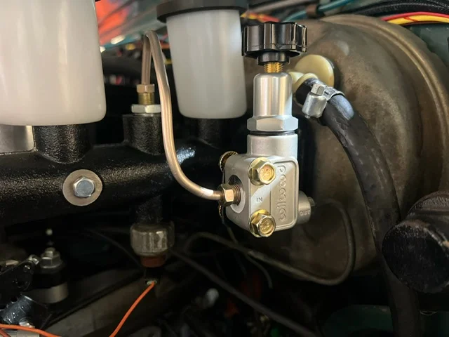

The City Racer master cylinder is installed, new brake lines and soft hoses all fit in nicely. Rear brakes are complete and final adjustments are next. Jesse made the new bracket for the Wilwood proportioning valve.

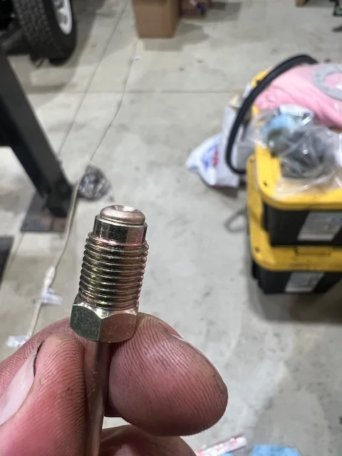

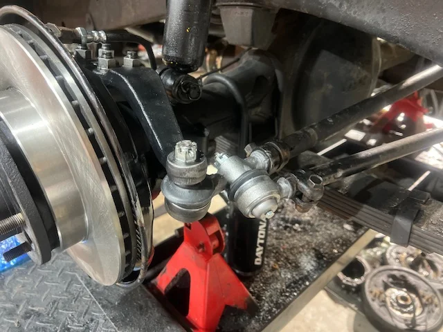

New Tie Rod Ends and 60 series taper adapters are all set but as usual, something always feels it does not want to cooperate
Bearing and races should make my 50 year old truck ride so differently. If Rubber City Land Cruisers can do something g for my 70+ year old joints, I’d be all set. The new differential gearing will make road travels nice…thanks for the idea @wngrog

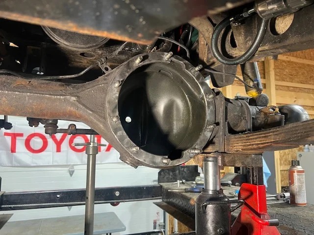

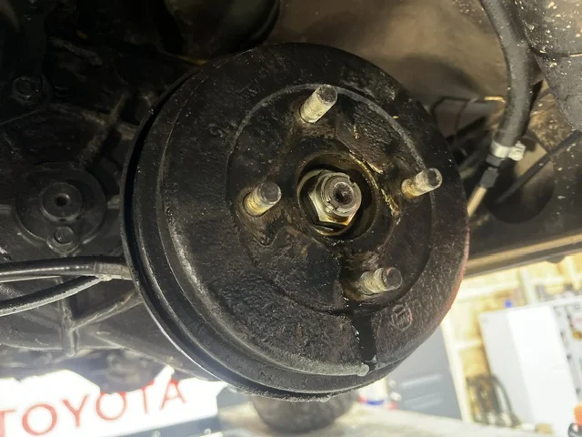

Here are a few more pictures including the day she landed at Rubber City Land Cruisers

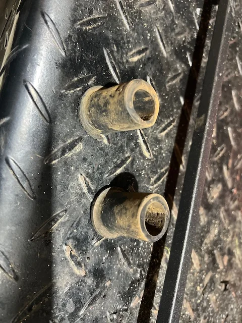

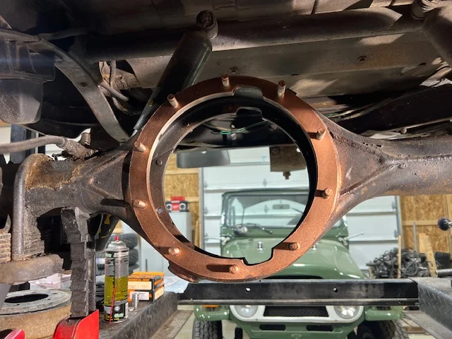

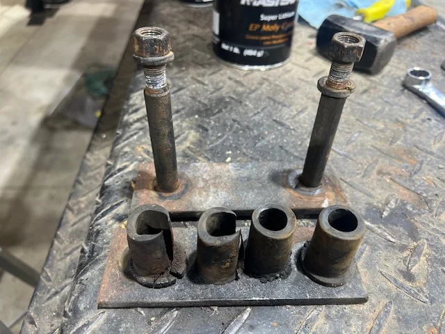

A view of the wasted rear bushings

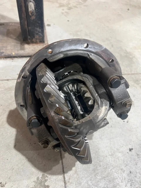

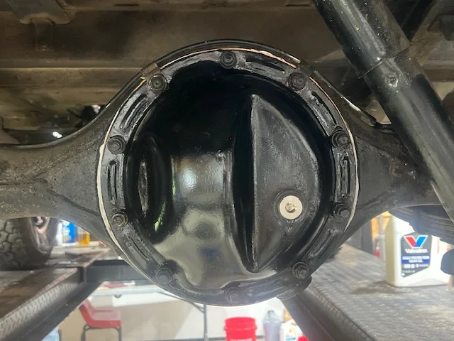

And the new differential mount
I know after a while they all look the same ….NO THEY DONT ! 🤣

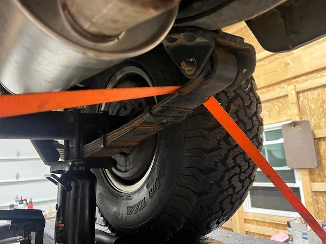

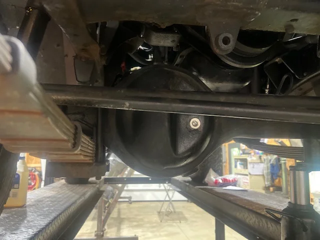

What's going on with the ratchet straps? All 4 wheels up on a 4 post and wrapping the straps around the lift to align the springs and hangers? I'm really not fully utilizing the benefit of the lifts I have access to.
Probably not OSHA compliant but, I use the strap to hold the spring down and then use my bottle jack to walk the spring eye into position to slide the pin into place.
Probably MUD compliant, I use the strap to hold the spring down and then use my bottle jack to walk the spring eye into position to slide the pin into place.
FIFY..👍🏻
Did you intend to post this on your sniper build thread? Looking forward to the updates!
