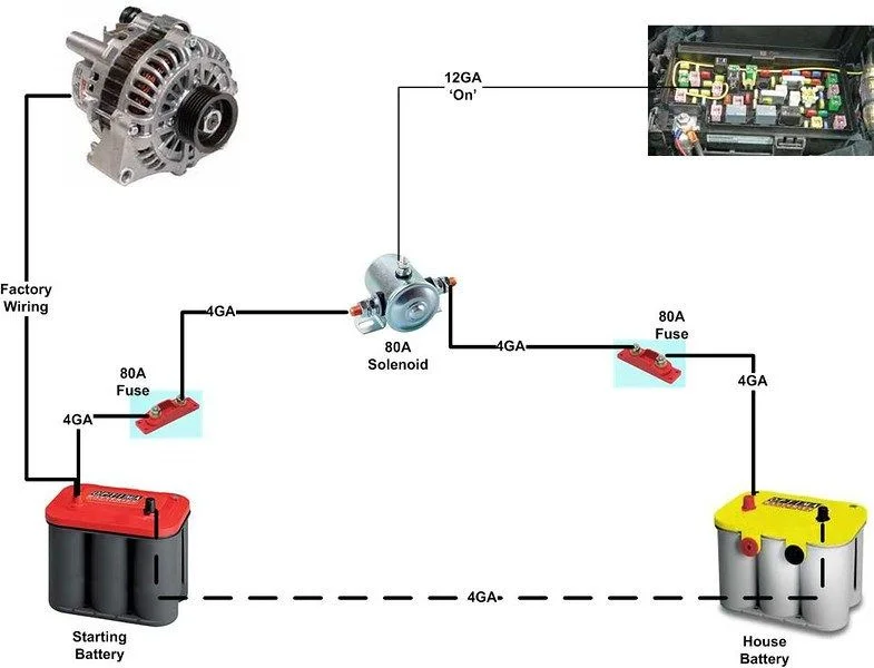

I believe there are a few companies that sell dual battery kits for the 2010+ model. Here's one from Shockworks that should give you an idea of whats possible.
A couple of 100 amp fuses, some battery cable and a 100 amp solenoid will do the trick for less than $100.
You can find all of this on Amazon.
I would go with a battery isolator. In other words two back to back silicon controlled rectifiers with a common gate. Cannot fail. I used this set-up back in the 80's when it was popular to have a thumper stereo with its own battery and a regular battery to run the car. Wired as BM shows but unlike solenoids, an isolator cannot fail destructively. It can fail but will only result in one battery not getting charged. Alternator charges both batteries, primary battery runs whatever it is currently hooked up too, secondary battery runs whatever you hook it up too. Neither battery can run the other batteries circuit, ie you always have a starter/runner battery even if the secondary battery is run dead.
