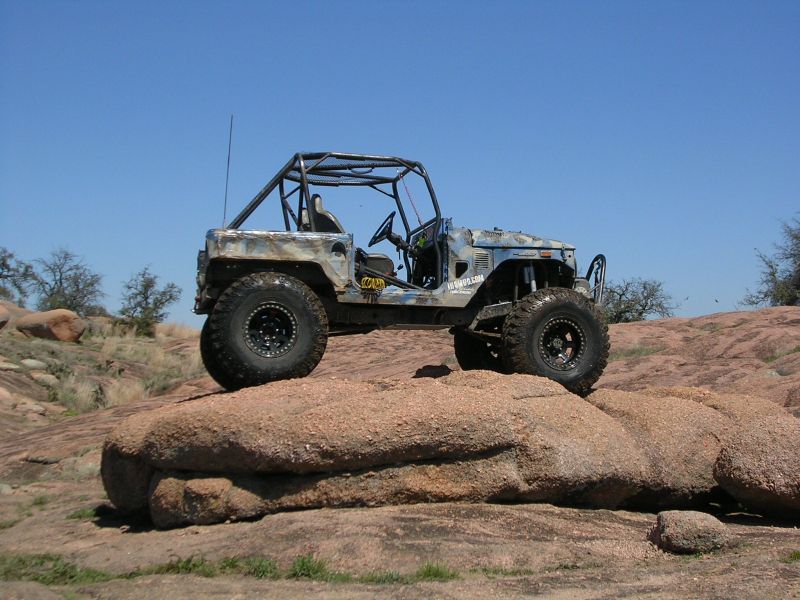

I have 23" of clearance with 40's and a flat bellypan (framerails)

My 420 will sit less than 1/4" below the frame, but the atlas is above it....
AWESOME rear shaft from THE MAN!
Have gained at least 4.5" under the truck, midframe area from the 420/toy-tcase combo previous...
Hope to have the skid plate framed up and in place this weekend....might get to go try and break something the 24th...

flat skidplate, 27" long from the front shackles to 5" back of where the rear link arms are attached to the frame.... Attached directly to the bottom of the frame, tighest clearance is to the t-case at 3/8", clearance to the tranny pan is just over 1/2"....piece of 3/8" 6061 alum.
~22" I believe to the bottom of the skid, with 39.5 IROKS.
