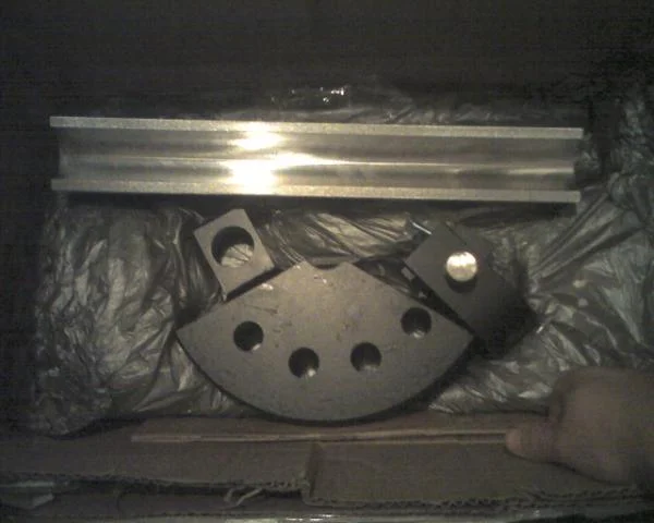

look what Fedex dropped off today:
1-3/4 6" clr pro tools HMP-200 to start. Now I just have to make a trip to the metal store and get building.

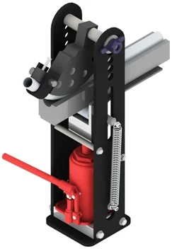

very cool. So you have to build the stand for it? Make it hydralic or manual?
this is what it will go in, at least my version of it:
Tube and Pipe Benders
Pro tools has a free set of plans available for this bender, but their plans require a lot of machined aluminum bolted together. I am going to build a simpler steel version and weld it together. I like the vertical designs better because I don't really have the space to swing a manual bender in my 1.5 car garage. I can also store this in the corner when I'm not using it.

pardon my ignorance, but you're above pic... how does the hydralic jack bend anything if it's going up at that angle? It appears that it would just clamp it
YouTube - Test_Bend.avi
the aluminum block sits on a roller and it moves forward with the tube as the bender die rotates. the pivot for the die is behind the center of the radius, I guess that it why it pushes it out instead of clamping.
