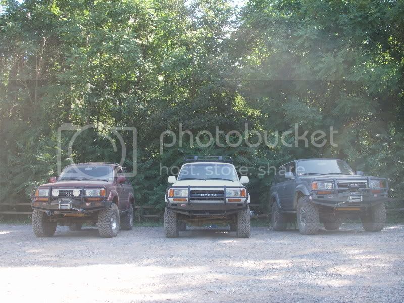

here is 35's 33's and 37's for reference........didnt make that much difference in what was doable at URE

Here is another comparison pic of three 80s with various suspension setup. From left to right:
1) OME heavies (3" lift) with 33" tires
2) OME stock (~1" lift) with 33" tires
3) Stock with 31" tires
Also take a look at the picture thread from the July URE meeting last weekend. We had five 80s with all levels of setup from stock to 4"+ lift.
