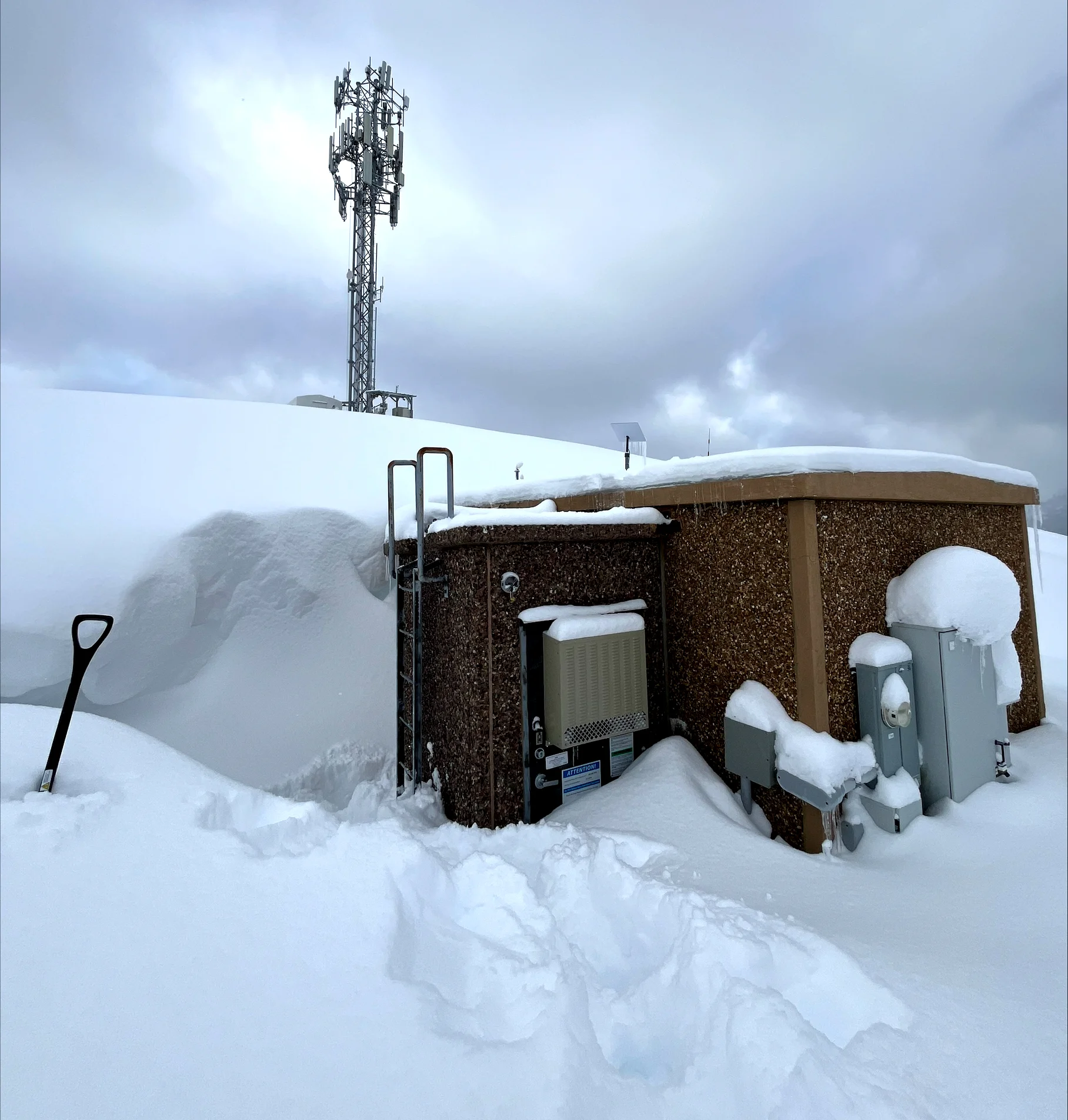

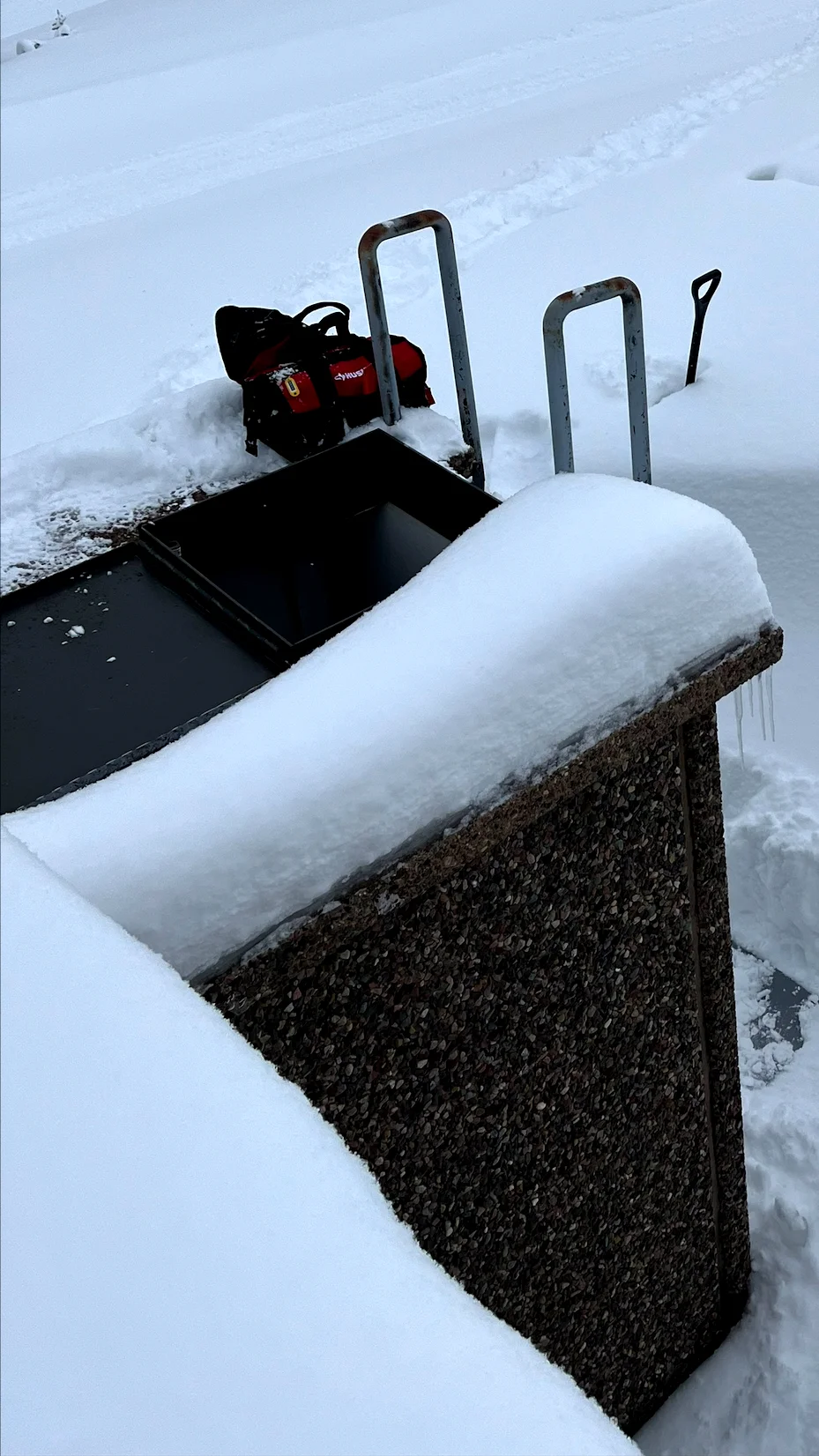

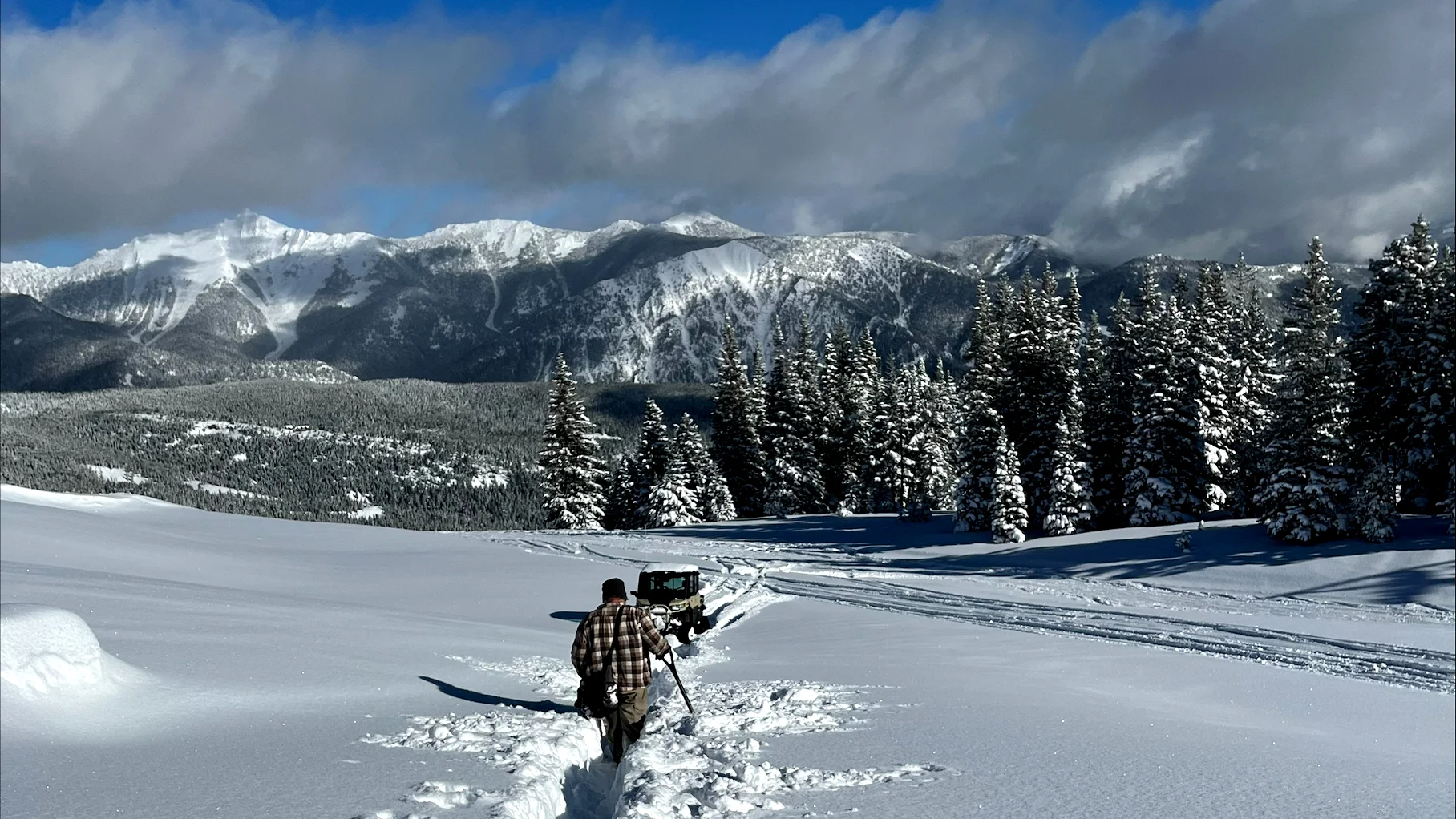

I did not take any photos during the recovery. My coworker is not at the same level of physical fitness as I am. (The shortcomings of my own physical fitness really come into focus above 7,500 feet.) I was working pretty hard to move around in the snow and make sure we didn't end up in a bad situation. Here's a couple photos from the actual tower site:
We went in through the roof hatch. I didn't want to dig the door out and the seals are likely frozen anyway.
Roof Hatch.
Coworker headed back down after we got our work done.

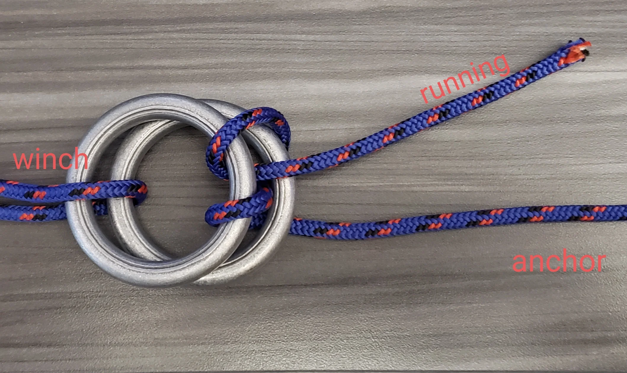

This is an idea I've come across. I'll see if I can get a couple appropriately sized master links and do some testing.
I just mocked this up for the photo on the desk with alpine cord and rappel rings. I don't love the need for metal hardware in the center of a tensioned line, which is also an issue with the X-Lock.
