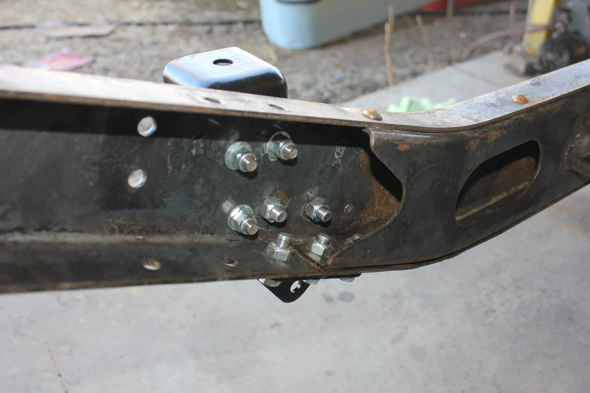

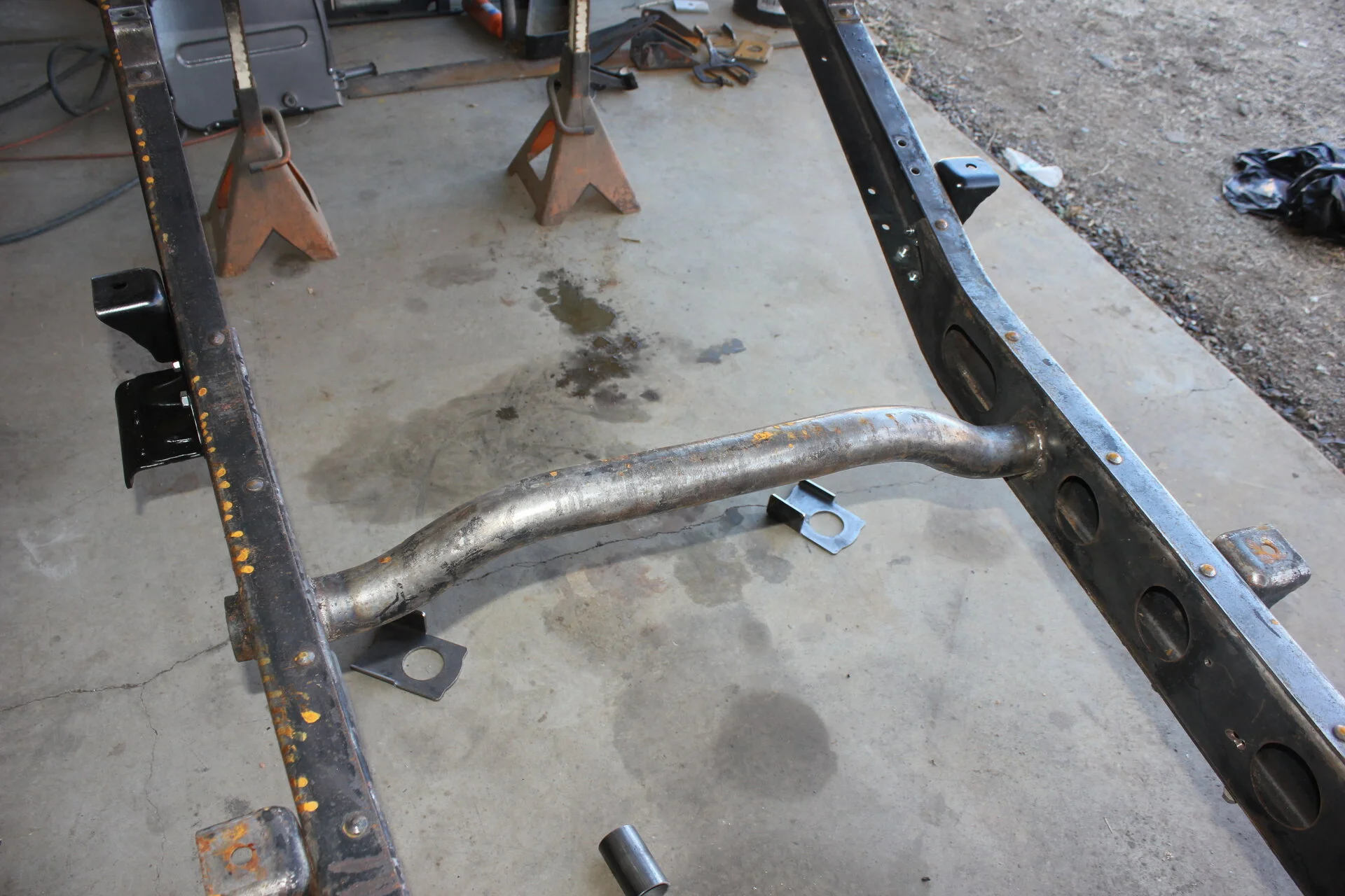

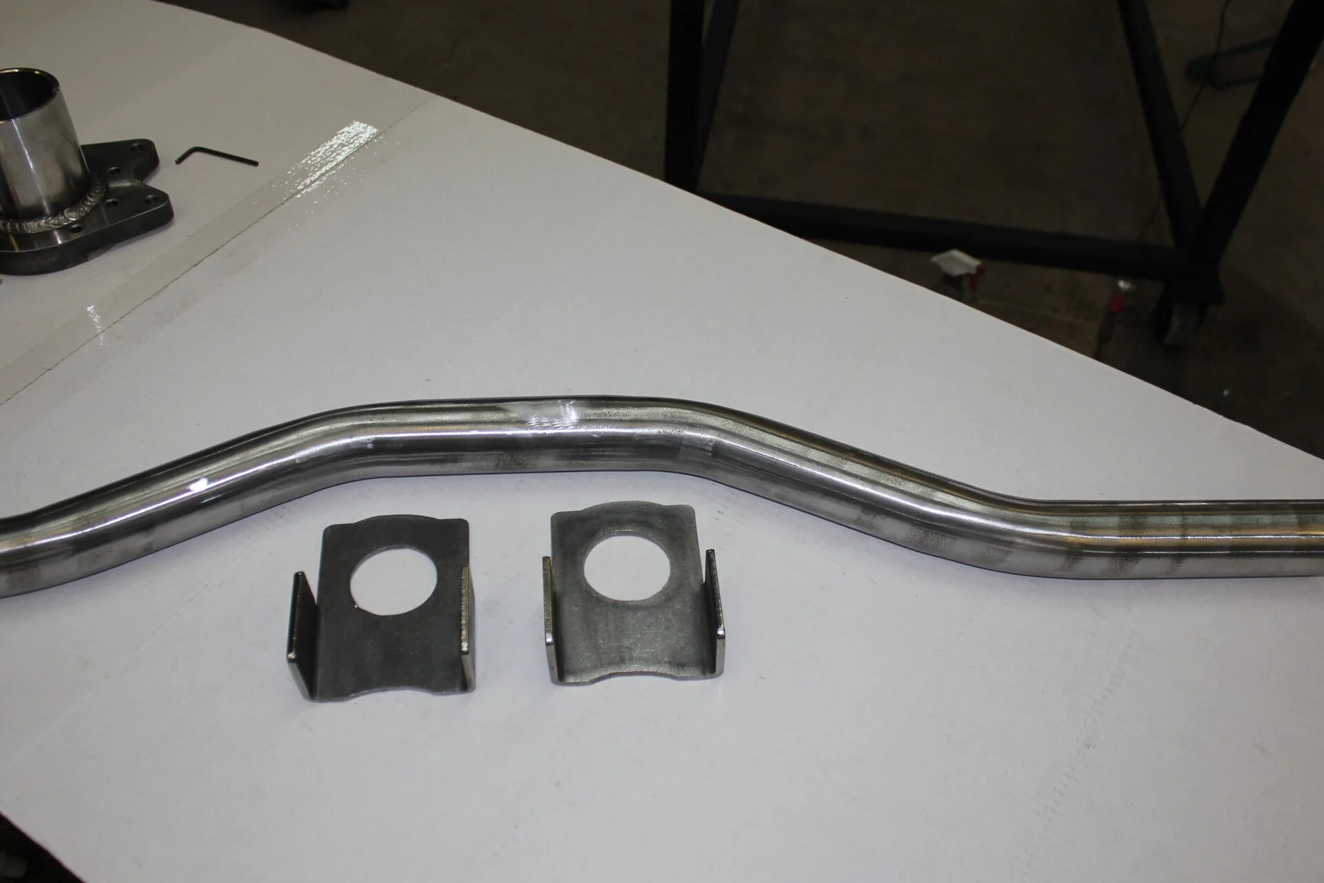

How do you cut the notch?
I would not recommend notching it. Cut and turn if you can.
Otherwise you chop a chunk out with a sawzall and cutoff wheel
the most intuitive place to move the toque tube. We just bend a new one

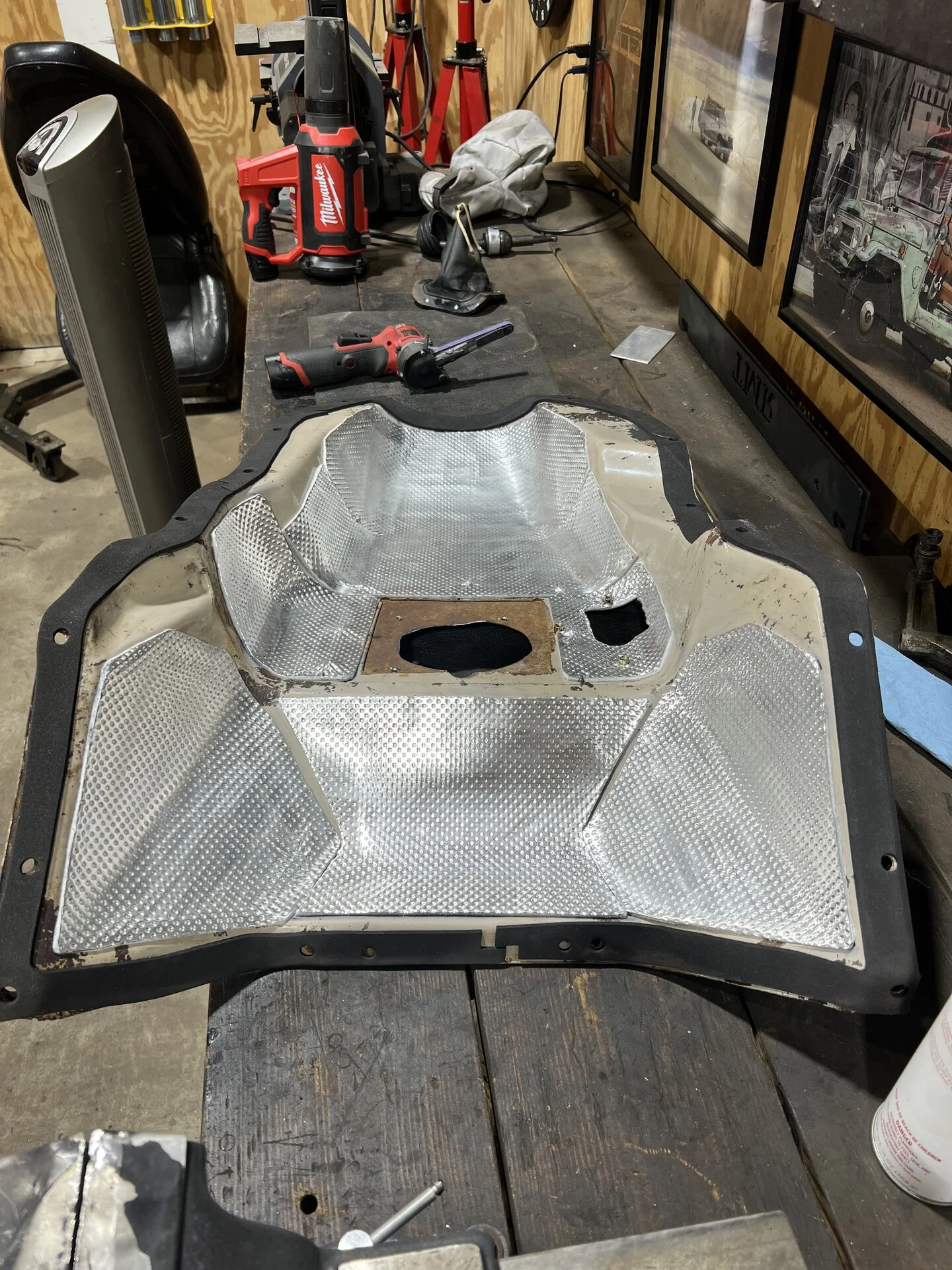

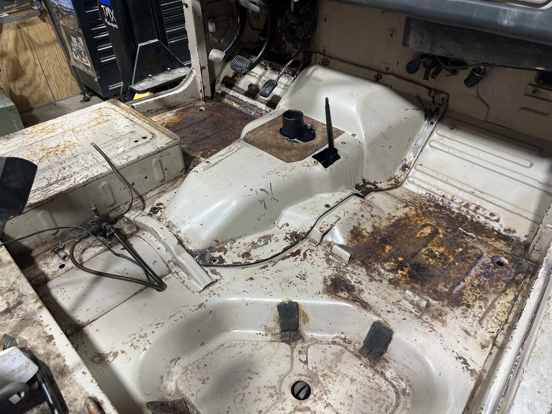

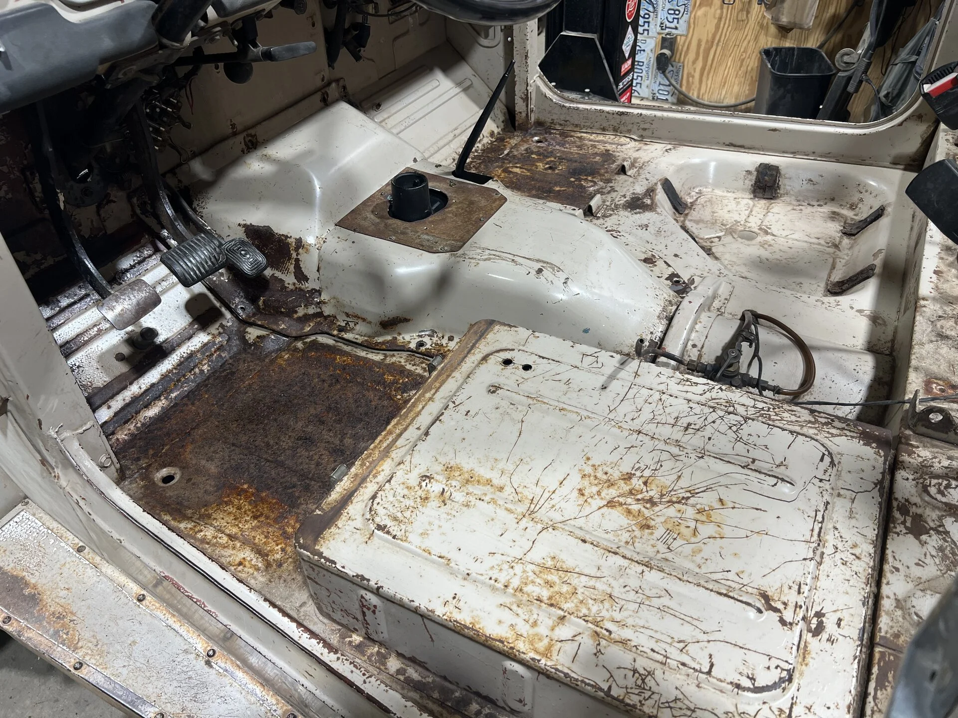

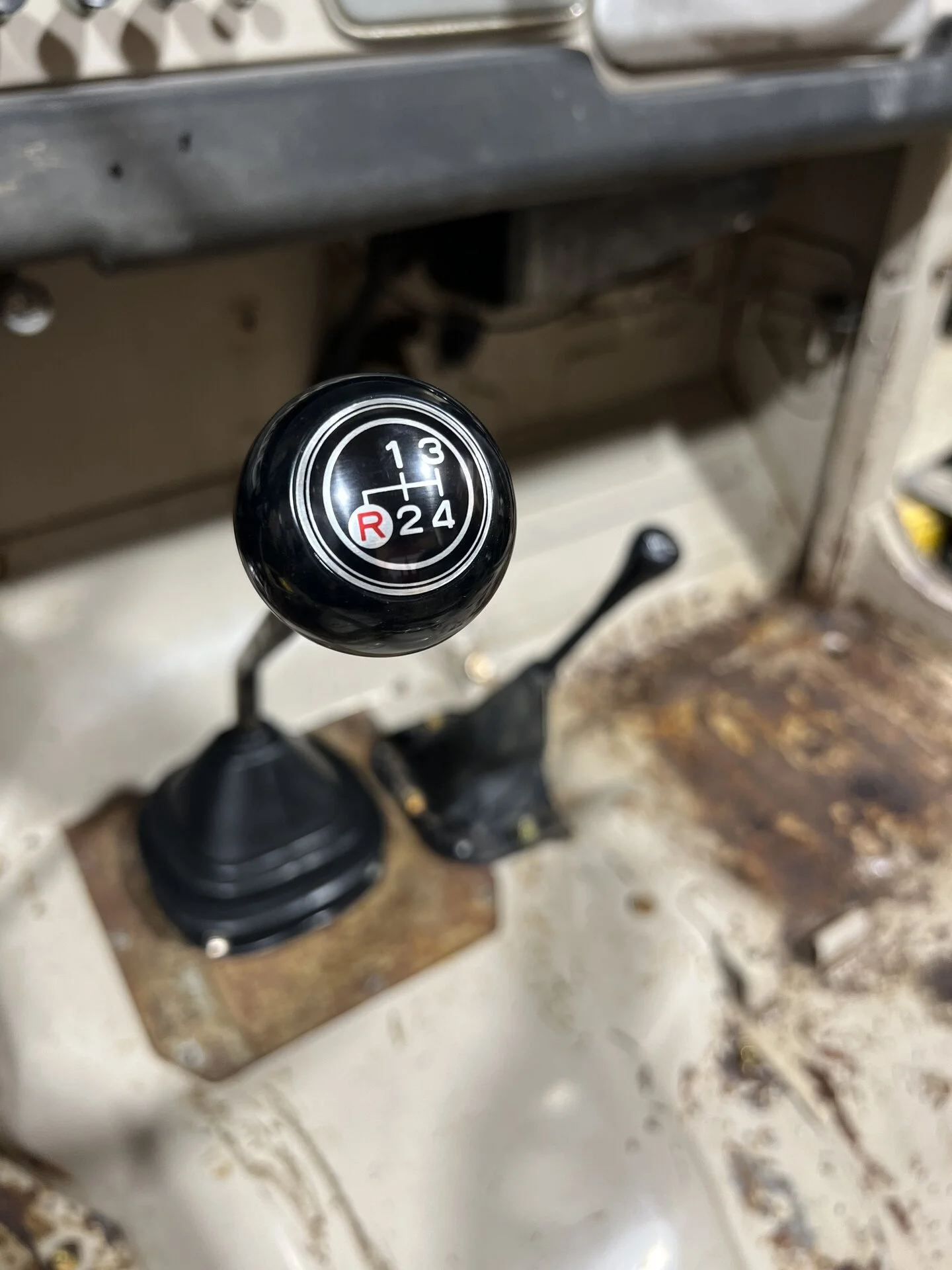

This is quite time consuming cutting all of the new holes out and adding rivnuts for the shifter boots. About to add some heat shield to it and call it done.
Floor was scrubbed with simple orange and then I added some rust converter to the rusted floors. I’ll end up putting fluid film down before the mats go back in and I’m done working on it
Hey Nolen, nice work. what heat shield are you using in the above pic?
Thanks
I bought a Can Am 6x6 a couple years ago and they have this stuff above the motor and under the bed. It gets hammered with mud and you can pressure wash it. Seemed like a good way to do the hump. I’ve put it on the 40s since and the hump will be cool to the touch on a hot day.

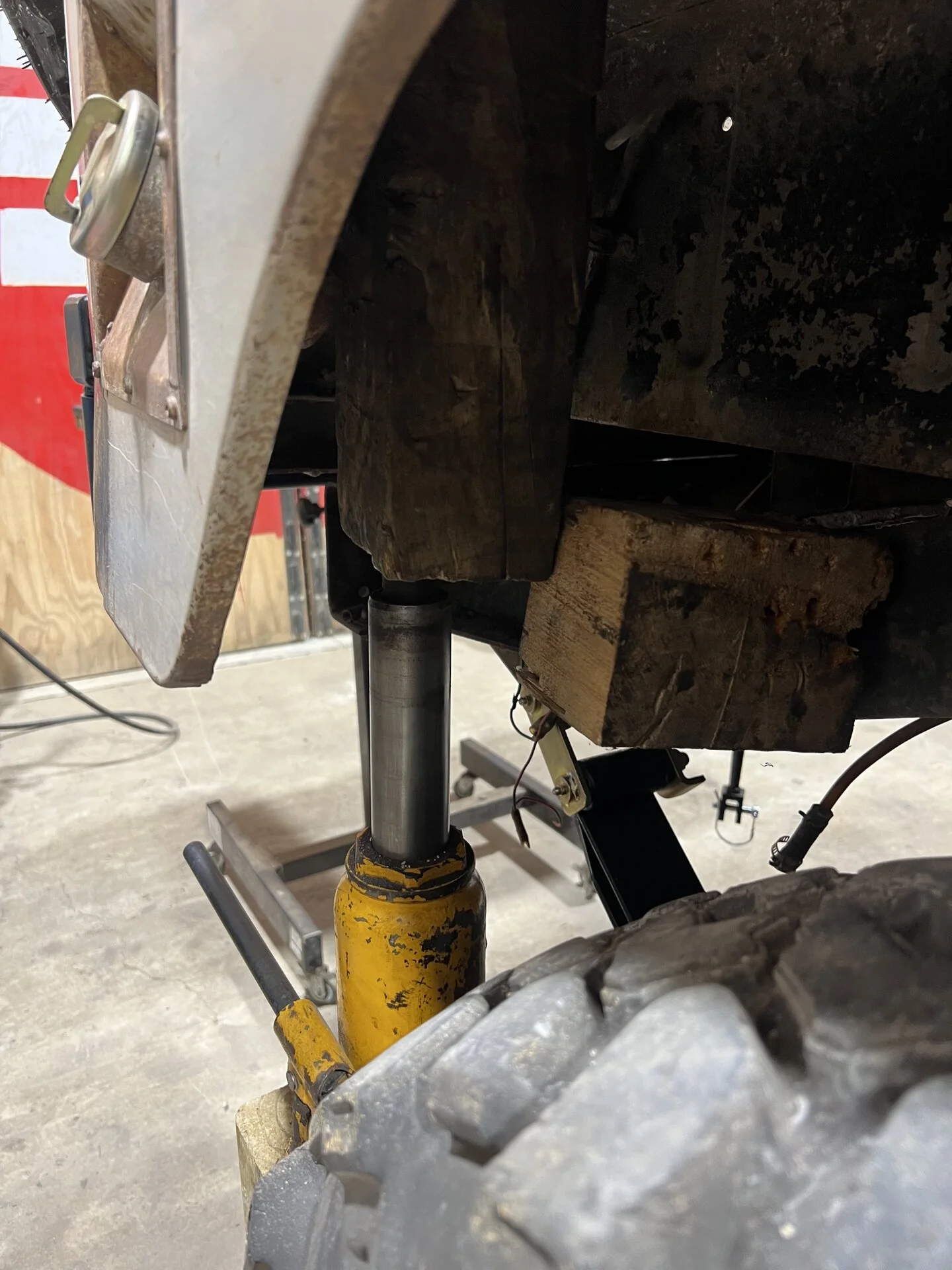

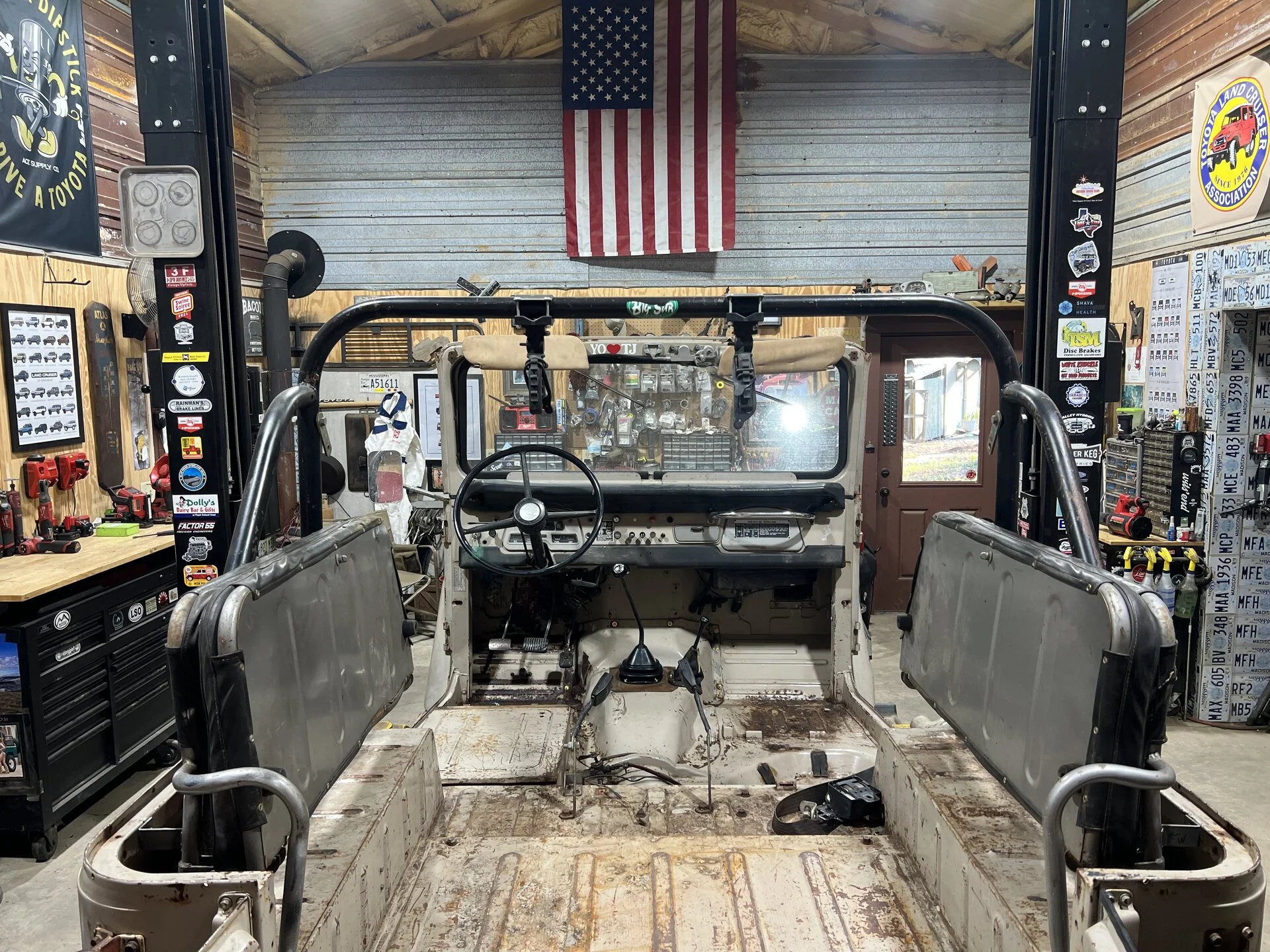

We bent the fenders back in place. I think the owner must have smacked a tree limb with the rollbar while the windshield was down. It pushed the whole rollbar back and down into the fenders.
We jacked it up pretty good on both sides and bent the fenders back up

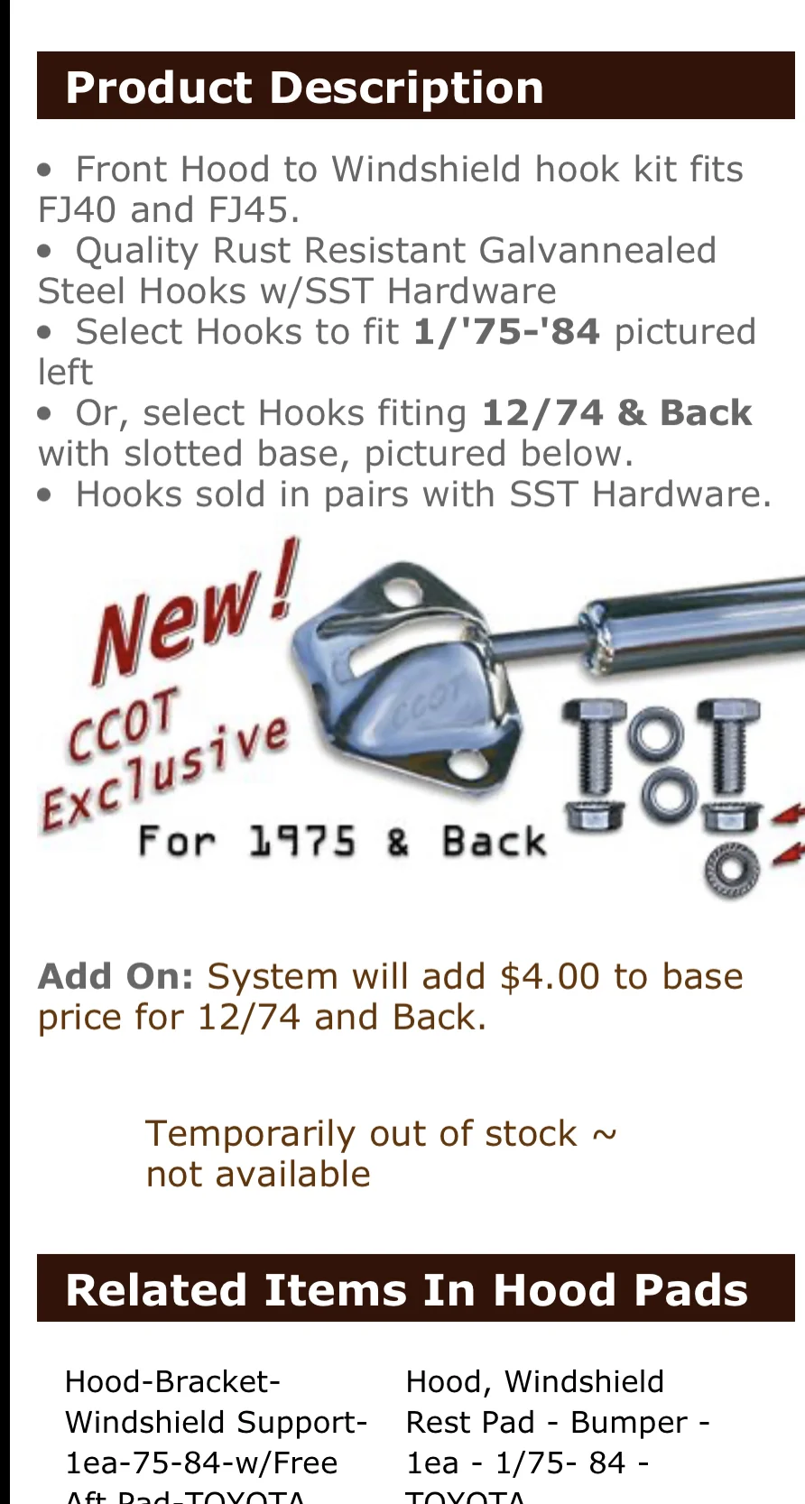

It’s weird no one but CCOT sells the proper windshield pins for the early truck. The long groove to make them able to latch to the hood. They are sold out so I made these work by cutting my own grooves

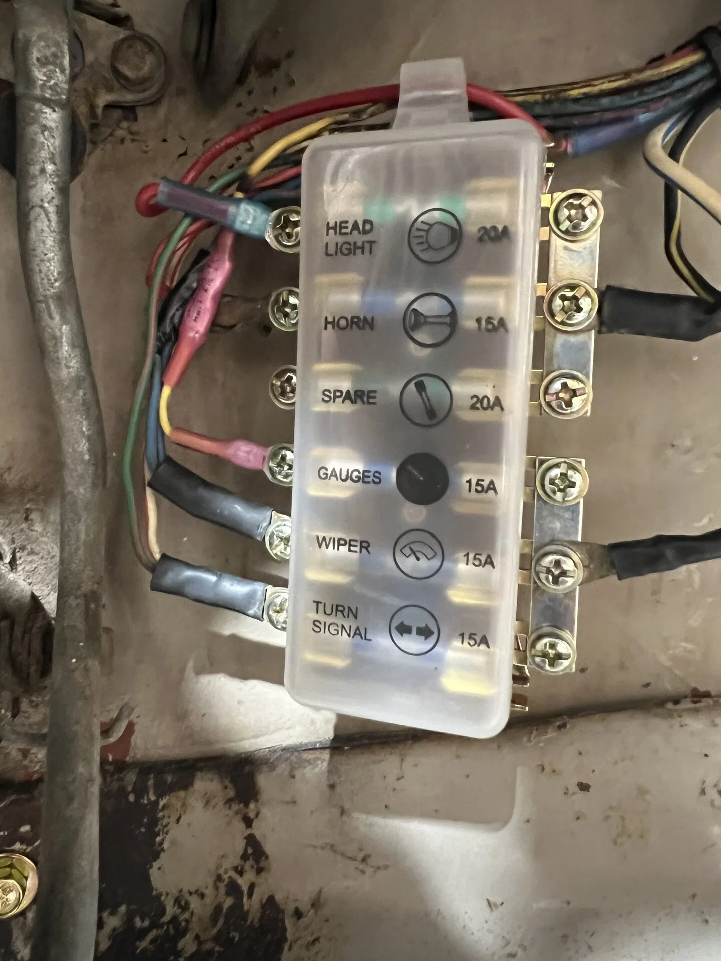

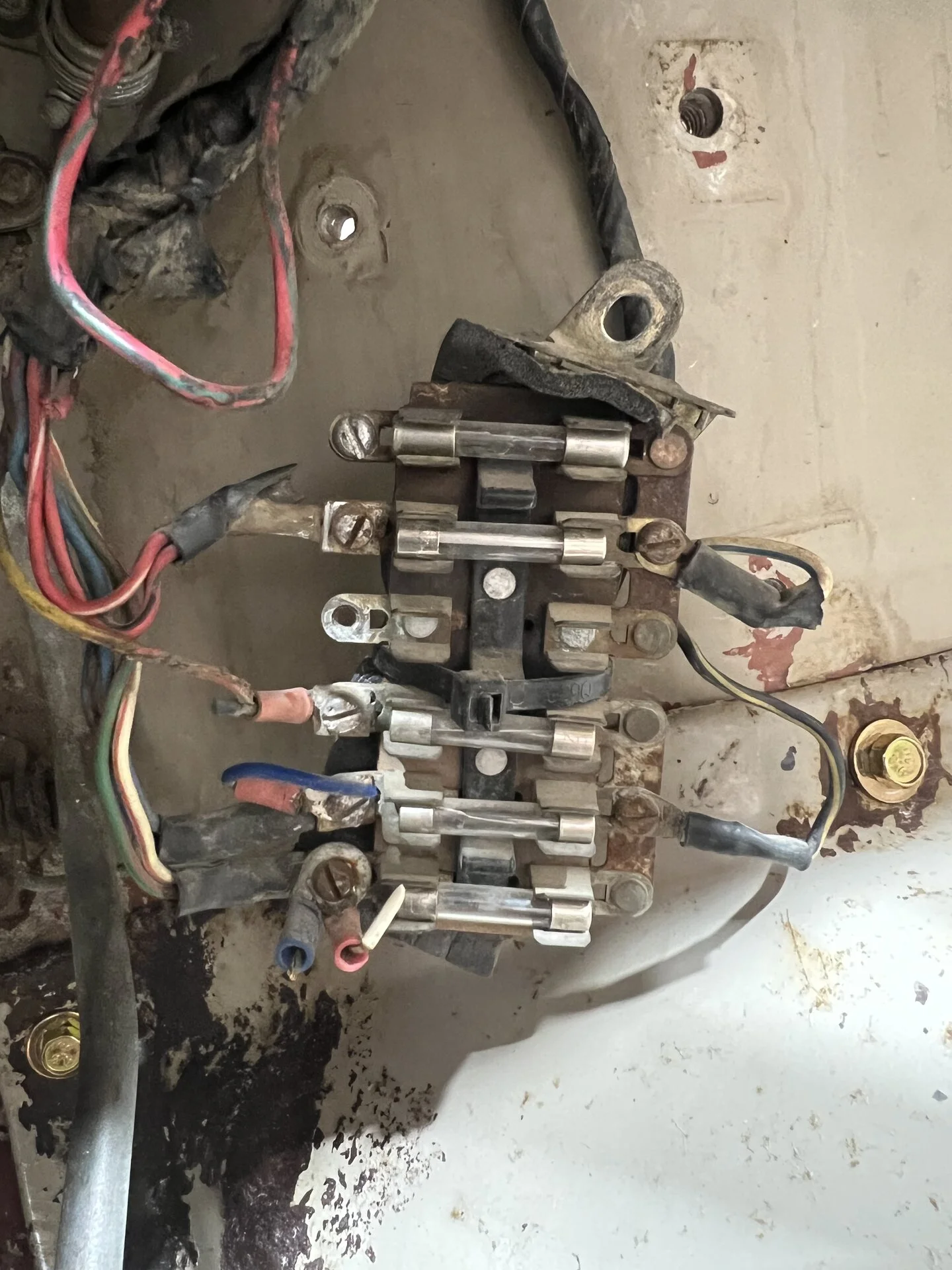

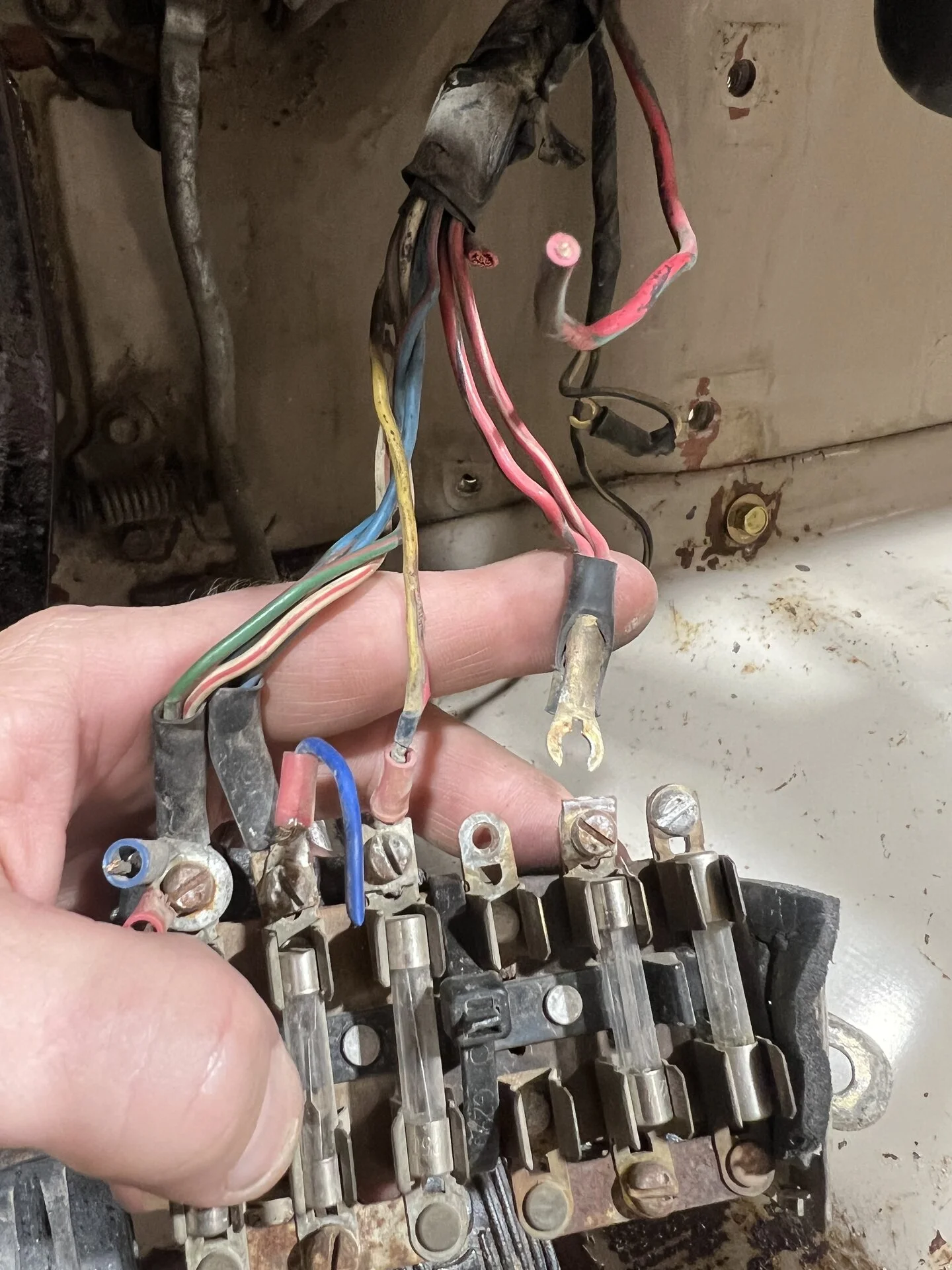

Man. This s*** is a mess.
I think I have this stuff back right but I’m not having much luck making anything work
Before I did anything else I added a Coolerman Fusable link.
Bye the time I took a lunch break I have a working starter.
Nothing else.
Fun times.
