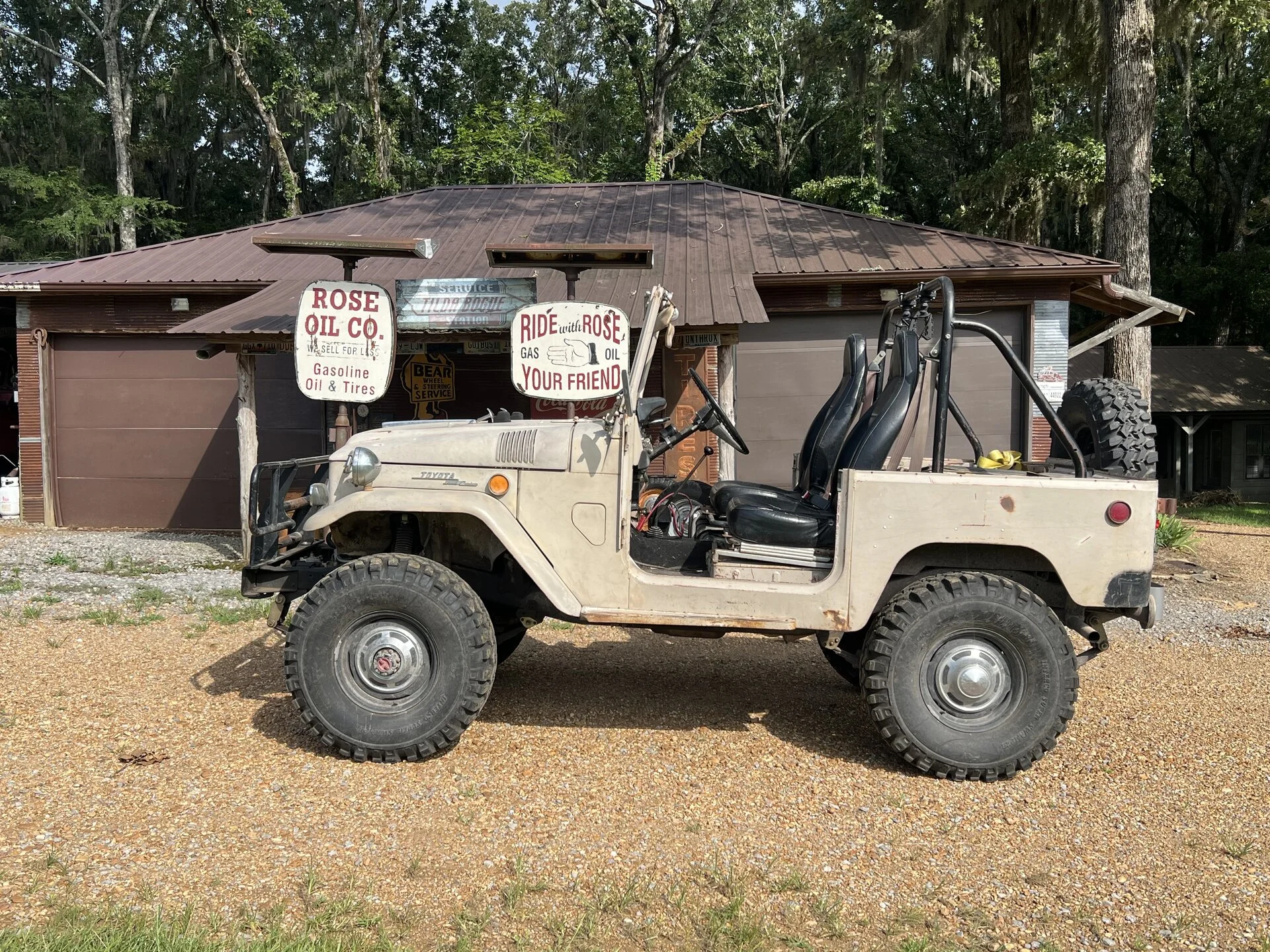

This 1969 FJ40 has had a good hard life. It’s been with its current owner around 20 years living in and around the Texas hill country.
The owner contacted me about getting it safe to drive around his neighborhood and town instead of it being relegated to ranch life as it has been for the last few years.

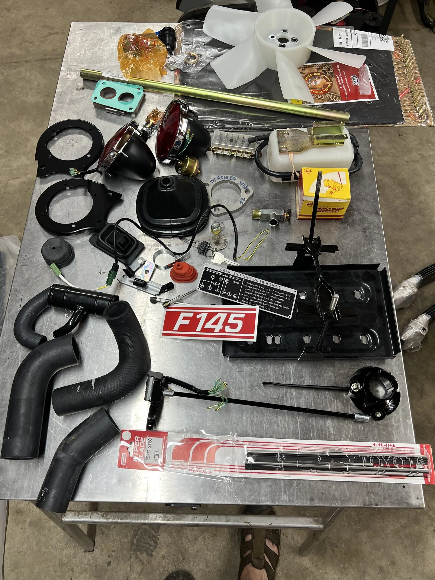

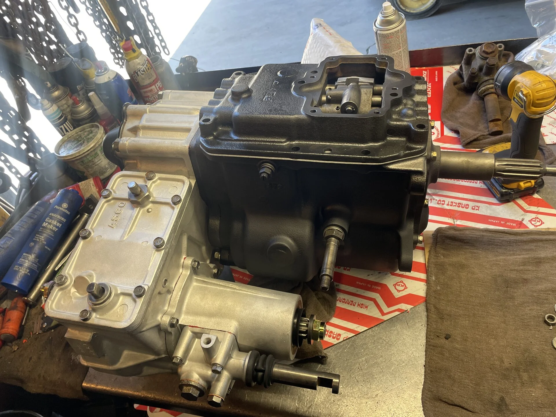

I’ve been finishing up a 40 and a 60 that I have had going since April. Last week I delivered “Rosie” but before it left I sat down and ordered about $7000 in parts for this one. Combine that with the 4 speed I purchased and had rebuilt from @orangefj45, I’ve got a pretty good pile of parts ready to go on this one

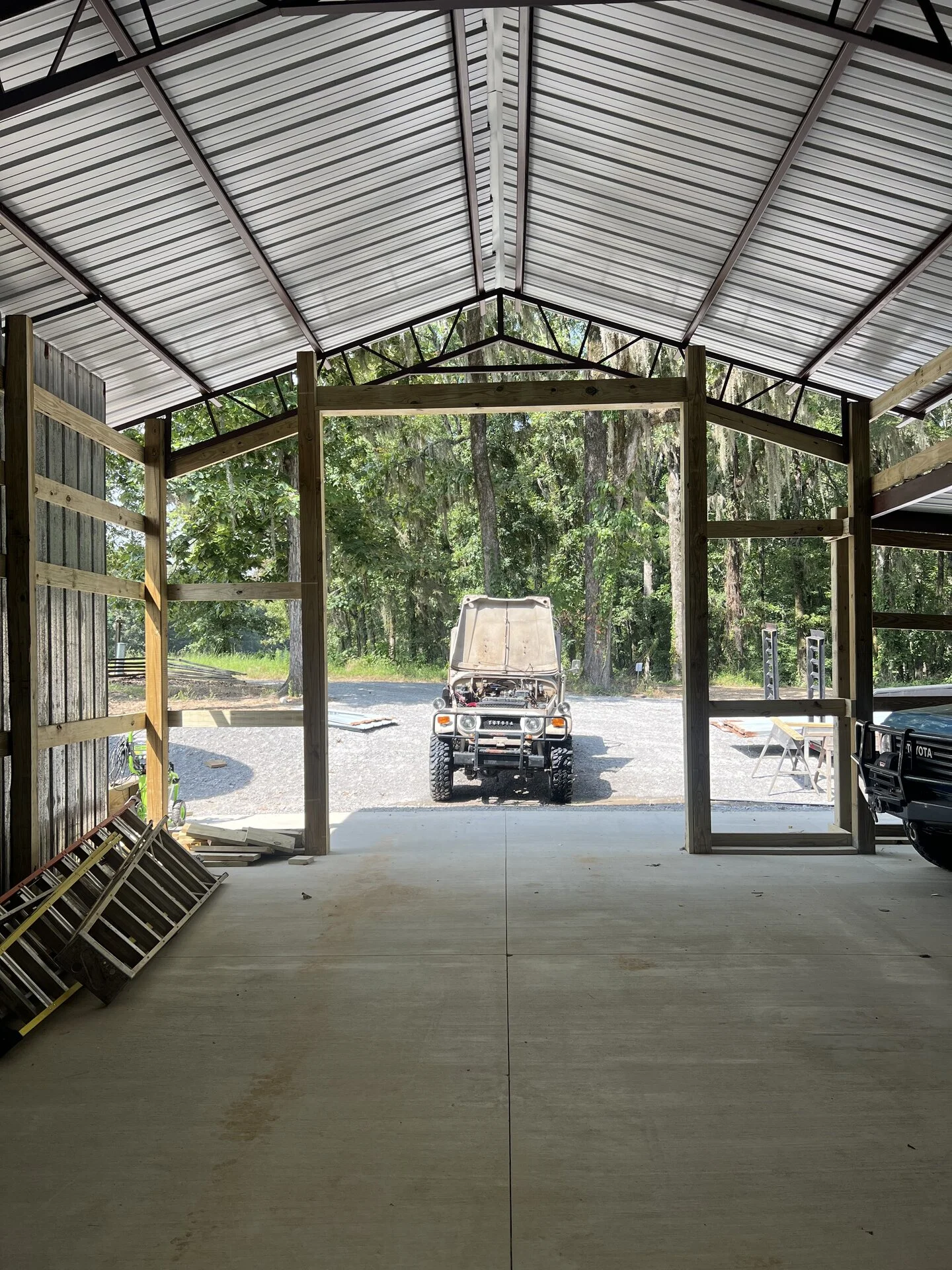

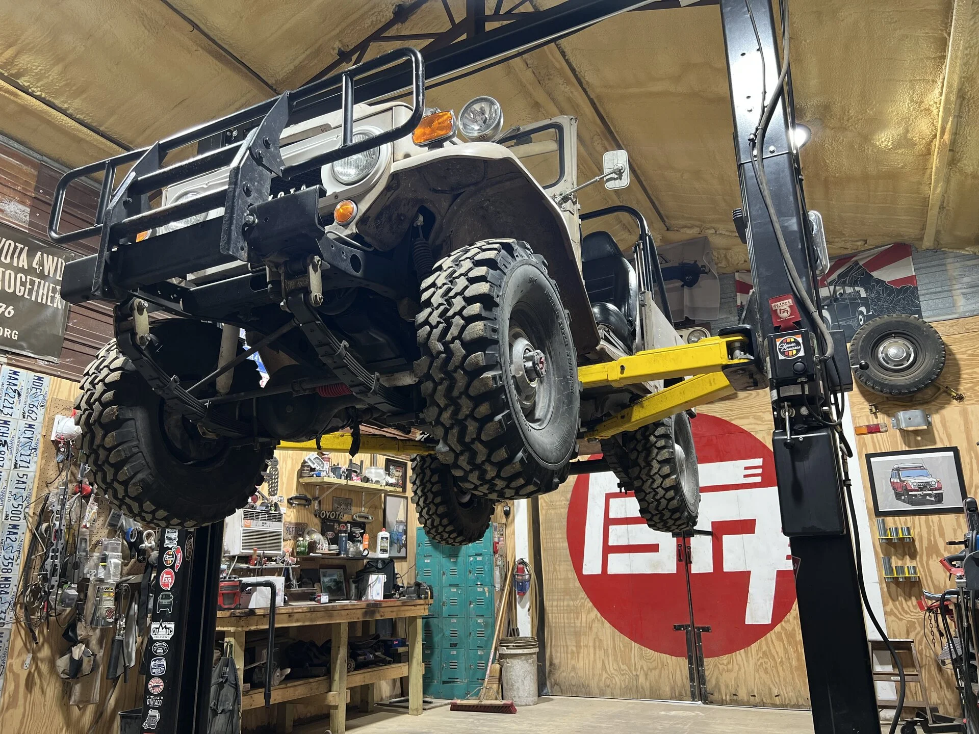

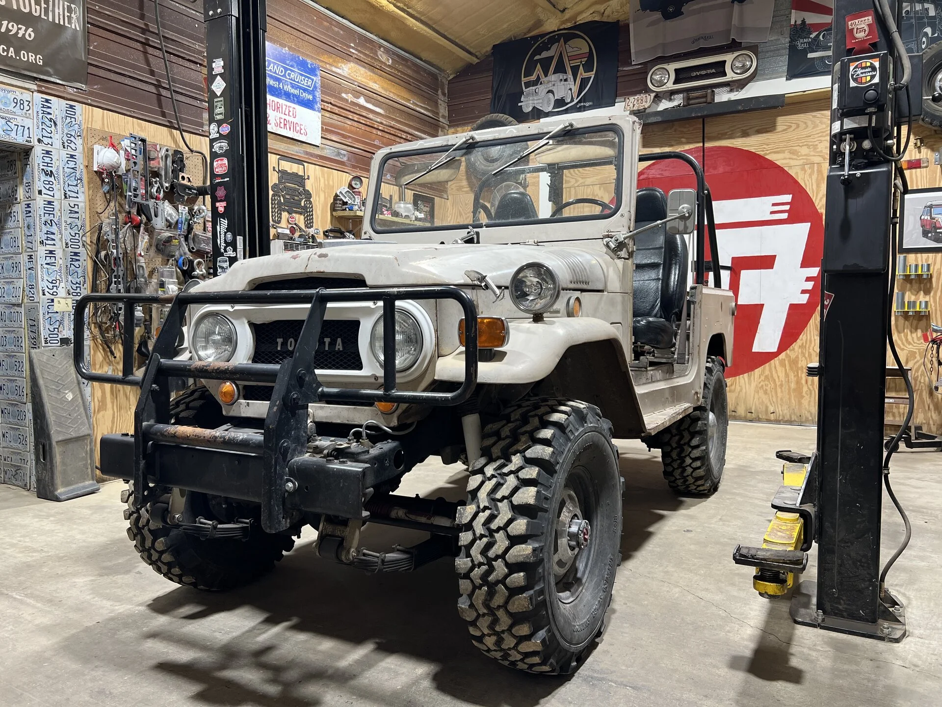

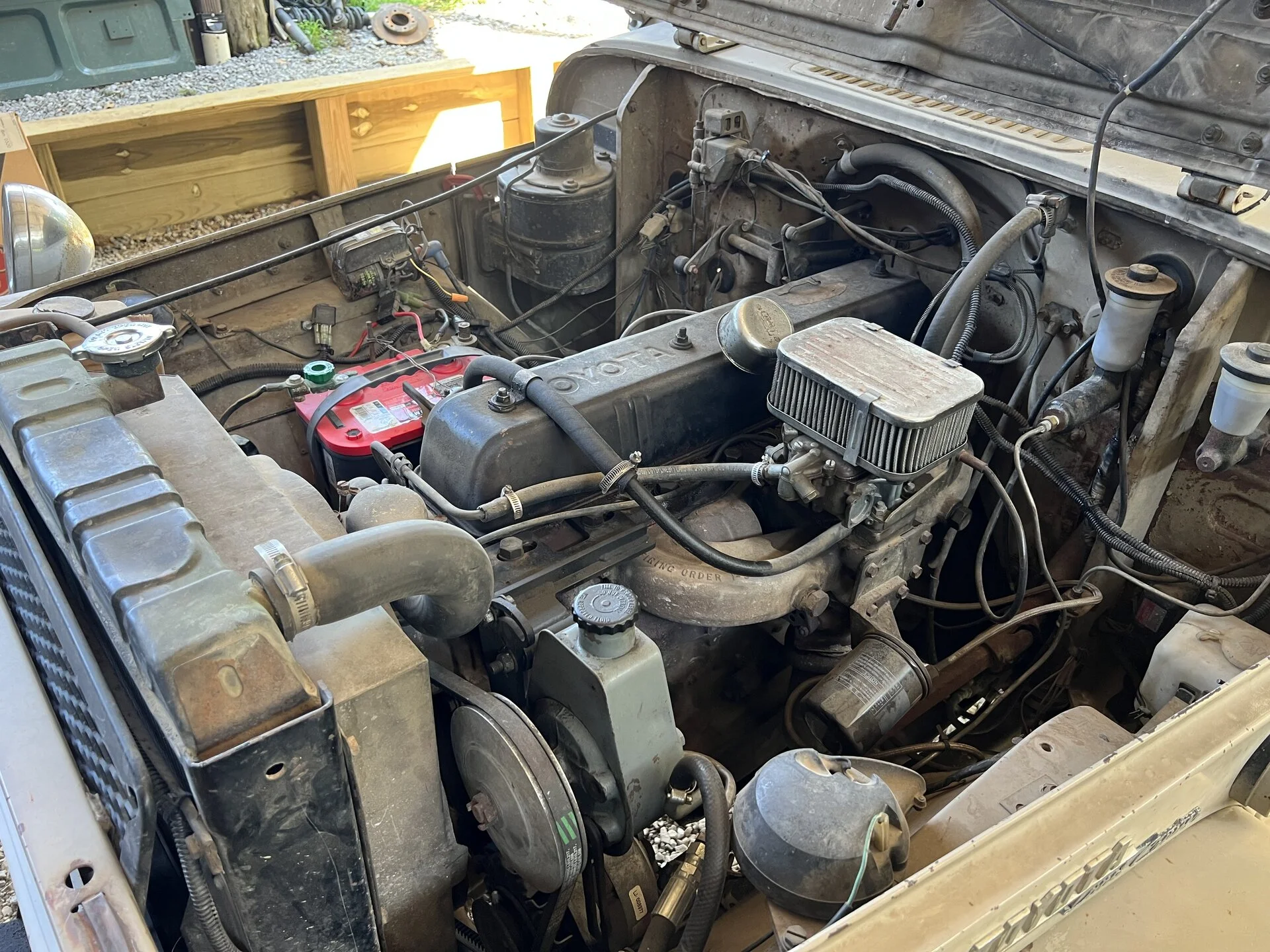

Today I finally got settled in from being gone a week and dove in. I starred at this for about 20 minutes then took a final before picture before rolling it back out of the shop

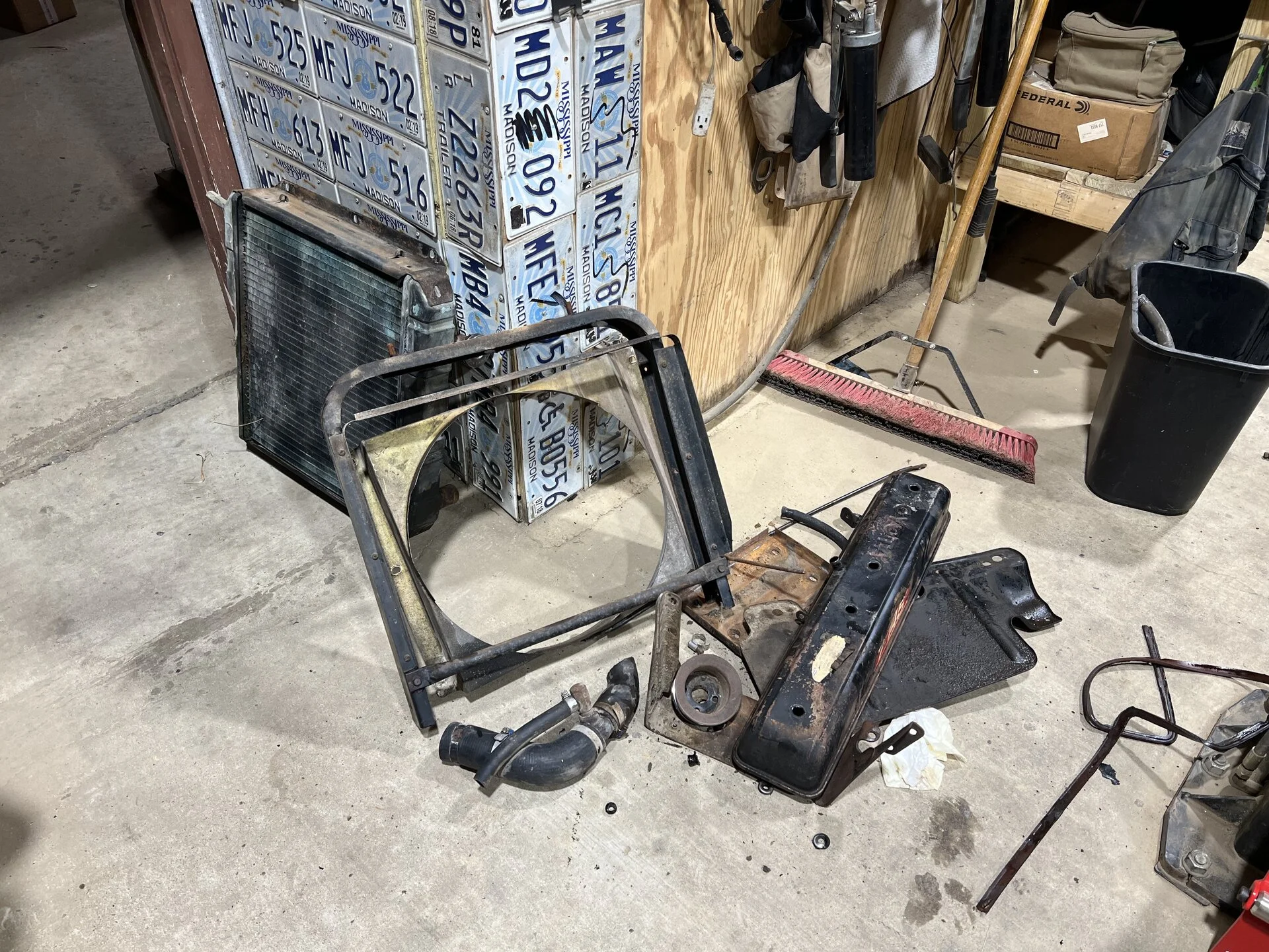

I cut the bottom radiator hose and drained it dry and then pressure washed it as best I could.
Now I’m busy cutting out all the bad wiring and skinning this F back. The wiring is absolutely terrible. Scary. Nothing worked. No blinkers. No lights at all. This one is going to be fun.

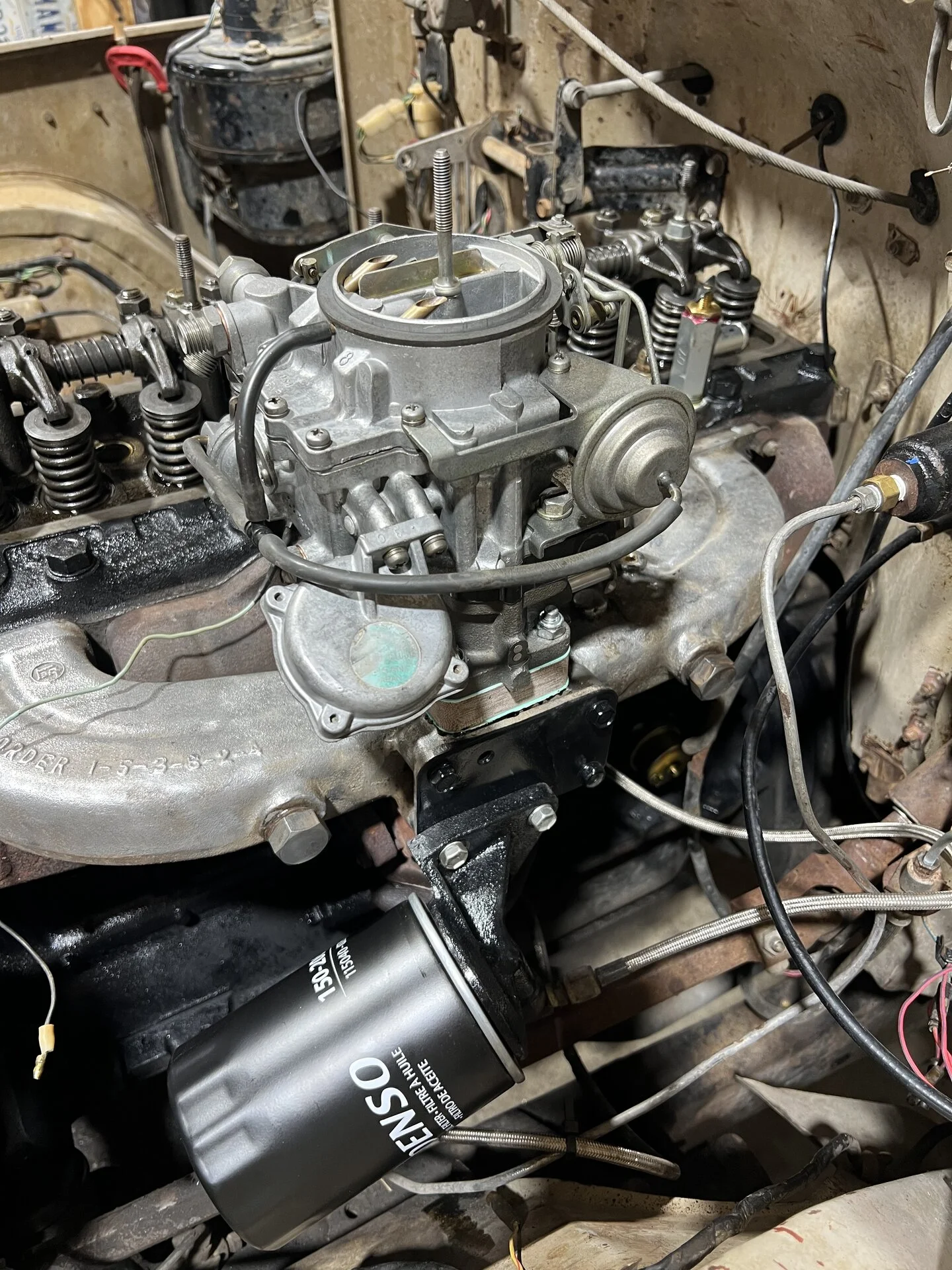

This one is getting a JimC carb. Dobinsons of course. 4Plus of course. Owner does not want it to change much except in the reliability and drivability department.

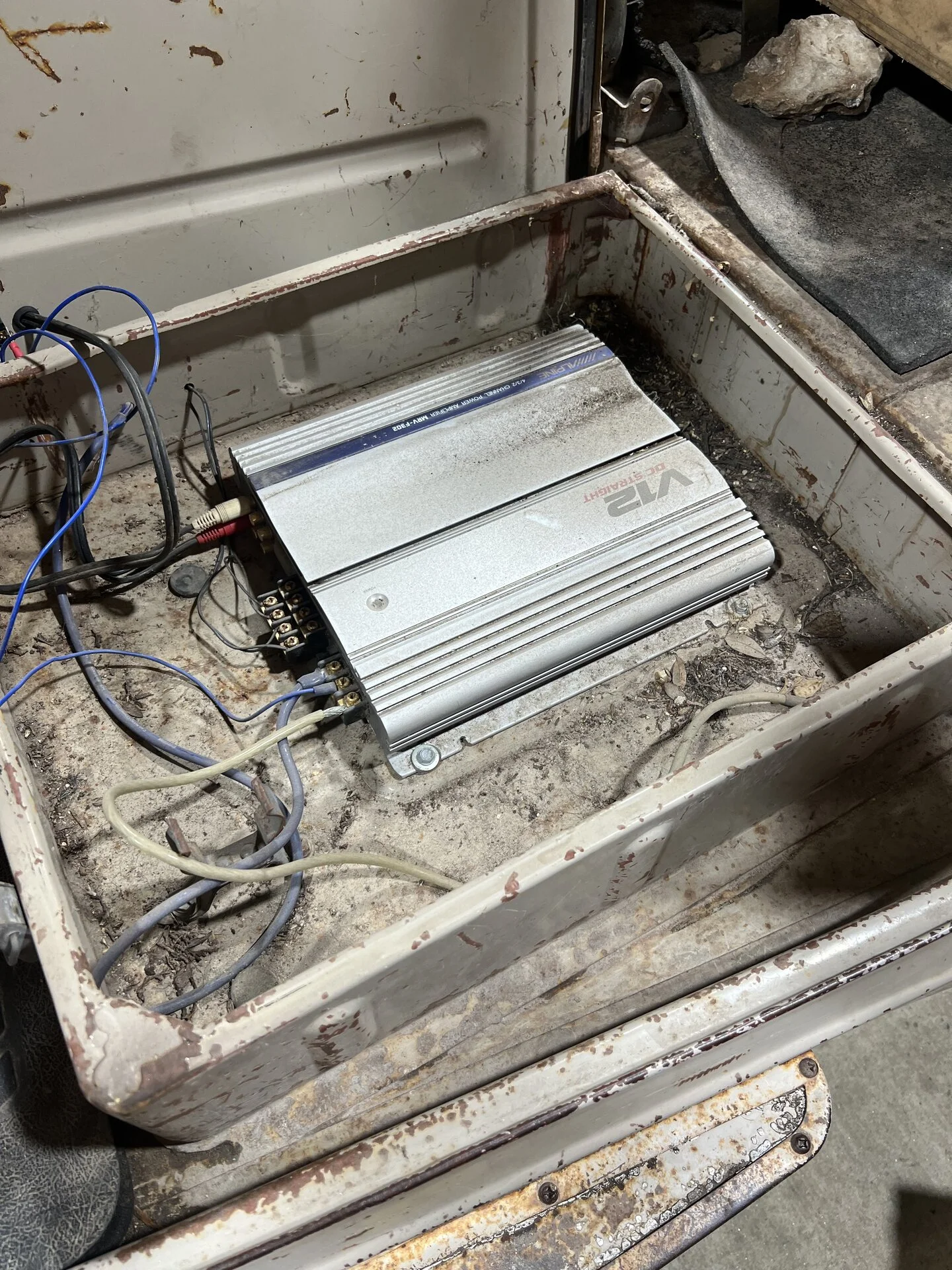

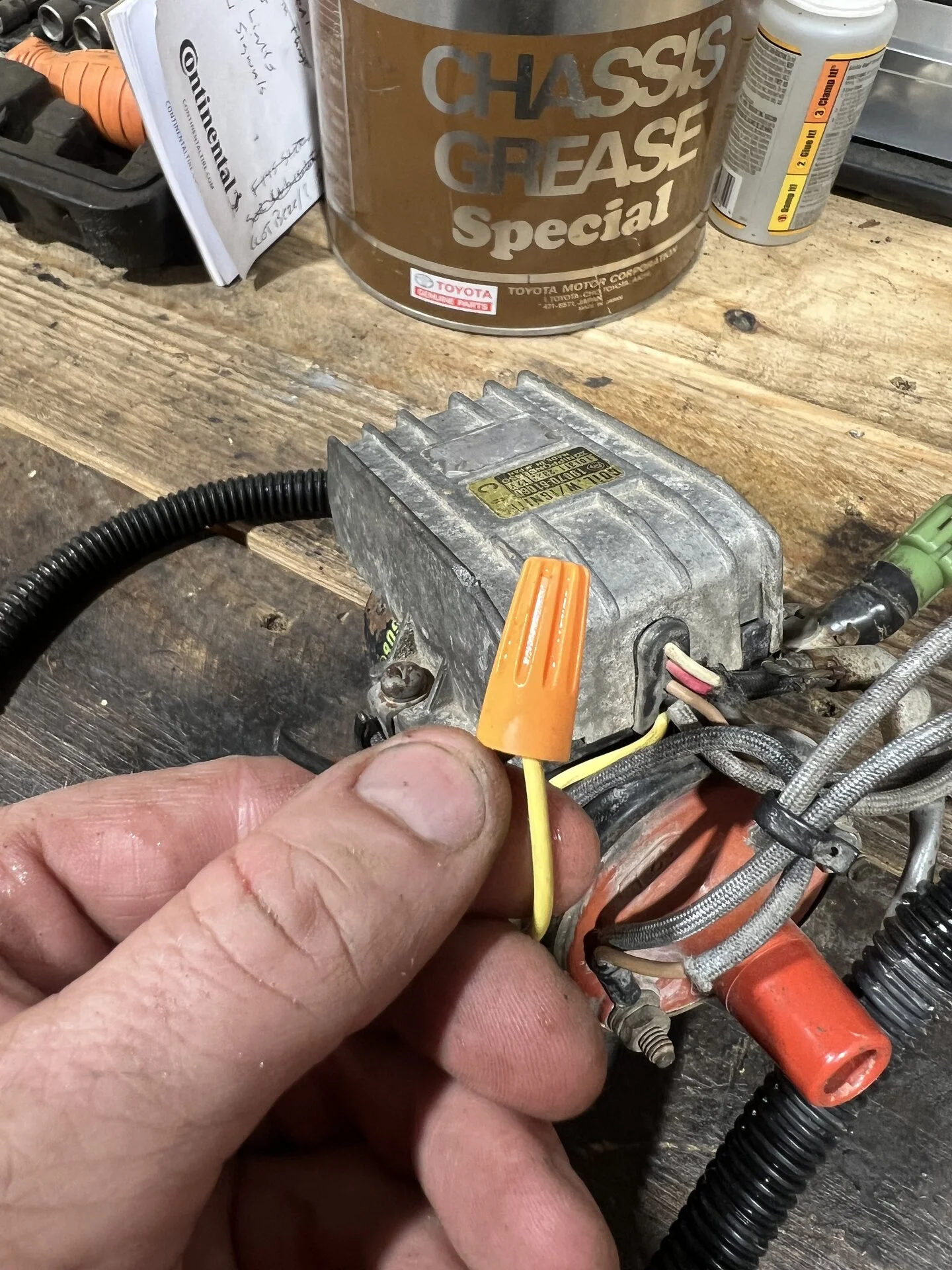

Check this damn thing I found chasing a monster purple wire ……
Seat heater.

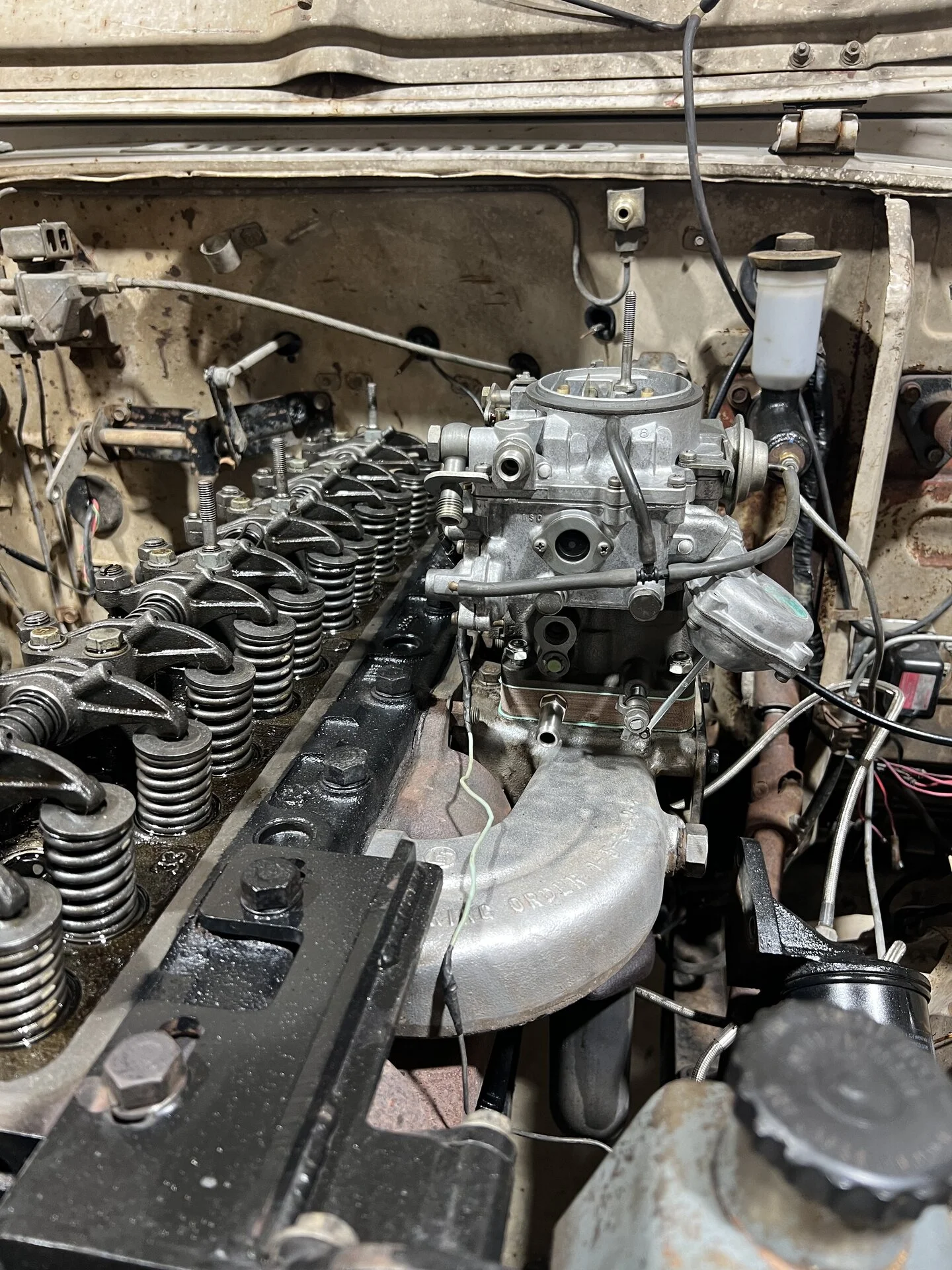

Digging in. Basically going to replace everything that needs replacing.
Canned Ham Saginaw pump looks good. Alternator is good.
Funny thing also, this thing was running the stock OEM style (looks pretty new) fuel pump versus the crappy electric pump most people run with a Weber 38/38. I did not really drive it enough to tell but if that’s the way it was set up for the 8000 mile trip plus whatever has happened since then that’s pretty interesting to me. Next to the square air filter those crappy fuel pumps make up 96% of my Weber hate
Pile building for PowderKeg

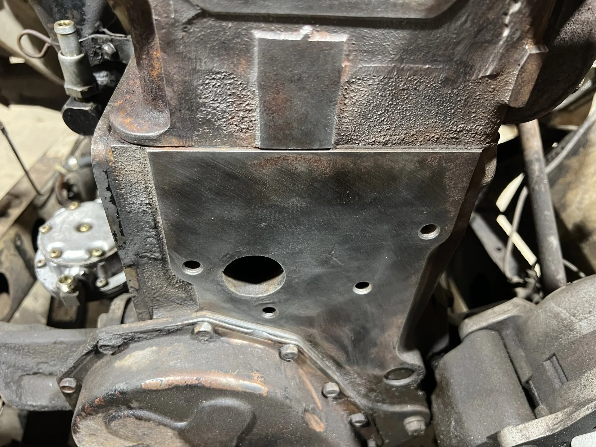

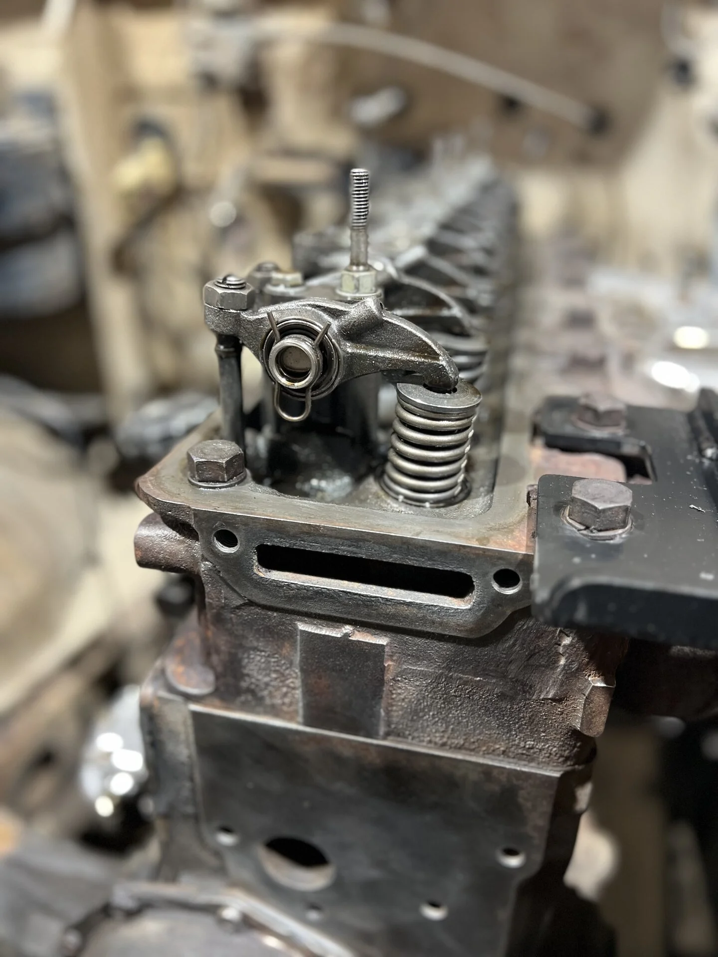

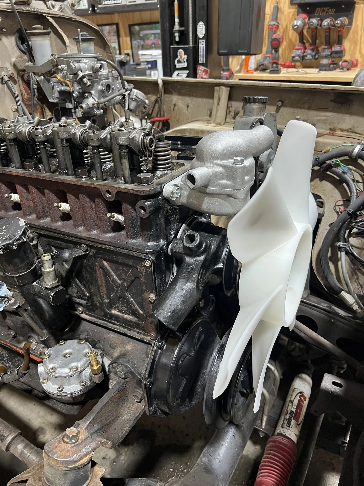

The top end was rebuilt at some point. It’s in great shape. Oiling is nice and even.

Couple things I have to work out. This JimC carb has a return. Going to have to T in a return in the main tank.
Gotta figure out a throttle cable bracket as well. No linkage.
Air cleaner clearance since it’s got a Saginaw pump in the way

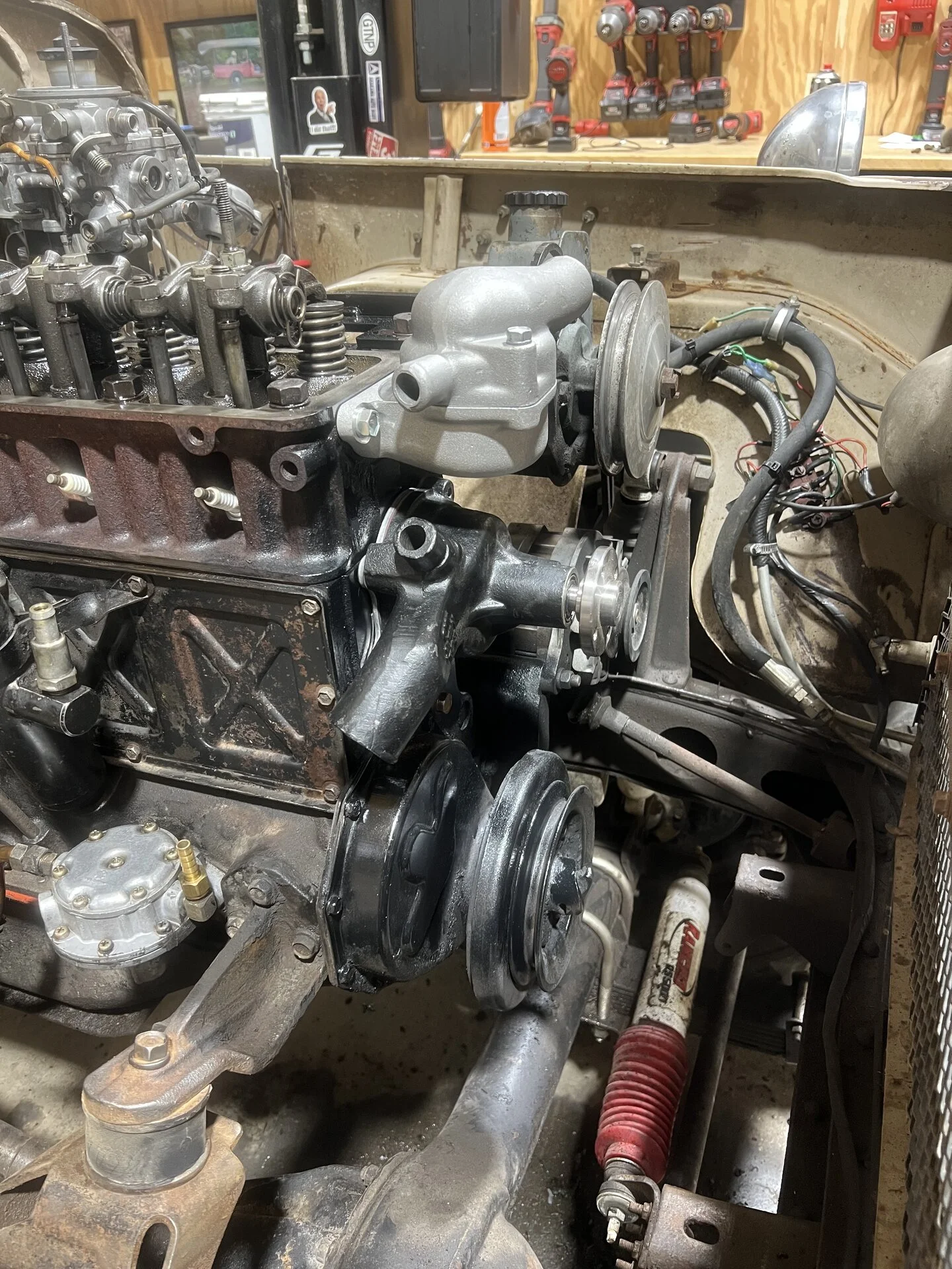

New water pump. OEM thermostat and new housing.
Plastic fan.

If you run the correct early fuel pump, can't you just put a plug in the carb "return" port? Early 40's had no fuel return line.
