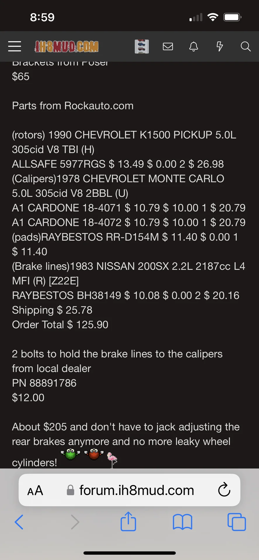

In all the years of fooling with Rear disc brakes I had never bought new pads so I was happy to find the part number in the FAQ as I was insistent to the Auto Zone clerk the donor was a “rear disc brake” from a Monte Carlo but alas. A 78 Monte Carlo had drums. I got it now 🙄

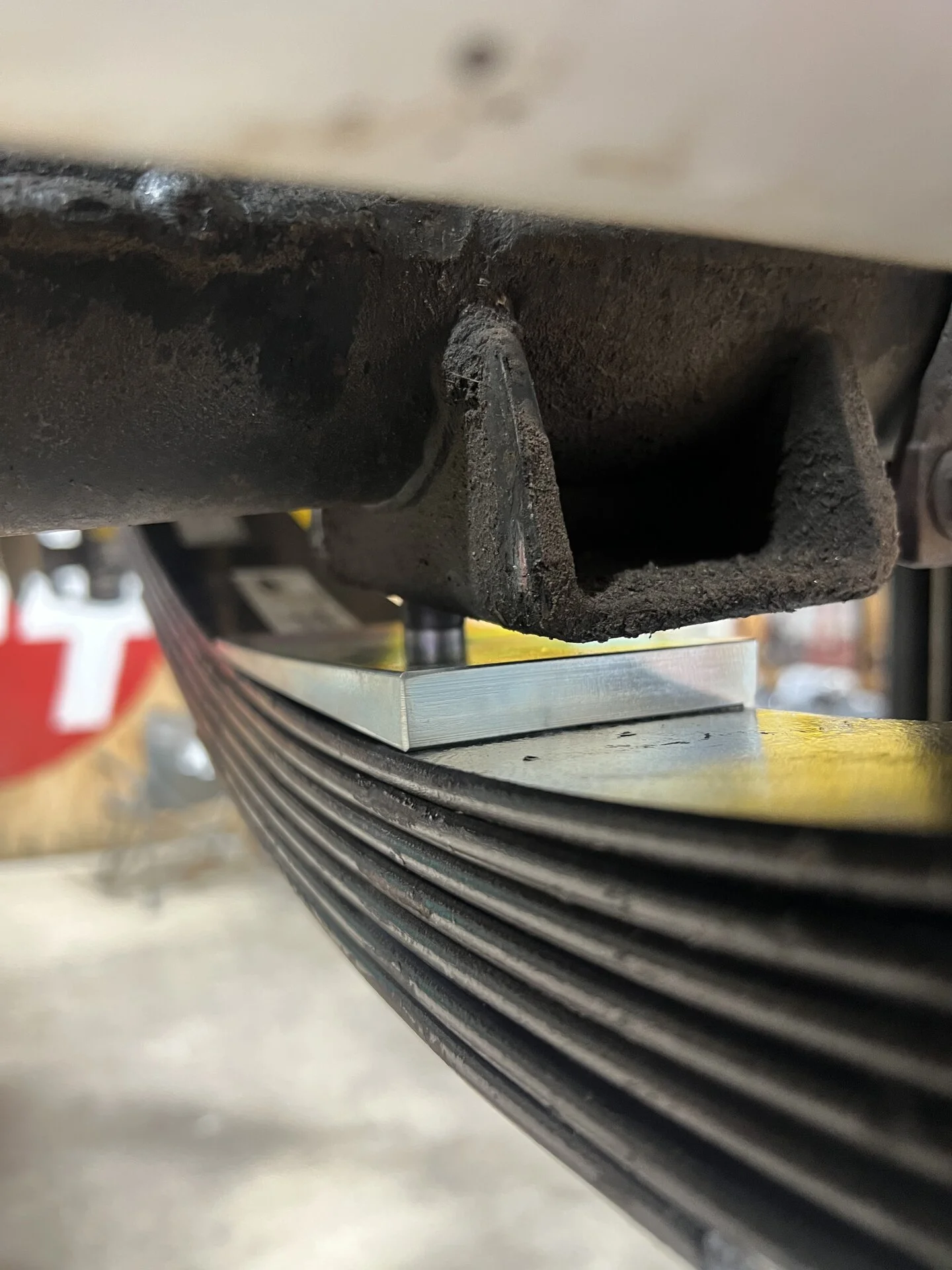

This photo gives you an idea of the difference in the 4” HFS versus the 2.5” Dobinsons

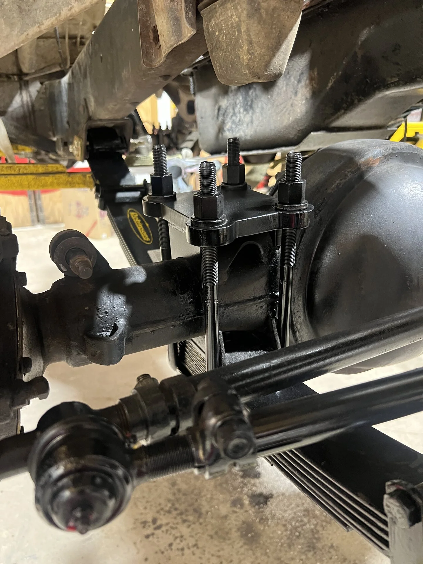

Steel 4* shims and pins via Georg

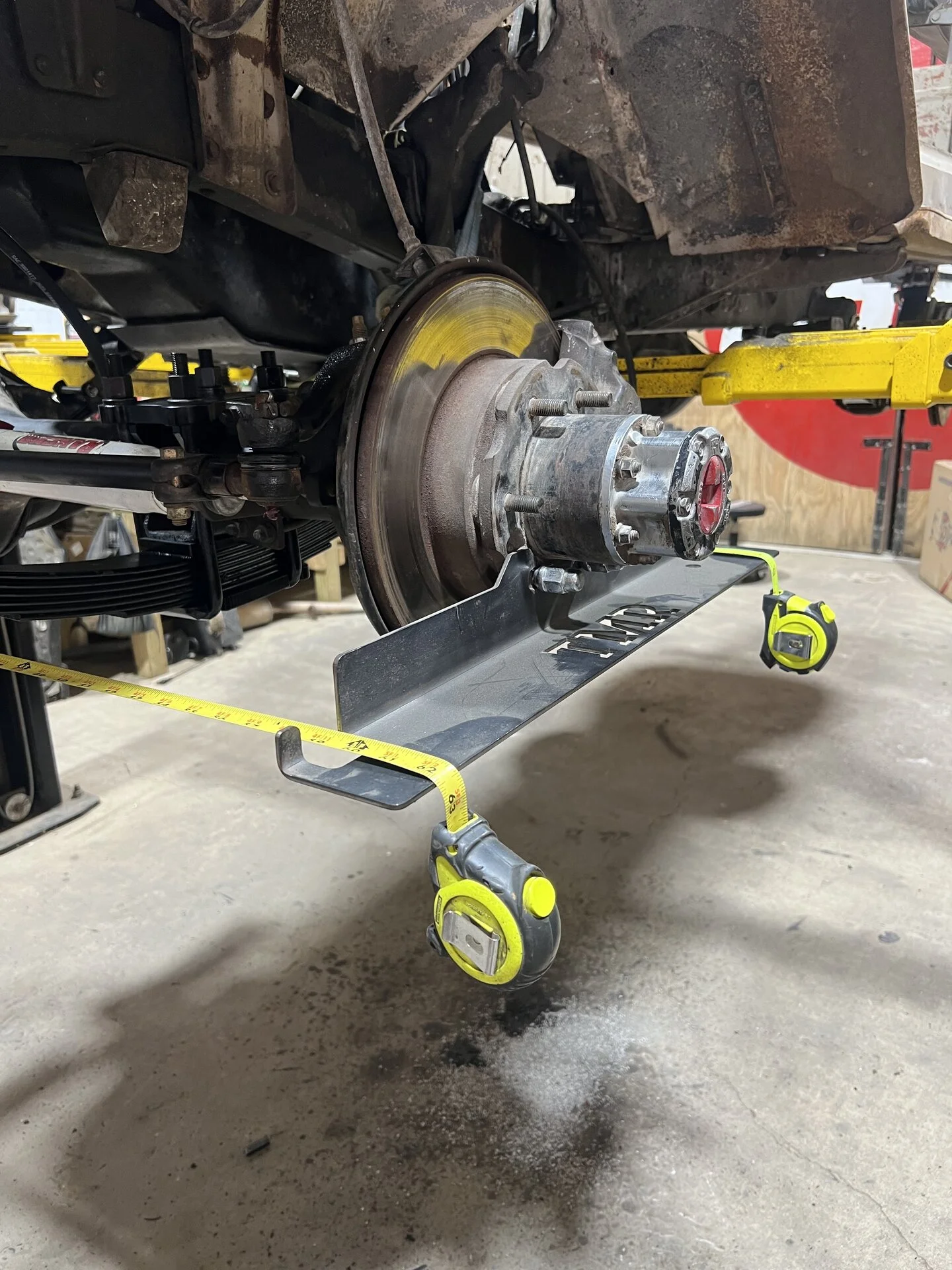

Adjusted the Toe In
Installed the 4Plus flip kit

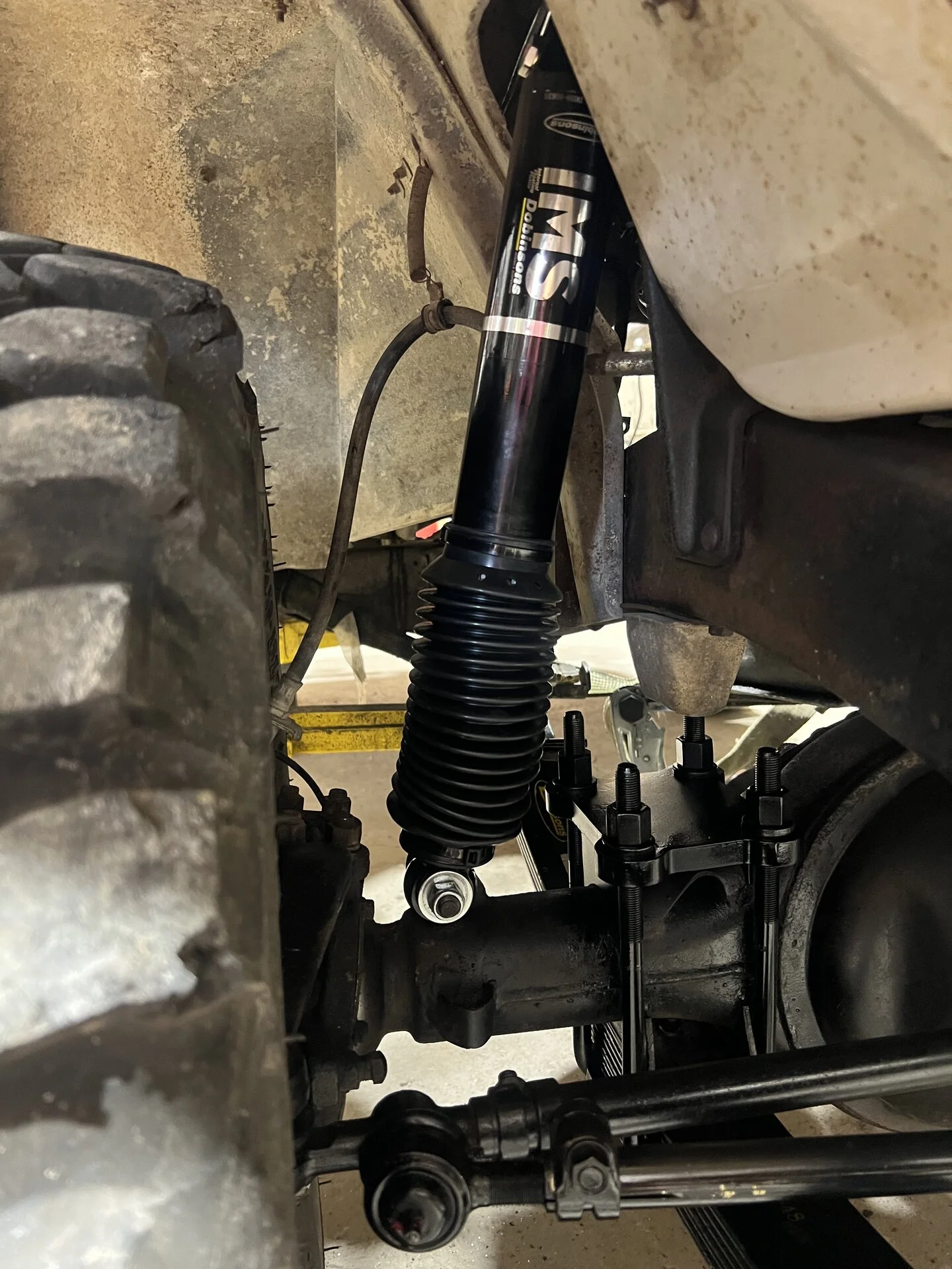

Now to wrestle these IMS shocks in place and put her on all 4 again
IMS shocks installed. Anyone that has used these will tell you they are in a league of their own. Nylock versus Cotters on the pins.

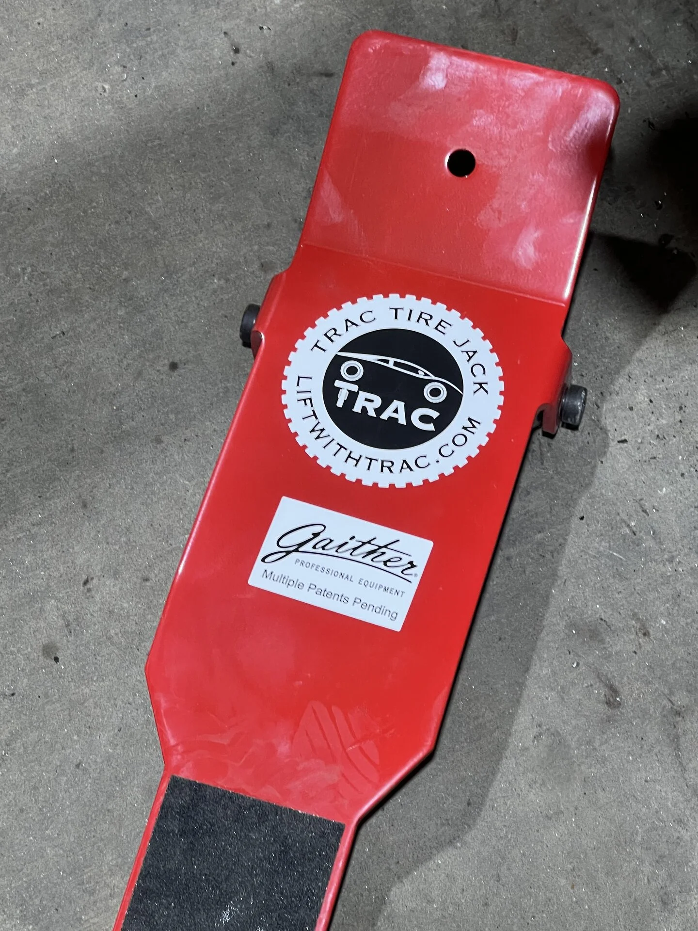

This new toy makes these heavy ass tires manageable for my old ass

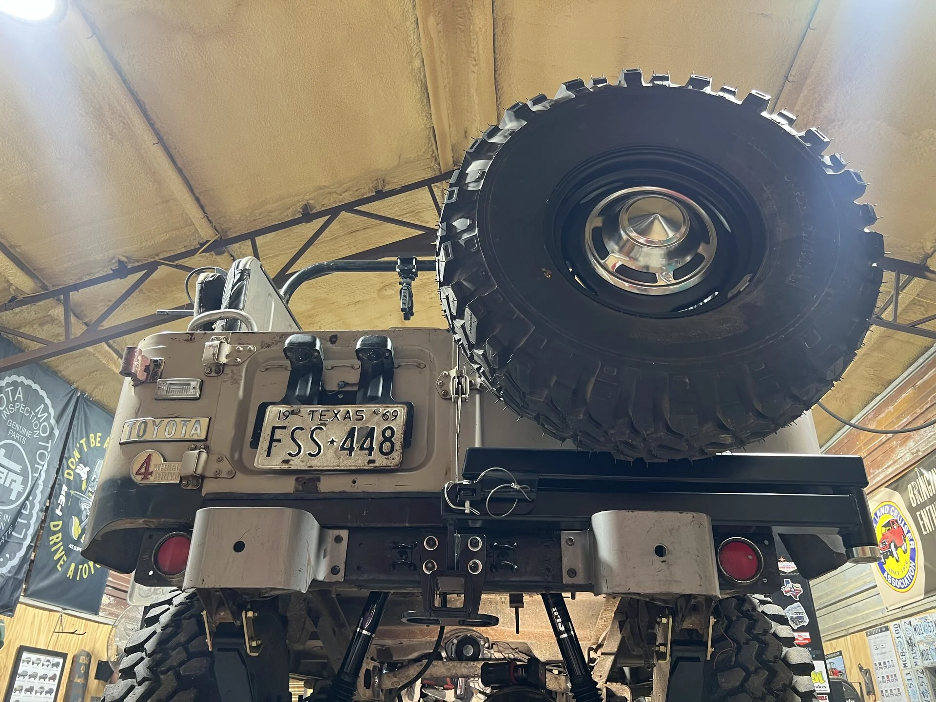

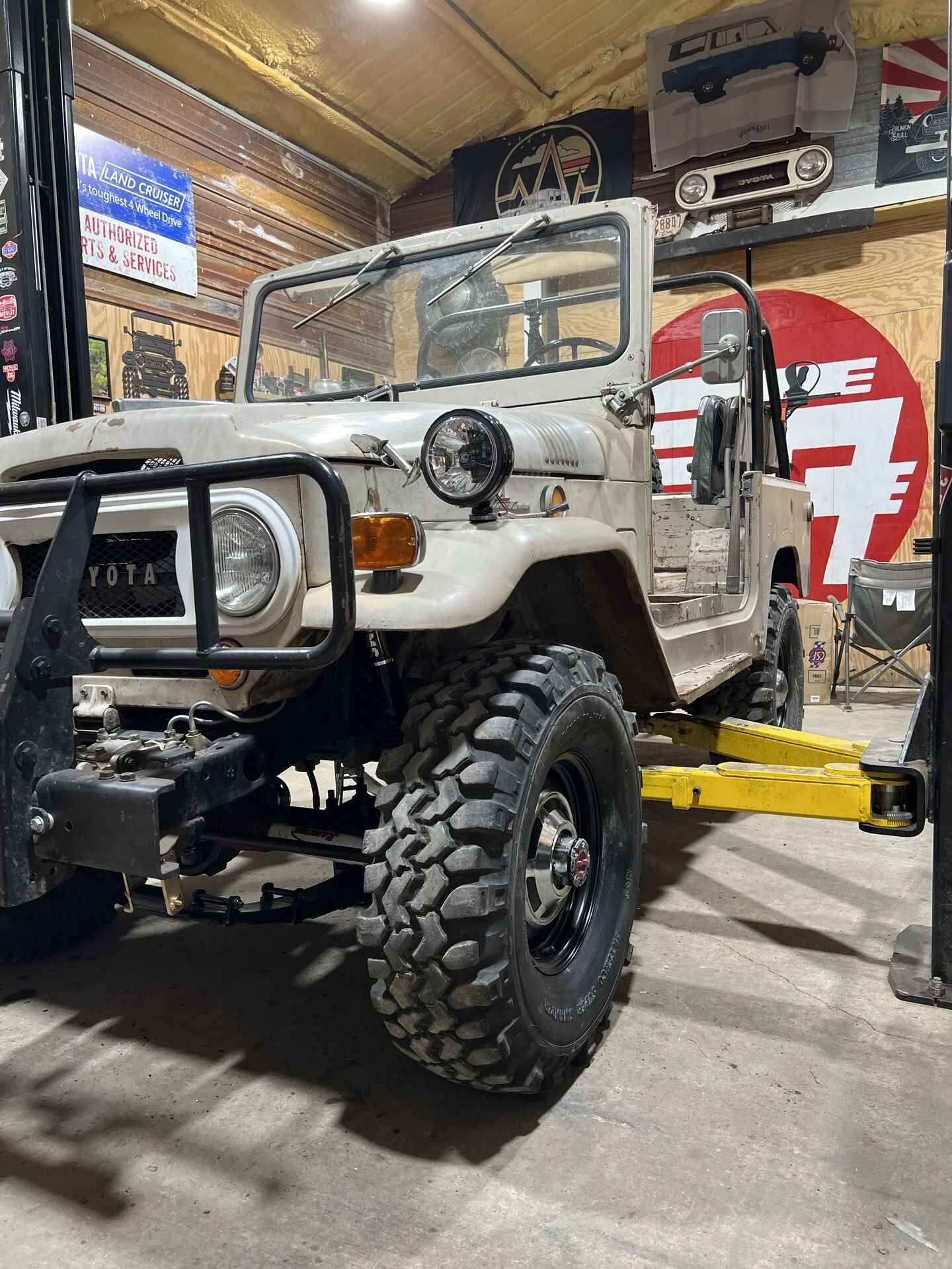

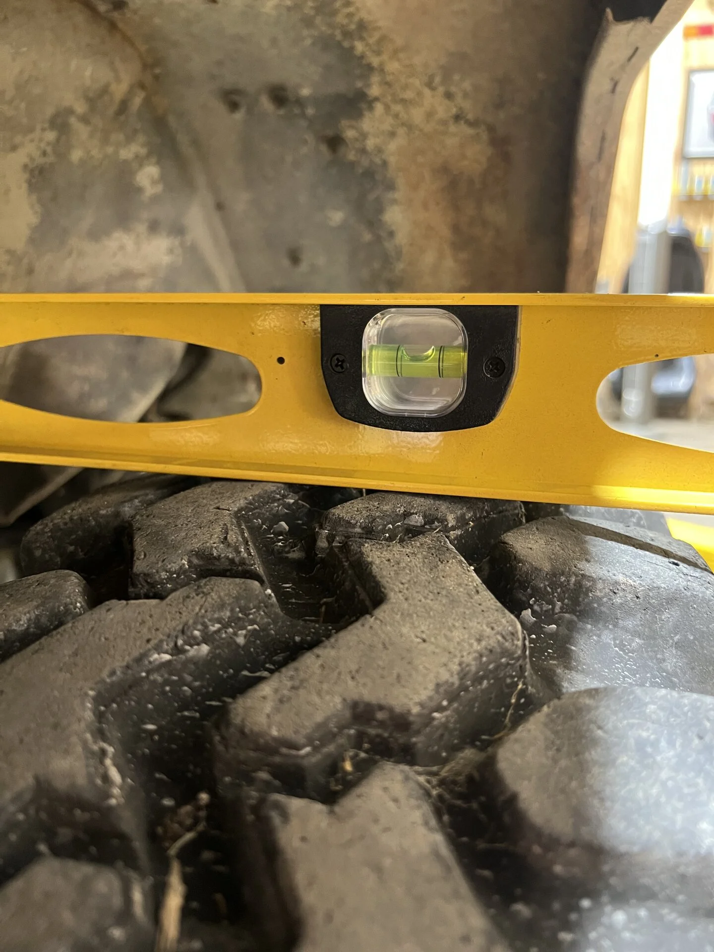

Now the Baja 69 is back on all 4. I measured it just before I tore into the suspension and here is what it was ground to the bottom of the fender. 30 psi
Driver Front 40.25”. Passenger Front 40.75”
Driver rear 38.50”. Passenger Rear 39.25”
Now it sits dead nuts level side to side and front/rear. I’ll get more numbers once all the weight goes back on
Driver Front 39”. Passenger Front 39”
Driver Rear 38.5”. Passenger Rear 38.5”

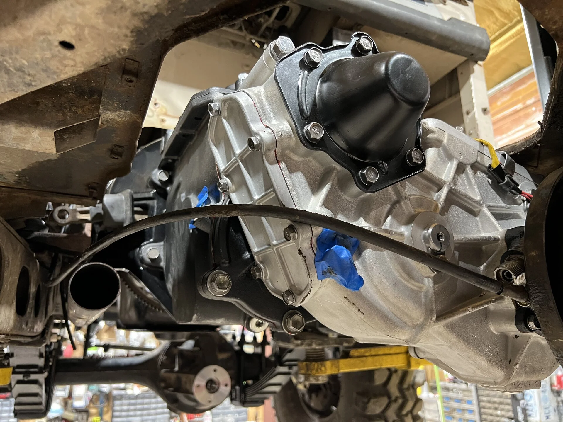

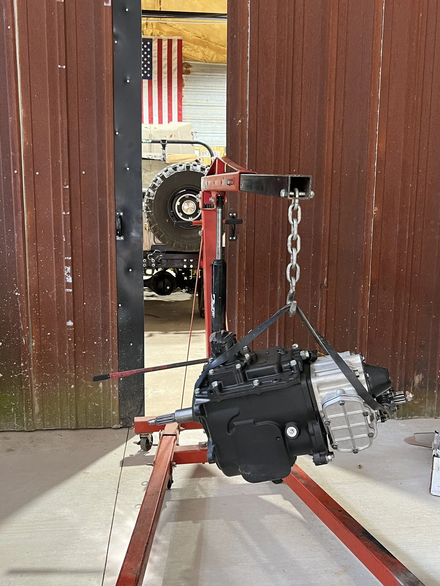

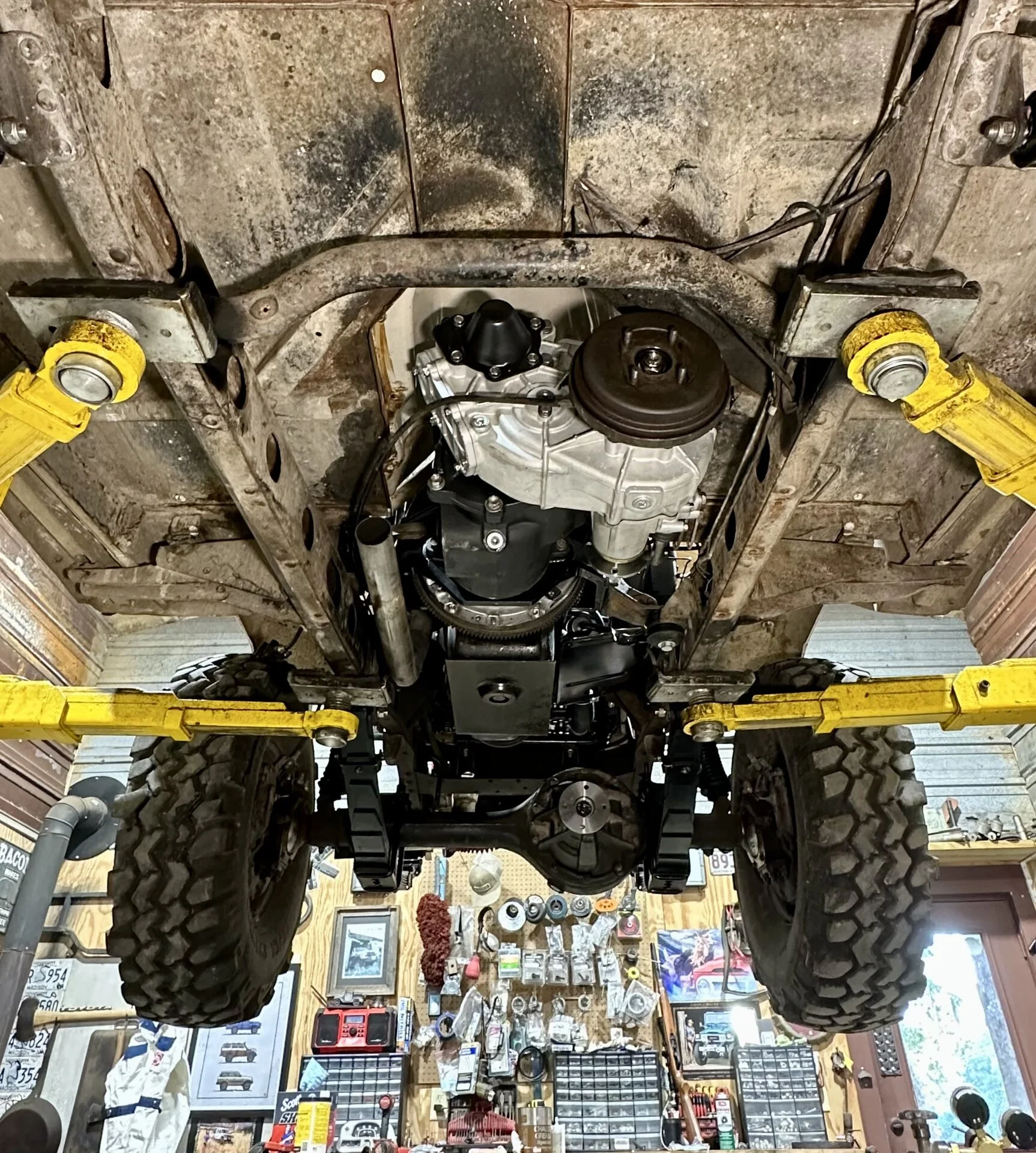

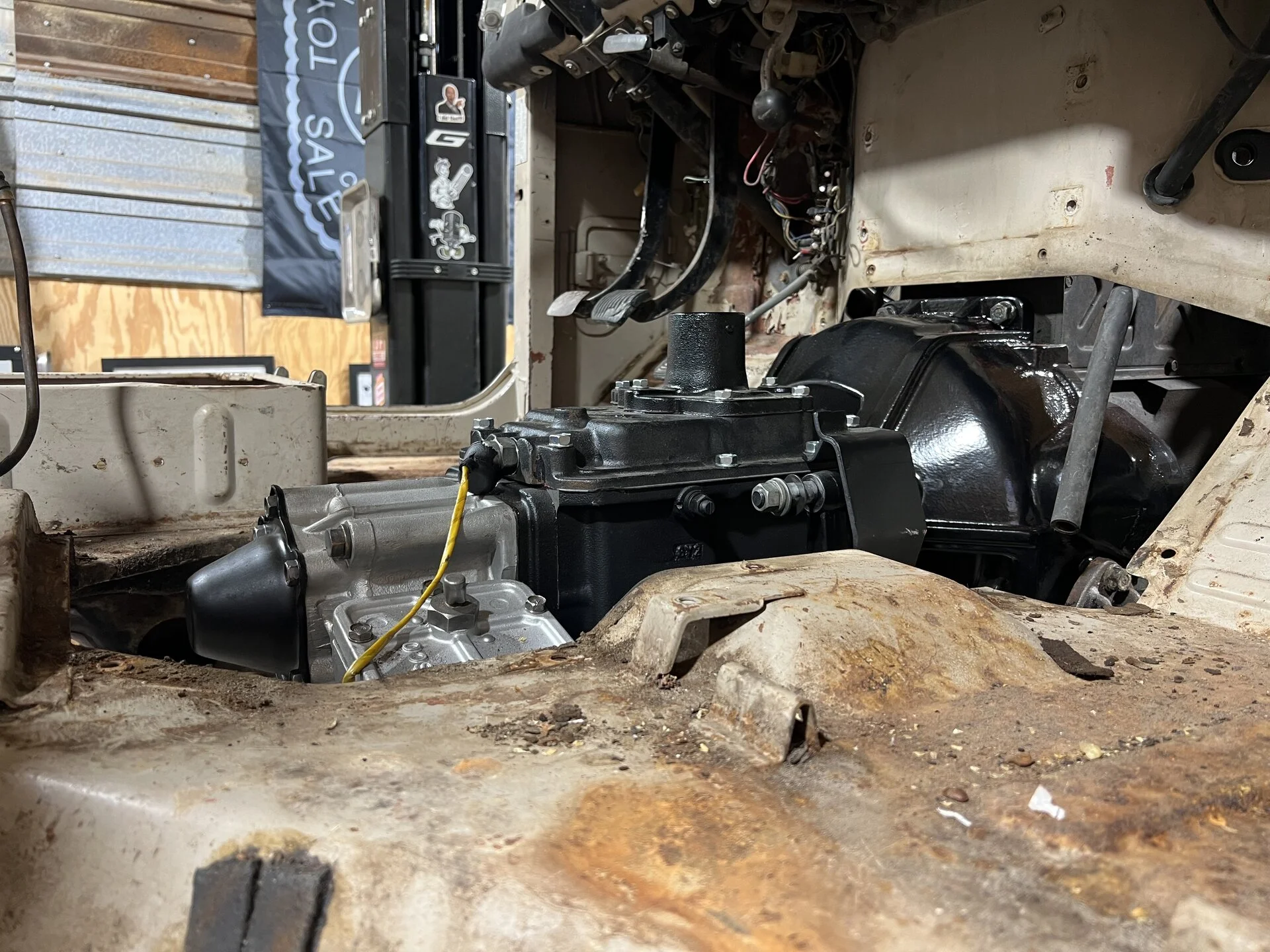

Got the Valley Hybrids 4 speed with 3 speed transfer installed. New motor mounts are going in all around now that the rear is secured I can work on replacing the fronts
Got those front motor mounts out. Both were split. Shot. Kaput.
Got the flanges installed on the Tcase and measured for new Tom Woods shafts.

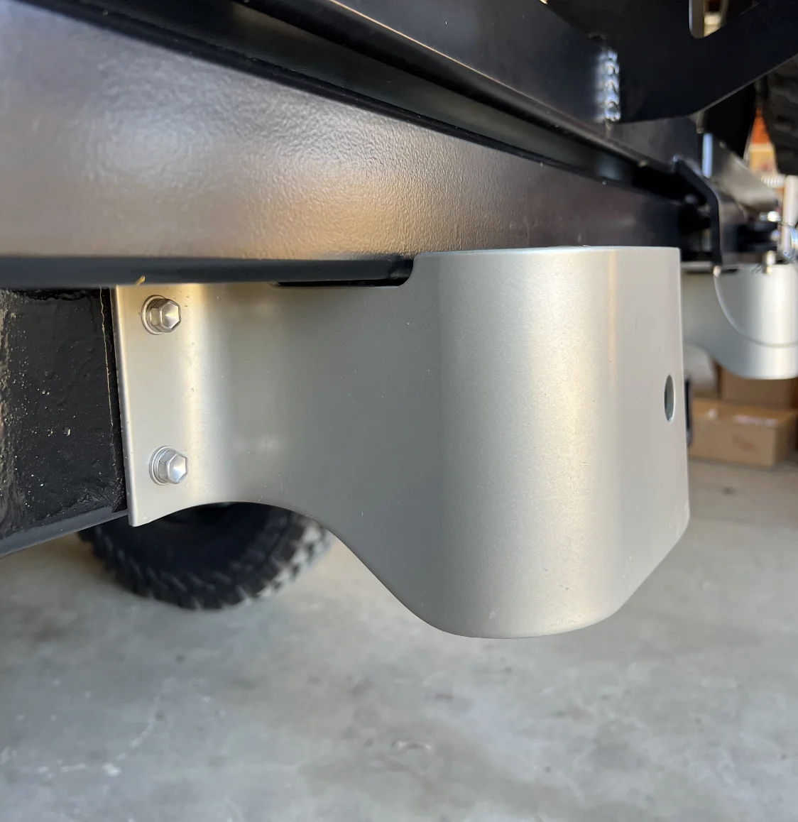

I’ll rebuild the ebrake and fill it full of juice tomorrow and can call the wizard back to glue in the torque tube and put the exhaust back together

FYI. These aftermarket pads are too thick and you need to grind the s*** out of then top and bottom to work.

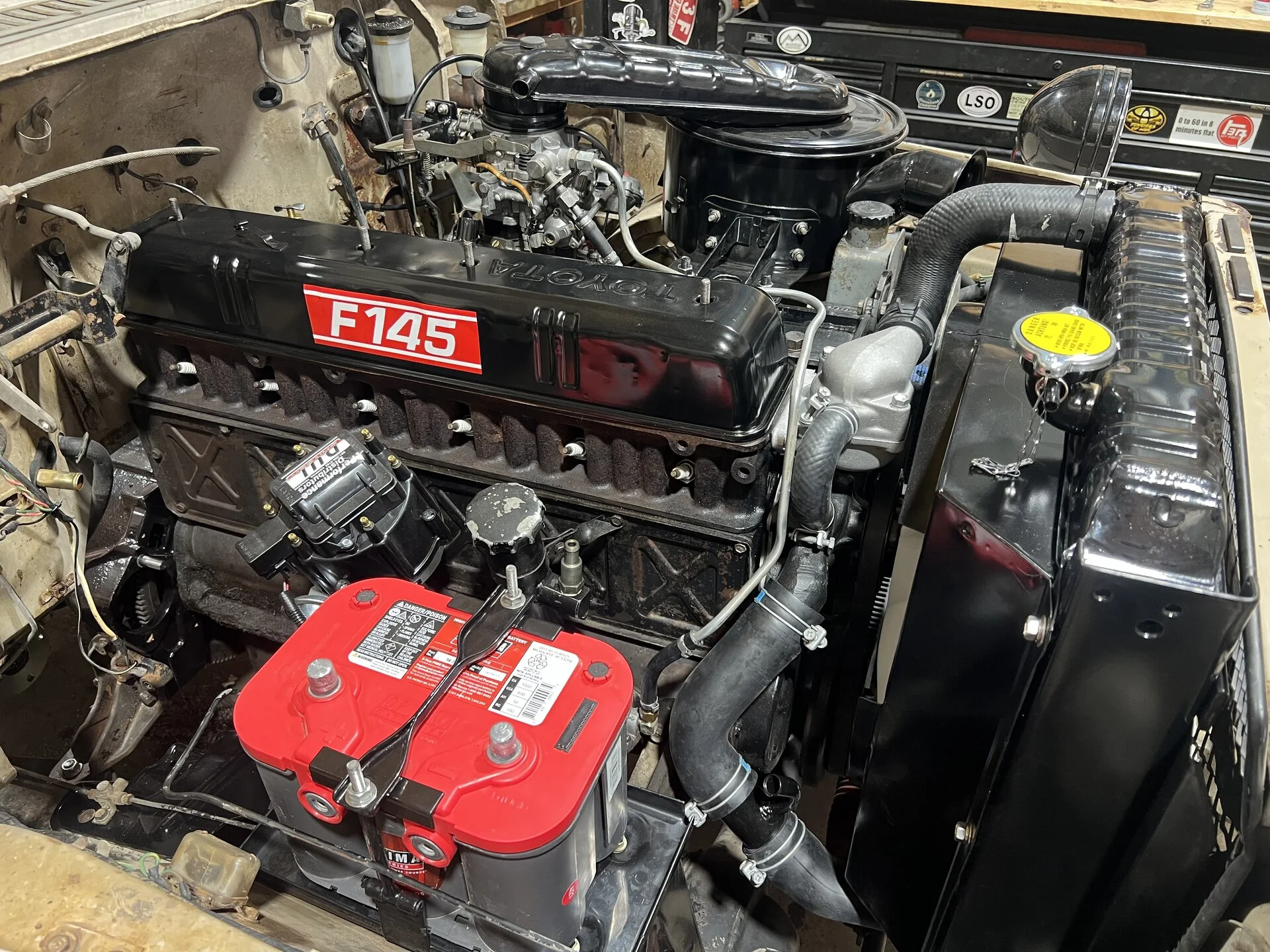

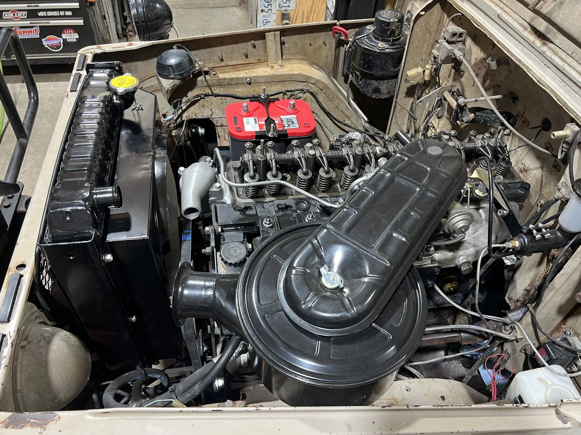

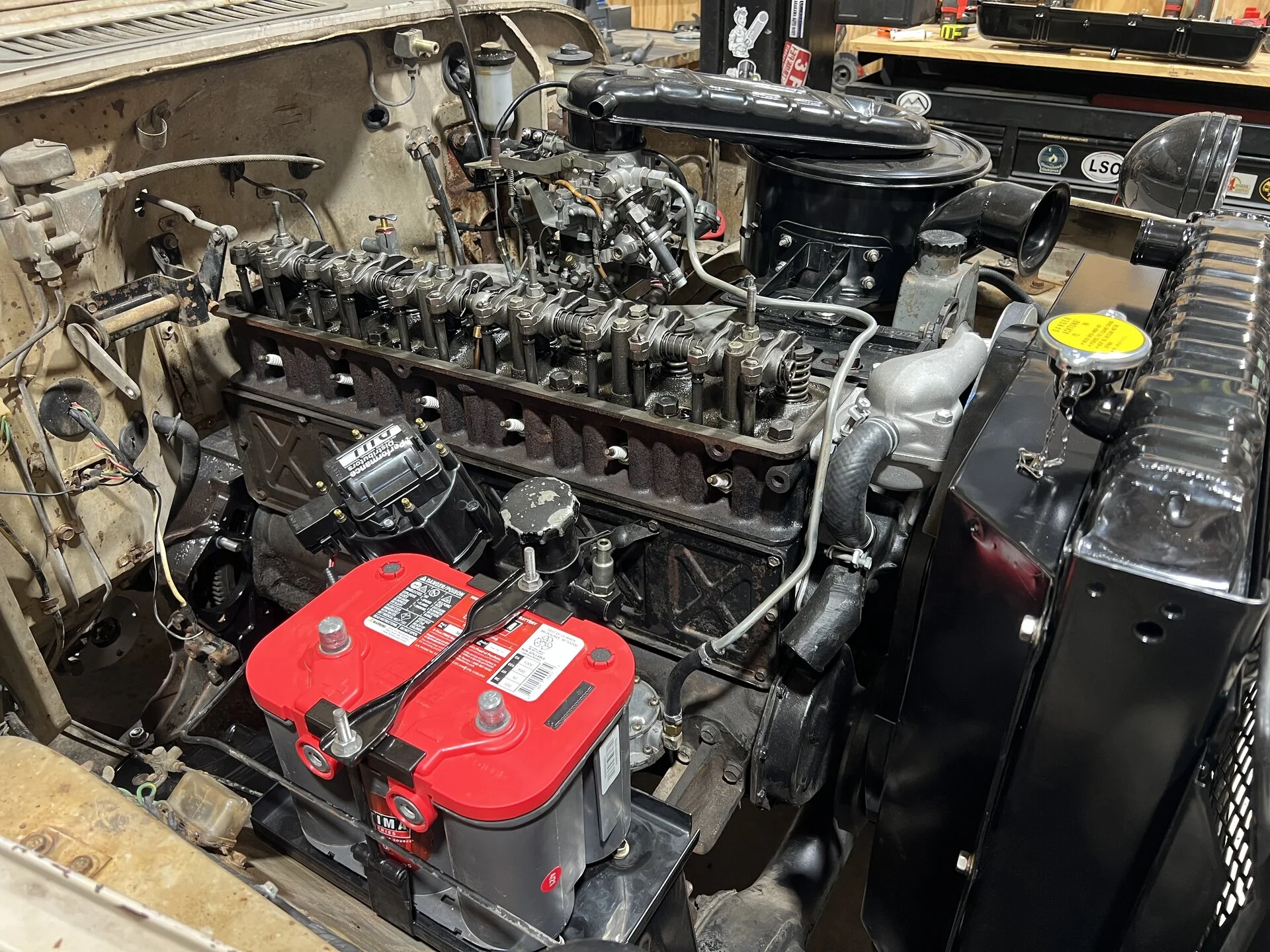

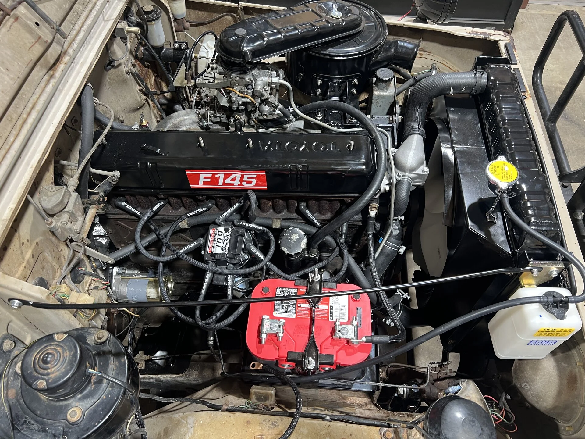

New OEM battery tray and holder. New radiator. Slow and steady.
I’ve been on this thing 11 days straight and 65 hours to date. Gonna take a break from it tomorrow. Worn out. Need to run some errands and such.
More stuff plugged in.

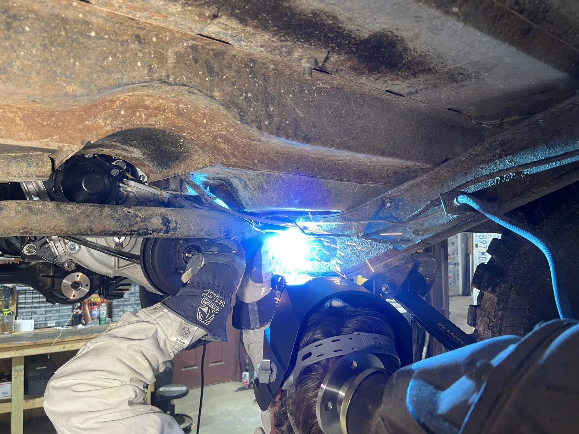

Wizard is on the way for get some welding done so I am getting stuff done in here until it has to go up in the air

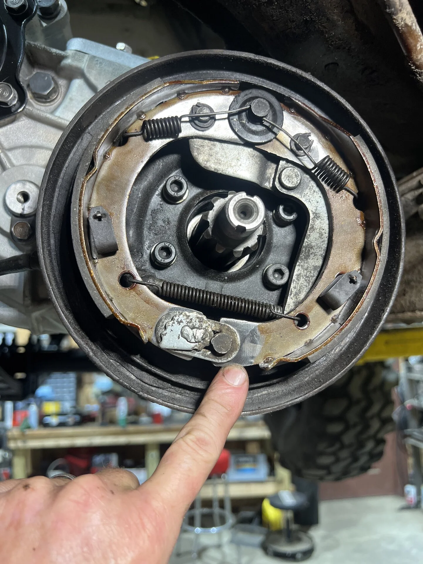

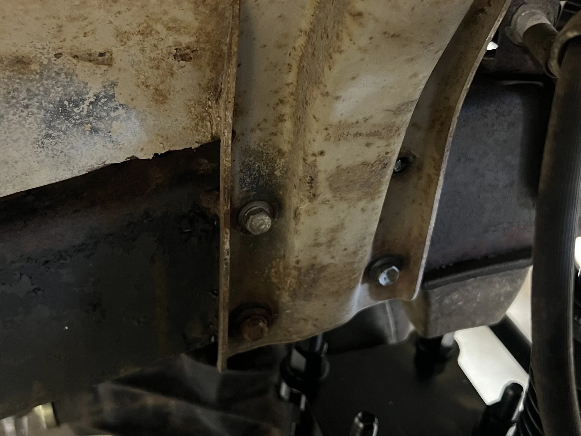

Did you just cut the torque tube out and put it back in the same Location?
My 69 has a big notch removed right by the park brake.. I figured out why once I pulled the trans/ transfer..
Rotated it up and out. That way you can remove and reinstall the driveline
