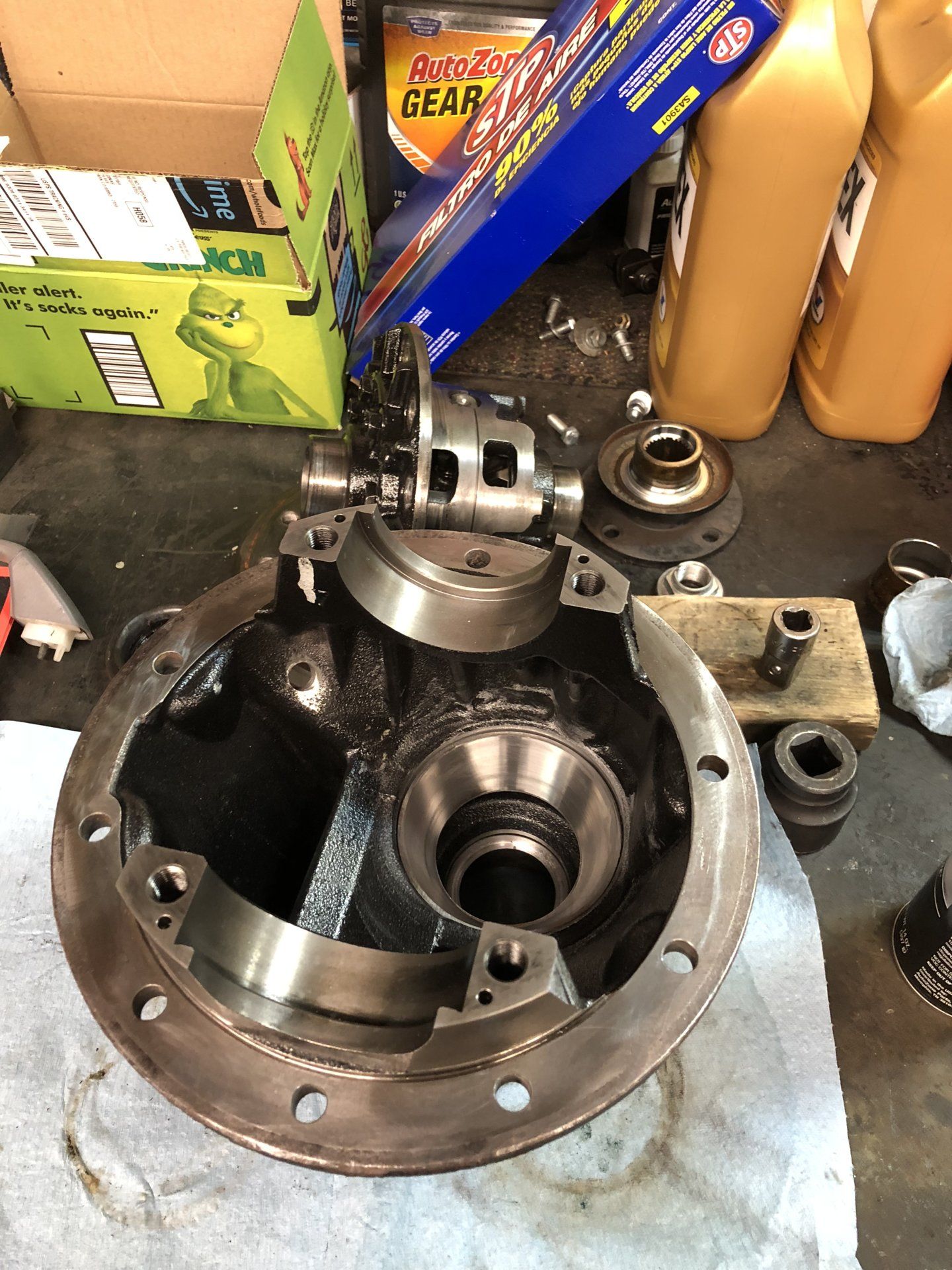

Here is a pic of the inside of the 8.2 third housing. Not sure if this helps answer any questions or not.
