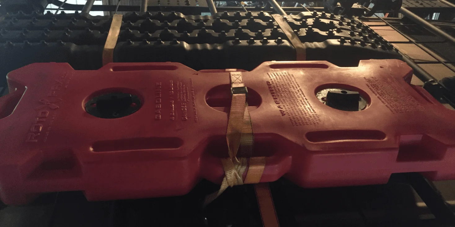

@grinchy That is a pretty great solution. Seems simple enough to do. I looked at a couple of your other pictures in that thread...do you happen to recall the specifics on the hardware you used to attach the Rototrax? I've got a couple sets of Yakima MightyMounts, and want to mount 4 gallon Rotopax in the exact same manner....I already have the Deluxe mounts that I pulled off a couple of motorcycles...
The yakima part that fits the TLC and LX rails is 23H.
