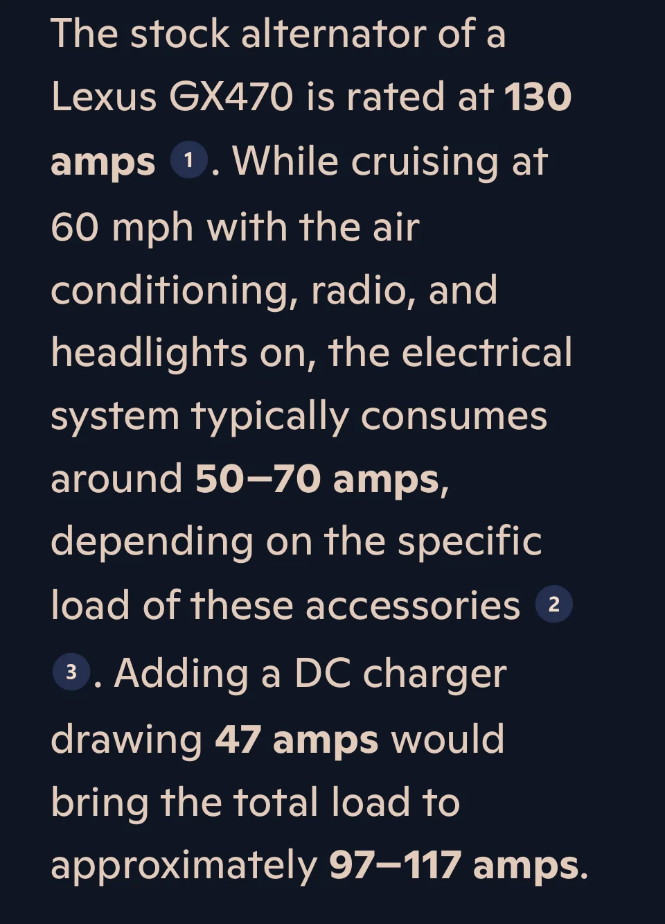

I’m no expert but I’ve been researching the use of the Bluetti charger 1 that can charge up to 560W per hour.
It’s recommended to stay within 80% of the max alternator capacity which is around 104 amps, but it’s okay if you go a little over sometimes. Just make sure the car battery is in top shape to provide the backup power the car needs to run the electrical system.
Copilot says you this…
