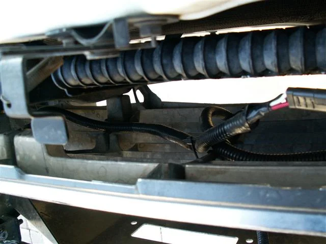

I used a 2 wire trailer harness as a "quick disconnect" for the wires, if I need to remove the lights for any reason.
attachment.php
