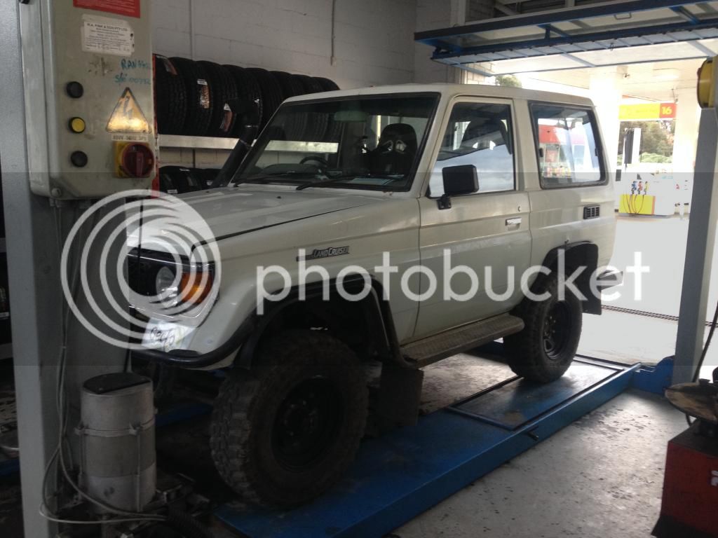

This is my new toy, picked it up in July earlier this year, it was previously being used as a promotional vehicle for a tyre business that is now closed, their loss is my gain!!
Heres the Modification list:
From front to rear
Custom bar with tow hitches
D/lights
Brush bars
2" body lift
2" suspension lift

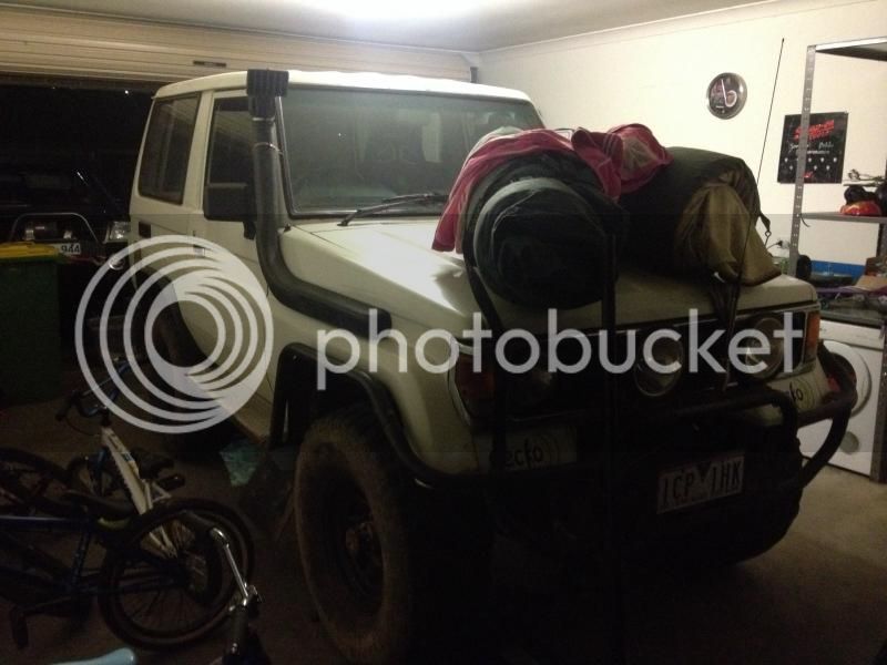

Anyway, enough with the text, heres the pics:
It doesn't come on the 35" tyres pictured, just 31" tyres to pass RWC

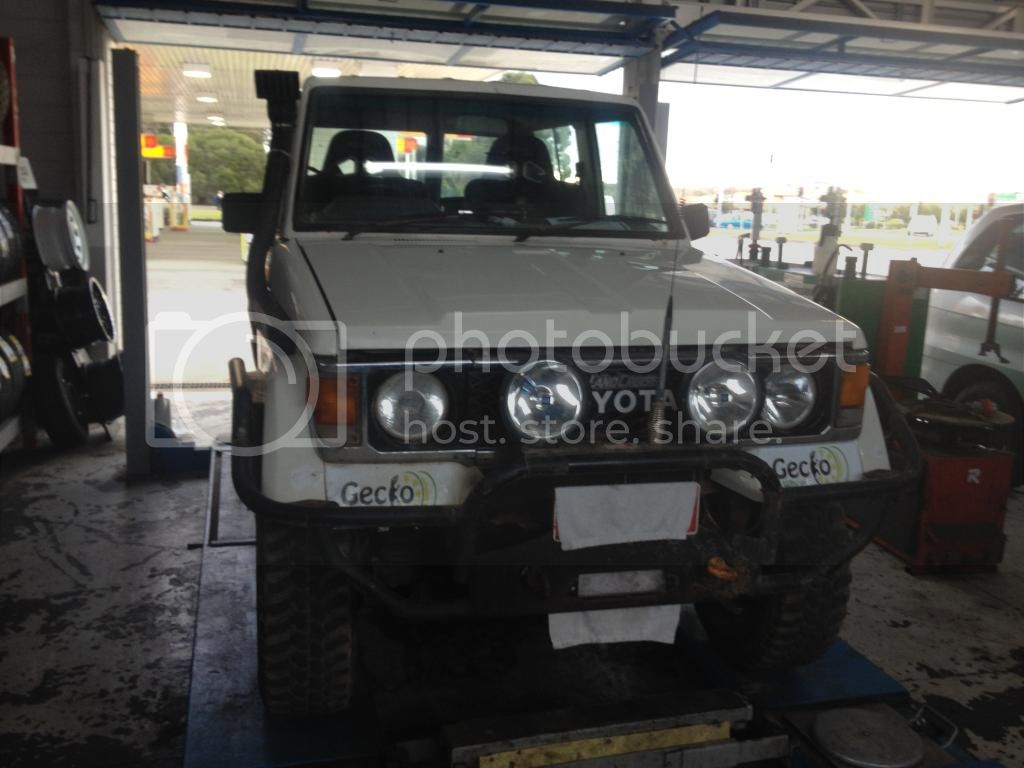

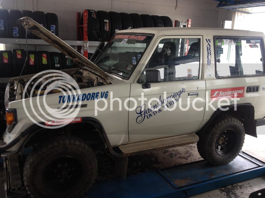

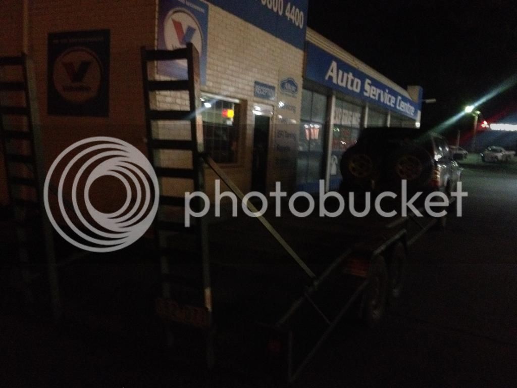

It was an eventful night picking it up, picked up around 7:30pm, got 20 minutes down the road and the death wobbles were ridiculous. Decided to park it up and get a tandem to take it home. The joys of being on the outskirts is that the nearest trailer was nearly half an hour away :(
Got the trailer and headed back up, towed the thing to my work so I could inspect it the next day.
Before anyone says anything, it's an old car that I knew needed work, it has been driven 3 times in the last 18 months.

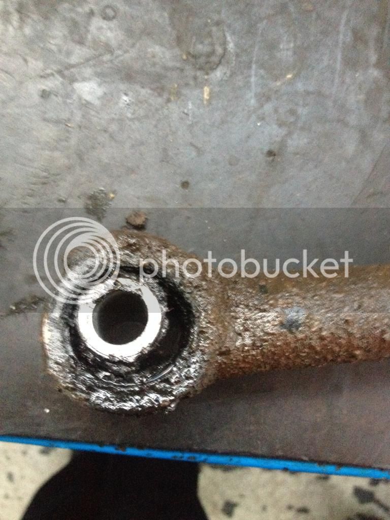

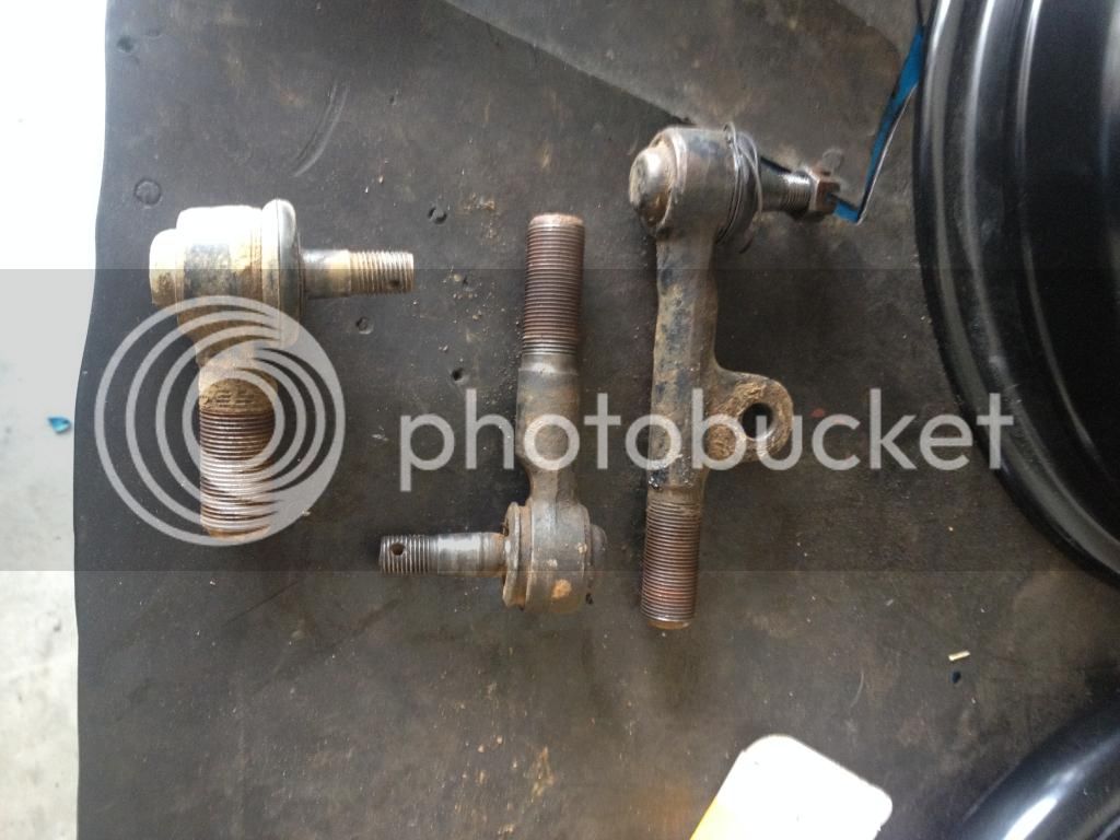

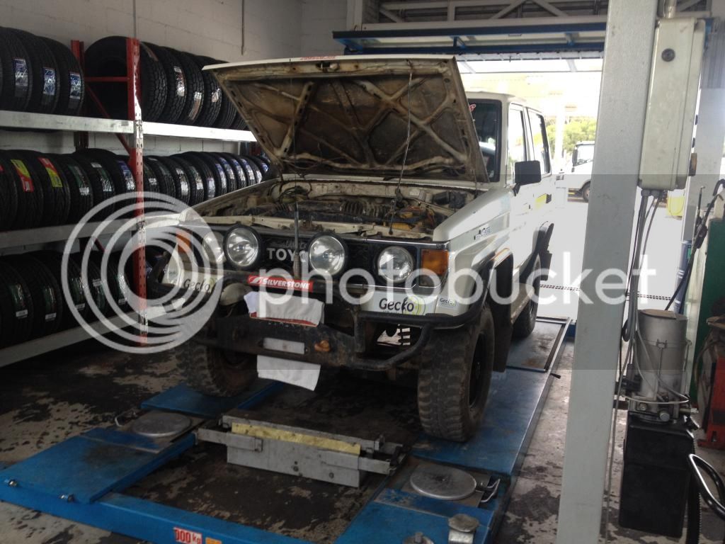

Found caster bushes torn, panhard rod bushes u/s and all the tie rods need repacing, I'll replace all of those parts and that should be a good start in sorting out the wobbles :)
Anyways heres some pics as it sits at the moment:
Pulled all the stickers off, tightened the bolts holding the steering coupling as there was about 10mm of movement side to side on the steering wheel
Removed all the tie rod ends and replaced 3 of them, I had been supplied the wrong one so couldn't finish doing the job.
Found the steering arms to have small bends in them so made some measurements and gave the old tie rods to a mate of mine who has an engineering shop so he can make me some solid chromoly steering arms and throw away the hollow factory ones.

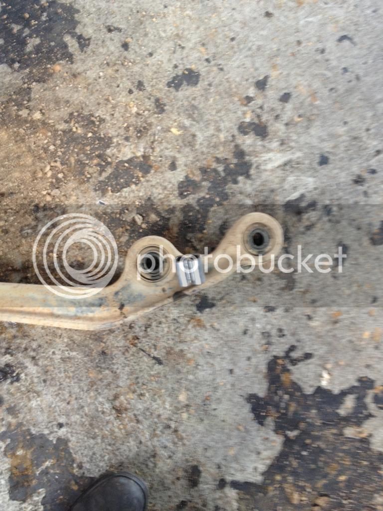

Then started working on the front suspension, pulled the panhard out, yep, bush has definitely had it :)
Then pulled out the radius arms and attempted to press them out, my little 10 tonner wasn't going to get them out, took them up to my local pedders suspension to use their press. Their 30 tonne press nearly maxxed out but they got them out for me :)
