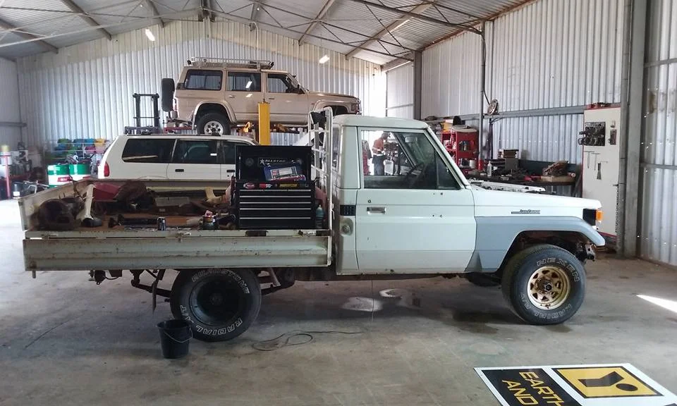

New to the forums and thought I would do a build thread on my recently acquired 1985 FJ75.
Picked it up the other day. Licensed, but has done 400,000km's. It has a 3F engine and scored another engine for spares/rebuild. Has a fibreglass roof, 2" lift and came with a new clutch (not fitted). Also came with 6x tyres and rims and some other spare parts. Also came with a tray (not pictured).
Going to have a look at another FJ75 next week and hopefully pick that up for parts. It's unlicensed, but has only done 213,000km's so should have a better driveline (not that there is anything wrong with the current one). The body is in better condition on this one and it has a good tray with hardwood floor so will most likely do a cab swap and make one Cruiser out of the two cars using the best parts from each.
She is pretty rough, but it won't take long to get her sorted :)

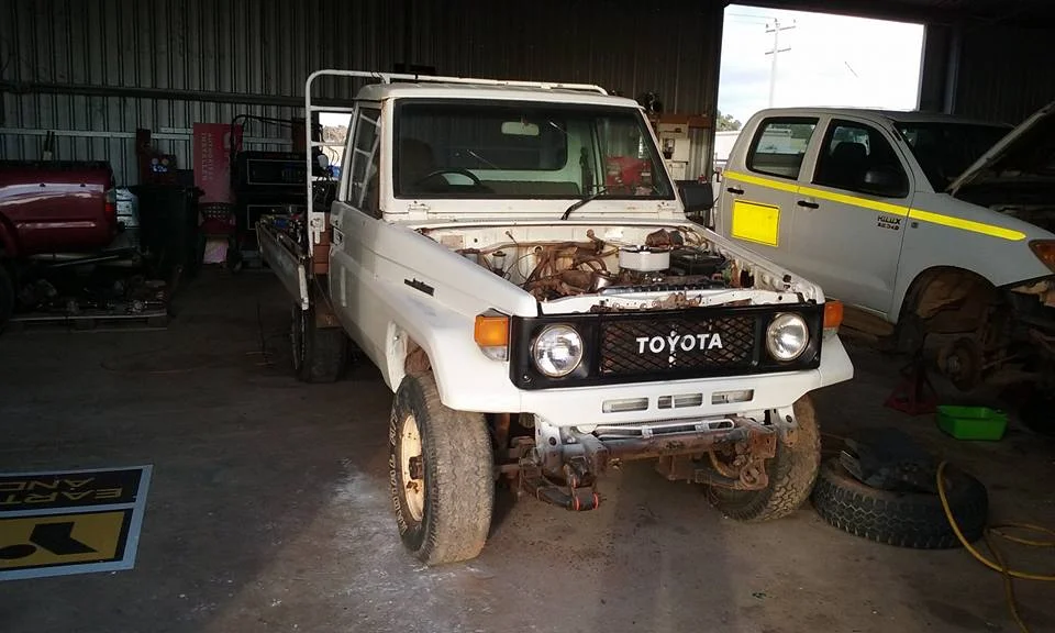

Well the one pictured is licensed, but the other one I am going to look at has a better cab and a driveline with less K's. So will swap the driveline from the lower km one into the one pictured and swap cabs over as well.
Basically make one ute out of the two using the best bits from both.
Will mostly use it for camping, fishing and touring.
I am also getting into Speedway racing so it will be my tow vehicle for the racecar.
Down the road I will look at swapping a V8 petrol engine or possibly a turbo diesel 6 into it.
For now though I just want to get it on the road and running :)
Oh and one of the first things I am going to do is remove the christmas tree lights off the roof.
Someone at some stage must have done it up like a Mack Truck lol
Those sidesteps will need to go as well.

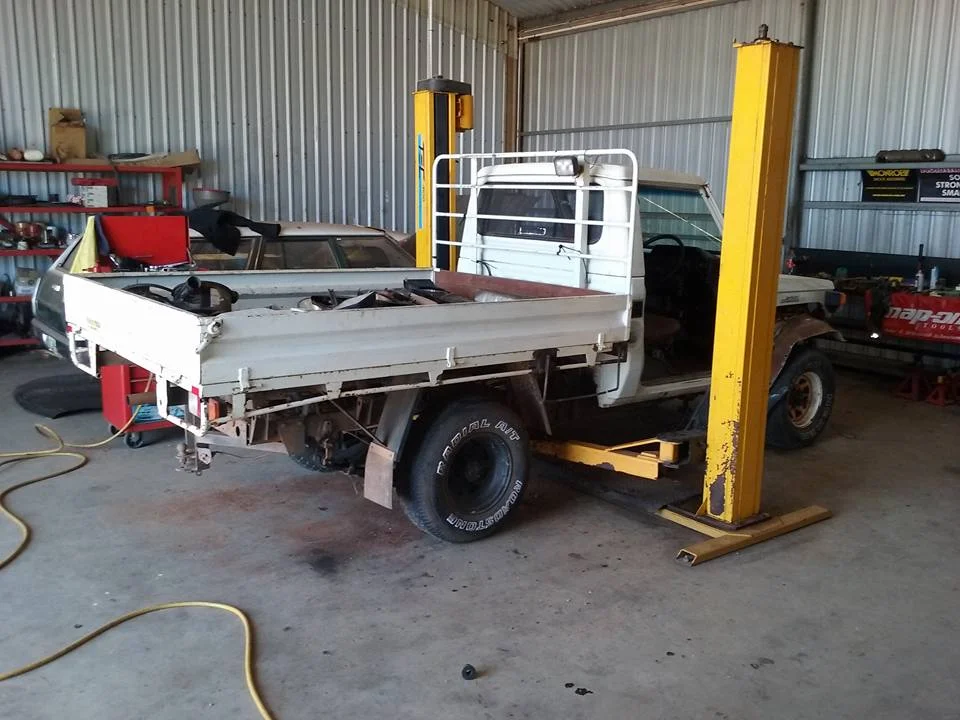

Well after much consideration I have decided to repair the second 75 series Ute I own.
The one pictured above had a lot of body rust and the engine was down on compression quite badly on 3 cylinders.
The other one I have has 213,00km's (132,000 miles roughly) on the clock and the engine runs fine.
First thing I had to do was swap diffs. The previous owner had attempted to rebuild the differential with new bearings, but had left out a pinion spacer and munched the crown and pinion.
Diff removed from vehicle:
Diff from donor car installed:

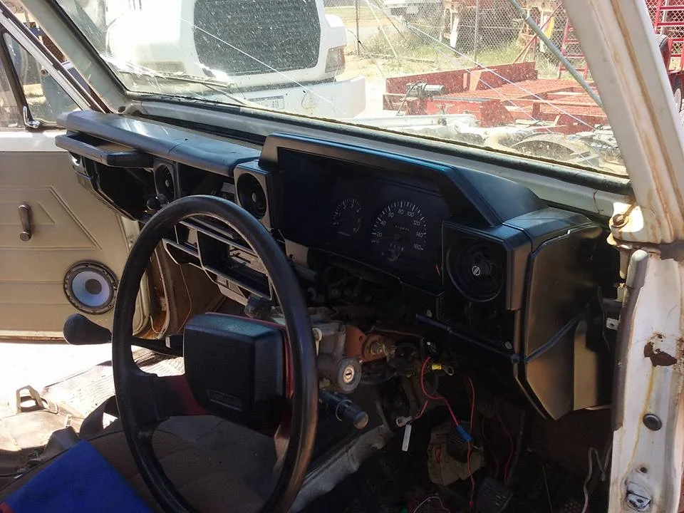

The dashboard was missing from the Cruiser so I removed the dash from the donor car and painted it satin black and refitted it to the project car:

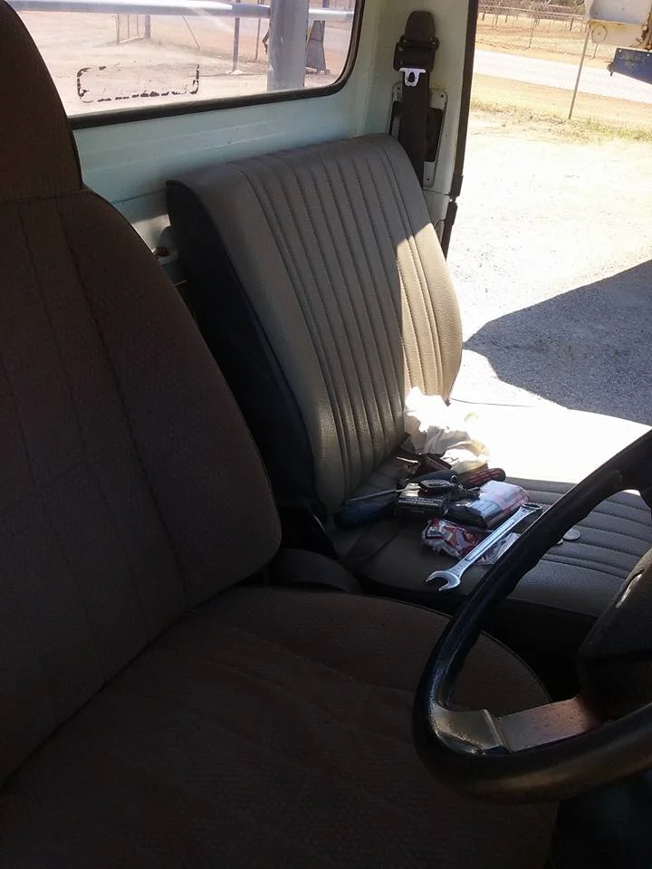

Passenger seat was also missing and luckily the donor car had a seat in good condition:

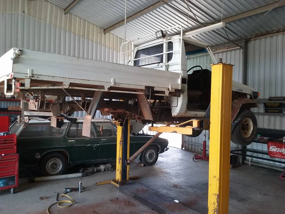

The front right hand quarter panel was missing and the right hand door was removed to do this so I replaced the panel with one from the donor car and refitted the door:
