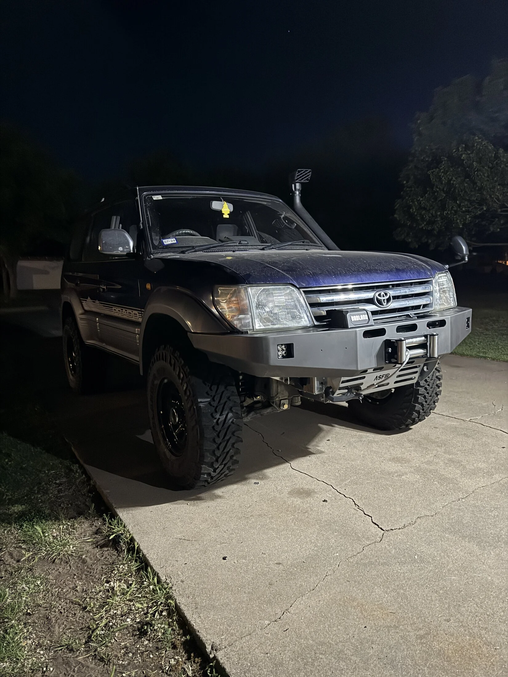

Howdy! Anyone running the ASFIR front bumper on their 90? I am about to start assembly, and have the schematics, but was wondering if anyone has any more clear procedural instructions for it that might act as a nice guide. Pic is of my 96 KZJ95 after it got a suspension upgrade!
Update: Slowly making progress using the assembly schematic, but it's been a challenge. Got the framing assembly ready to mount to the frame of the Prado, thinking that the factor studs coming out of the frame were what it mounts to and the nuts reused. However, there was not enough thread left on the shorter studs, and the nuts stripped when I was attempting to torque them down.
Turns out that you actually have to extract those studs (which had definitely never been touched in the truck's 28 year lifespan and were a giant pain in the ass) and then they are replaced with M12 bolts that come with the bumper kit. Couldn't tell from using the schematic that this was the solution until kind of looking back at it in hindsight. Got the old studs removed by using an extraction adapter on a breaker bar, and tomorrow will pick up where I left off.
P.S. - I nearly put a hole in my radiator while trying to break one of the old nuts free. Got REAL close
Finally done with the install. Was quite a pain in the butt, and had to manipulate some of the body subframe members to get it to fit decently, and even at that, the fitment is still a bit off. I quadruple checked that I wasn't snagging anything due to my own stupidity, and was sure it wasn't.
Overall, for the budget friendliness, can't complain too much. Here's to hoping and praying it holds up and treats me well!
