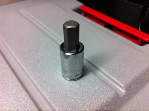

packetstorming, when you do the front mine needed a 10mm allen. I didn't get the allen to wrench converter so I had to use a puny 10mm allen wrench and oh lordy that gave me bloody knuckles torquing that thing. The bolts are facing out on the passenger's side and it's really close to the suspension arms (in other words little to no space to work). You definitely cannot pour the fluid in with a 1L bottle. You will need to use some tubing that routes out of the wheel where someone can squeeze the bottle (or you can hook the tubing to a pump). If you need pics I can take some for you if I get a chance.

This. And, have a beer within reach. 75W-90 doesn't pass through 1/4" tubing quickly even with a vent hole cut into the bottom of the quart bottle. Picked up the 10mm allen key socket at a local auto parts store.

I will pick that 10mm allen socket up when I go checker.
