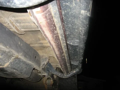

The steps themselves seemed tough enough. I think you could just weld a bar/pipe between the two support legs right under the rocker and you'd have a simple solution. Maybe add another support leg to the frame.
I did just that added three bars on the outside and 1 to the frame.. only pic i got
Those look good! As well as appear very functional. Is ther anyway you could post some more pics so that I can borrow the design? Thank you in advance.
