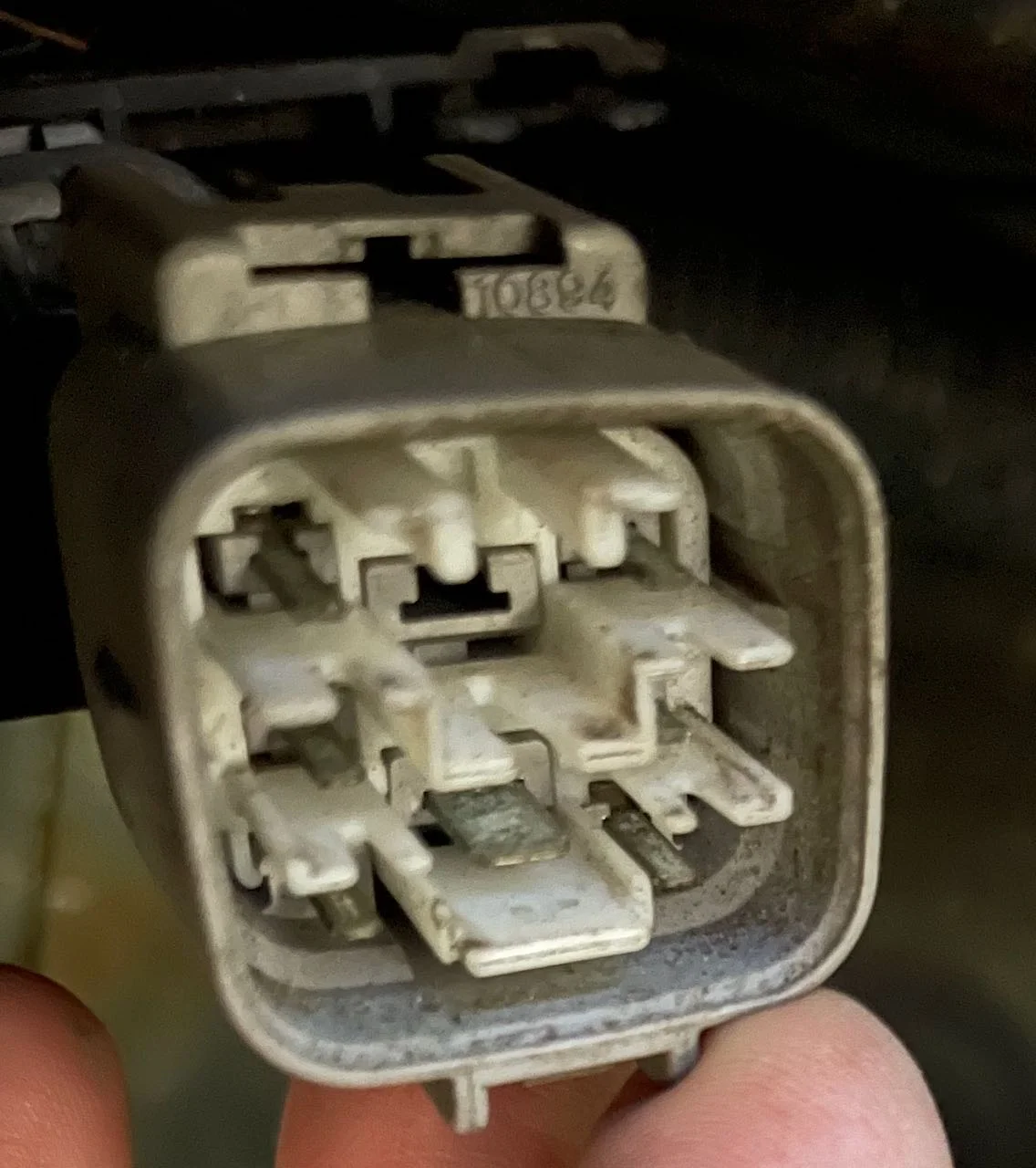

I'd like to 1st. mention that I have searched all of the posts and threads relating to this topic on the site and I am now more confused than ever. I begin by laying direct blame on ARB for not mentioning anywhere on their site that the ARB rear bumper wiring is not compatible with the US version LC100 wiring harness. Their tech support is by far the worst I have ever encountered and is a complete waste of time. They did however provide me with a crude wiring diagram for a work around connection to the LC's tow harness. This confused me ever further.
I can get the directional signals to work but when I connect the brake lights - all lights light up. Tried multiple variations with no luck. I did purchase a CURT 2-TO-3-Wire Taillight Converter after reading a few posts but haven't attempted a test.
Is there anyone that has been successful using the CURT on their LC's tow harness? If so I would be eager and appreciative to know how it was installed.
Many thanks in advanced. This site has been the GO-TO for working on my new ride and I would appreciate any constructive comments.
The 98-02 are different than the 03+. I think you basically want a 7-pin setup and that can connector the bumper. Have you seen this thread?
