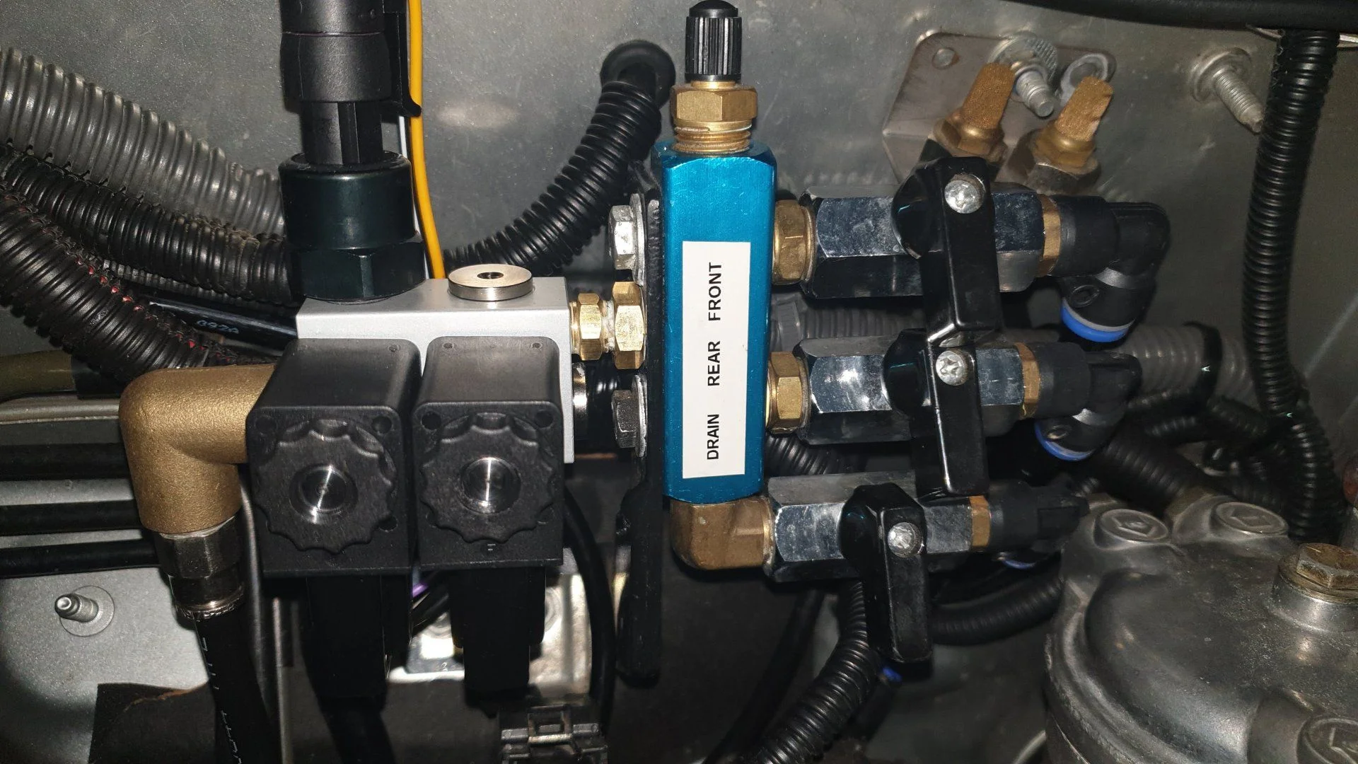

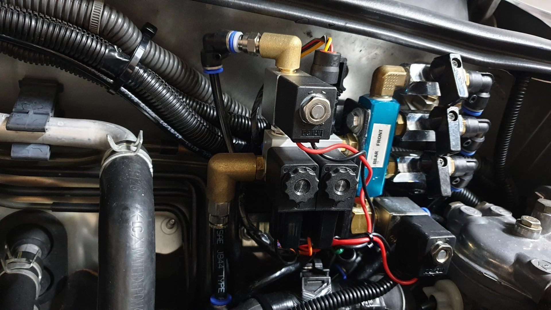

I've added one to my diy "air up down" setup, works well, though I have now added a couple more dump solenoid valves as going from 38 psi to 12 psi took around 6 minutes (31" tyres). Just used 2 cheap ebay valves and now the air down time is around 3 minutes.
The unit is similar to a forecourt tyre inflation device, it reads the pressure and depending on whether your airing up or down it will open the inflate valve or deflate valve for 10-20 seconds and then close either, read the pressure for a second and then repeat until the pressure is reached. I'm happy with it now it is modified to suit. I can adjust pressures without opening the bonnet (hood ;)) just connect the four chucks to the tyre valves and sit back in the car in the AC. Inflation times are similar to what I had manually inflating with my "air up down" setup.
Btw - I have an endless air setup on my vehicle - a Sanden SD7 AC compressor connected to a 3 litre tank.
Below image is before adding the 2 extra solenoid valves, it exhausts out of a 2mm orifice which is a bit slow.
After adding 2 extra dump valves.
