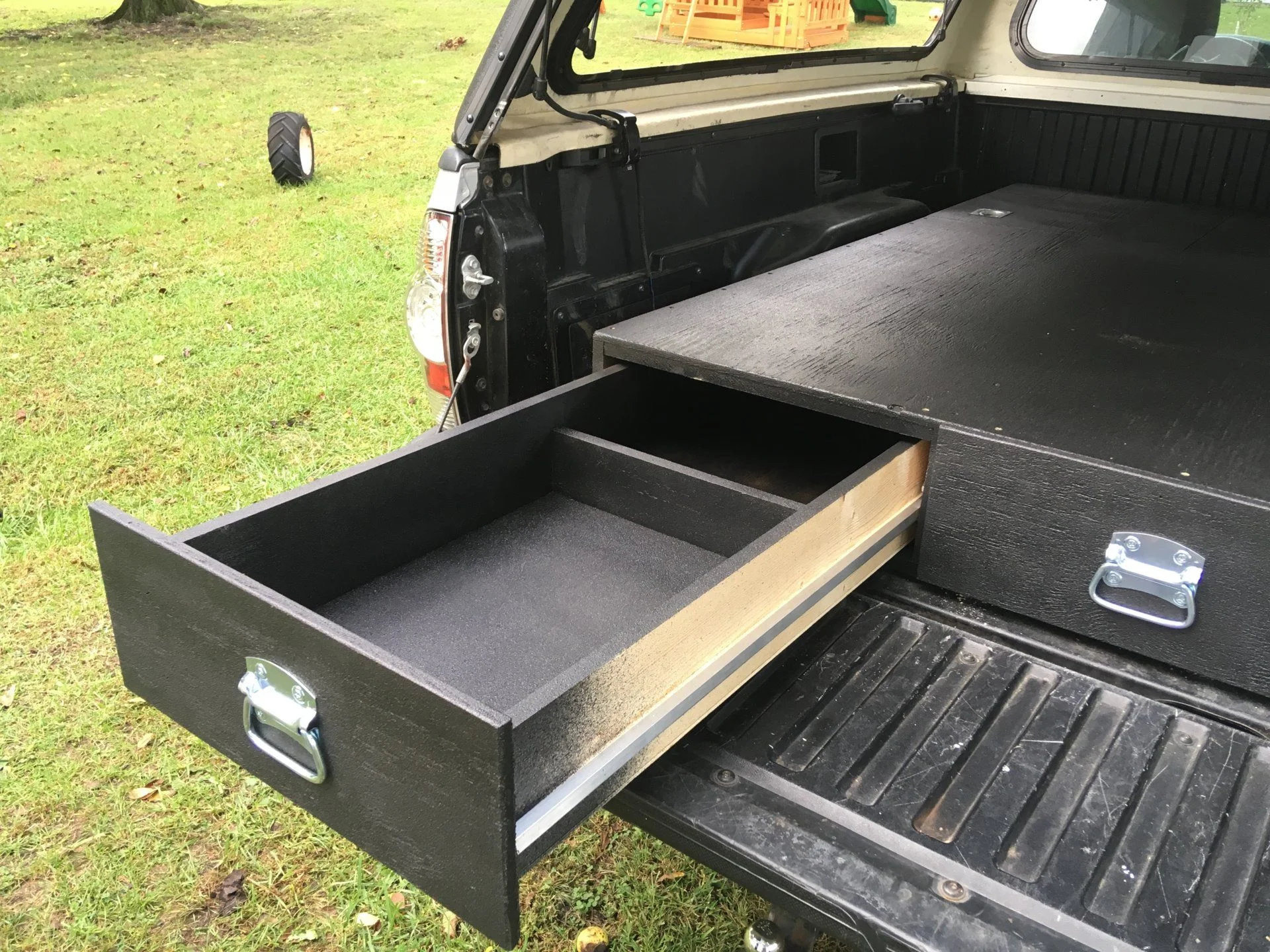

buy some 250 locking sliders on amazon some 3/4 in birch ply and some 1/2 in birch ply and build your own takes a day and a circular saw. then you can make exactly what you want. Im no carpenter or cabinet maker and I built mine. not the greatest ho to video but its in there.
+1 on the above, if you have the time and a few simple tools. These are pretty easy because the drawers aren’t very deep and you can use standard ball bearing drawer hardware.
I built a set for my Tacoma using skateboard bearings and aluminum rails attached to the drawer sides.
I made the drawers 4’ long and made 2’ hatches at the front. Stored stove, pots and pans, propane cylinders, paper towels, etc. in the drawers while camping. Used them for hand tools/power tools when working.

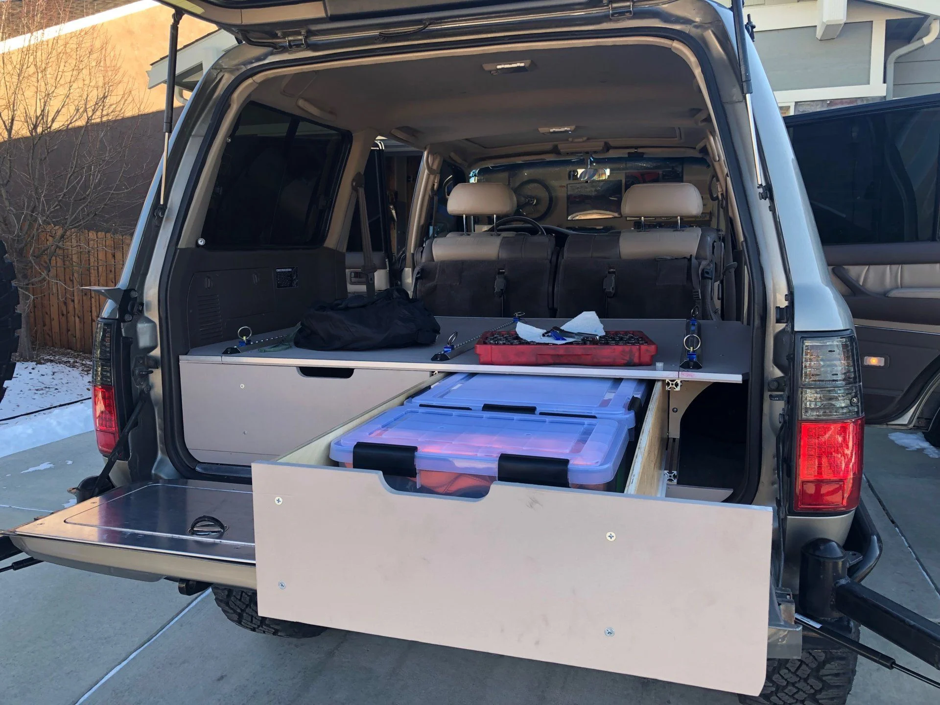

Make them, I did it was well worth it
KISS Drawers here...finished with a deck paint that is scuff resistant and easy to clean. L-Track on top and some nice waterproof bins that fit great and are stackable.
