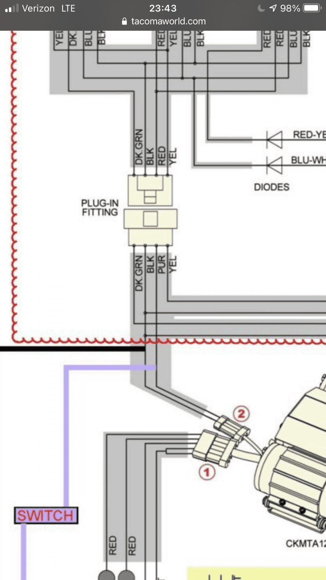

Does anyone on here have ARB installed on their GX? Looking to install mine and need a little help on connecting the red and blue wires into fuse box.
So I know the red wire connects to the IGN for power which is the 10A but not sure where should I connect the blue wire to...
Thanks

Yes, if you can take a quick picture of your fuse box under the dash showing where the red and blue wires are plugged into.
I got the red wire done... compressor is working, just wanted to see where the blue wire would go.

Well I'm not sure which one of these is for my compressor switch and which is for my rear seat USB ports, but both are stuck in unused switched power fuse slots. I hope this helps.
I connected my red (power) to the 15A fuse slot for P/OUTLET and the blue wire (switch light) to the 7.5A slot for PANEL using low profile fuse taps. The P/OUTLET is only hot when the engine is running. The PANEL is hot when light is on. Both are added using 15A fuses.
