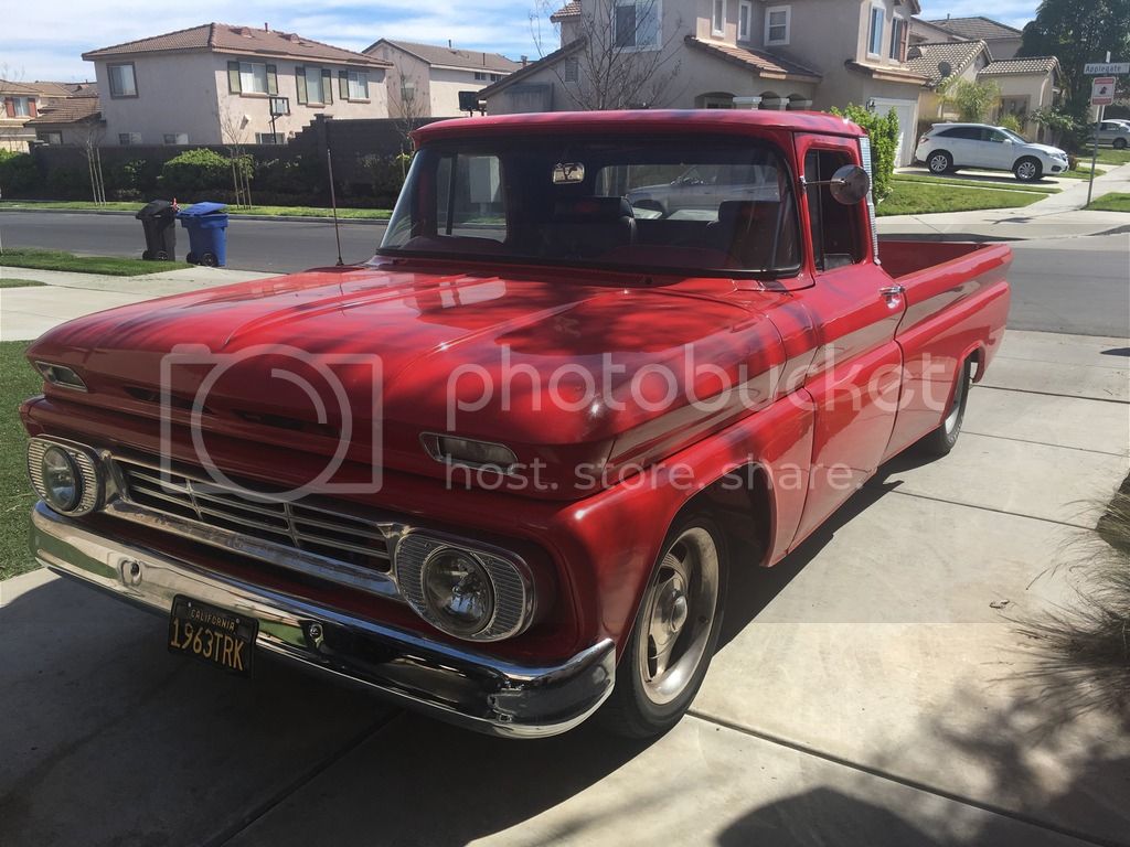

These things are pretty common in Street Rod Building. My experience is that these lenses suffer a bit in the "bright light" category because the reflectors aren't perfectly shaped. I think it would be fine if you have auxiliary driving lights or something to help out with the nighttime long distance vision.

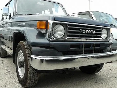

Not to hijack this thread, but I like what the 70 series blinkers look like, would be another idea for the front.
I believe a few MUD members use them, forsure I know that Bursabaju rocks them on his!! I'm thinking of going this route, I think they fit the look of the 40 perfect!

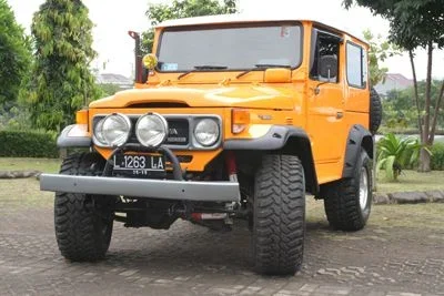

Autonik headlights with additional lights cut into the lower portion of the front bib. The round amber lights (Grote) carry out the parking light duties and at the same time have a built in DOT spec. reflector to keep the front end legal. I wired the amber LED's inside the headlights for turn signal use only.
What size wheels and tires are those
They are nice
Are the turn signals in that amber, do they also work for the running lights. Many states require turn signals to be amber. I do like the 70 series lights on an Fj40, they truly look like they were made for it. Very popular in picture from south america. That is the route I would go if I off roaded a lot.
