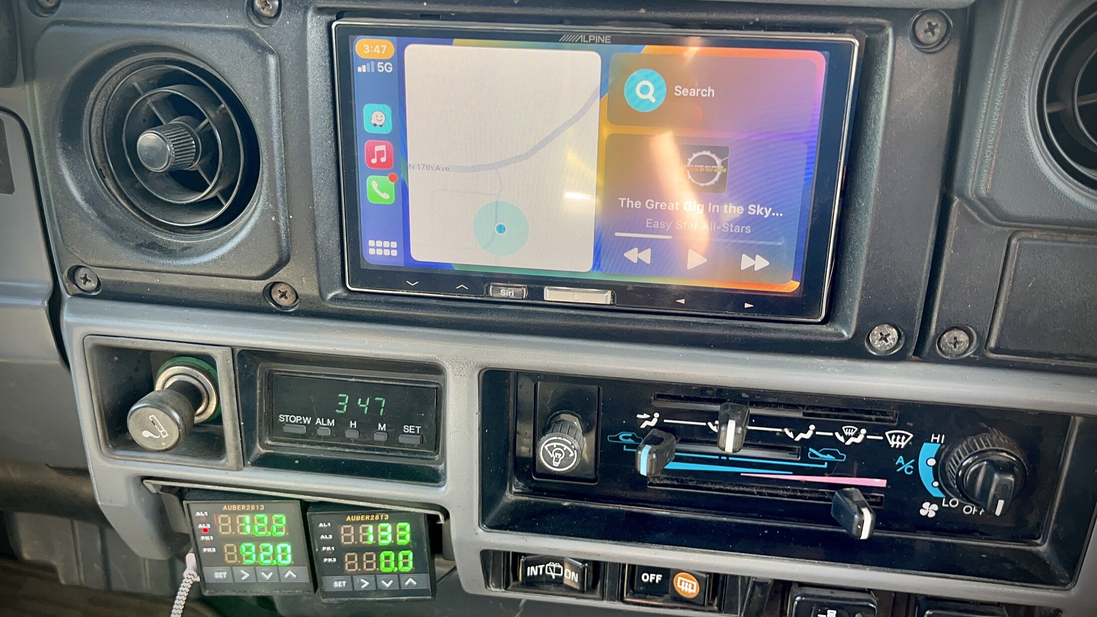

Im running Auber dual gauges for my engine monitoring.
Left guage:
Upper: voltage
Lower: coolant/head temp
Right gauge:
Upper: EGT
Lower: boost
The good thing in you can get sensors to read all sorts of data through the same gauges, setup visible and audible alarms with relay triggers…ie kick fan on. You can change them at anytime. They also come in different colors.
