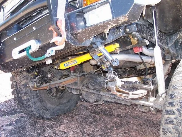

This is one of Gary's pictures (Wagoneer5).
Hey folks just need to clairify-Waggoner is running Superior Shackles from down under.....Not Tera Flex.....David Dearborn got 4 sets & all had rave reviews for the shackles.
Might want to search for Superior Shackles:idea:
Other than that nothing else to offer.....
That pic of those shackles just doesn't look safe to me. I would like to hear gary's opinion on them if anyone can get him to chime in.
