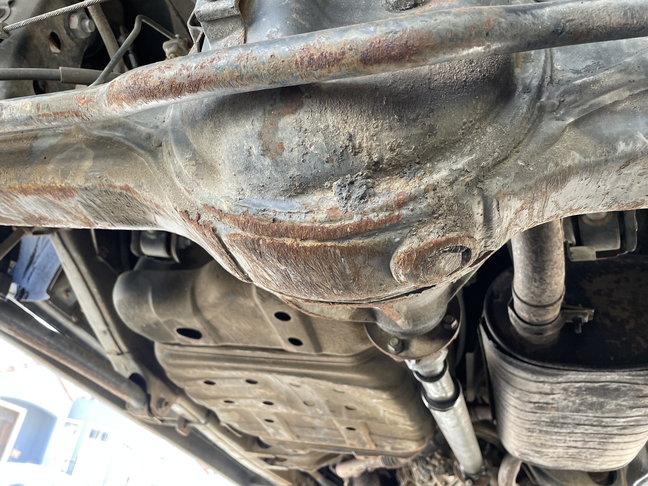

I've recently participated in "Sahara Desert Challenge", an expedition covering 5 countries throughout 2 continents and somewhere along the way I felt a rock hitting the car (it was the other way around...) right in the middle, where I thought my skid plates would have taken he beat...
That was not what happened, the car hit the rock right in the rear differential, making a huge scratch but specially causing some warp around the seal that now is leaking...
So it's my fault, for sure, not to have installed a rear differential skid plate and also for assuming that that one rock would not touch the car...
The end result:
I would double check the torque in the bolts. When I hit my drain plug it got tweaked and was dripping. It’s possible retorquing might stop the drip.
If not you may get away with cleaning it up and slathering on some RTV “green” made lfor gear oil”. It’s really tacky (and actually grayish) but might stop a small drip.
You didn’t seem to hit the drain out, but I’ve thought about taking a 1/4” piece of aluminum bent 90* and attached to the studs to cover the drain and keep from re-destroying it, sort of a sacrificial piece of armor, though now I question if it might bend or break a stud or cause a leak like this…
