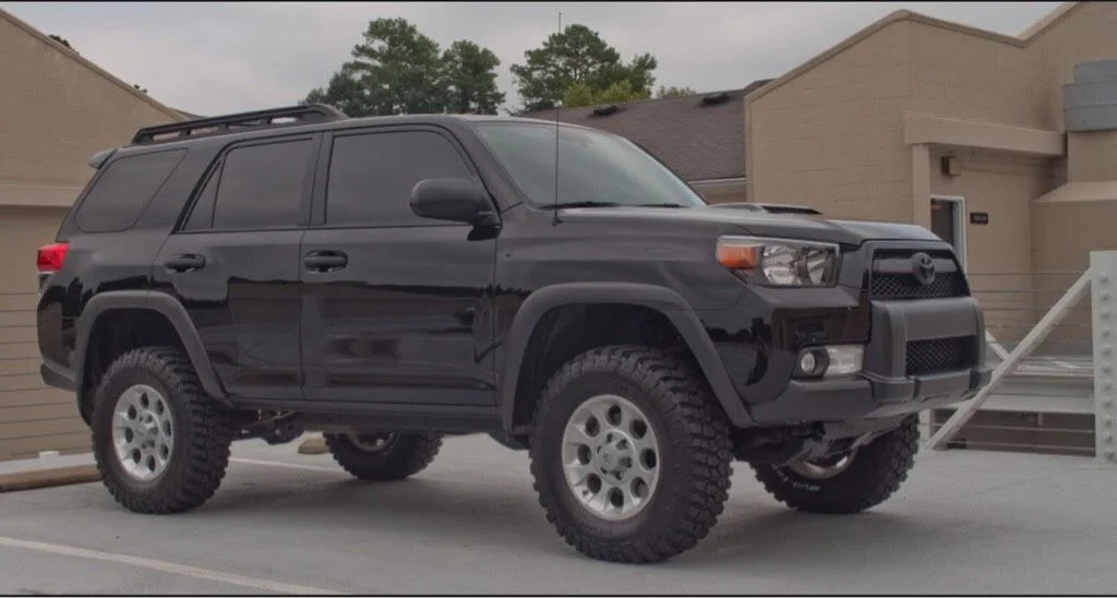

Hey guys, my buddy just bought a 2015 4Runner and asked me if I knew what lift this was.
His is stock but he wants to get it to about here. I'm an 80 guy so wasn't sure what this lift size may be. Any help would be appreciated. Thnx, Michael.
It looks pretty tall, but I don't see a drop bracket up front, so it's likely a 3" lift. That's new front coilovers with longer springs (or adjustable), and then 2-3" springs for the rear depending on how much weight and what type of stance is desired. There are tons of vendors. Here's one:

Sweet thnx. He was thinking about spacers but I told him to research the suspension kits more. You get what you pay for.
