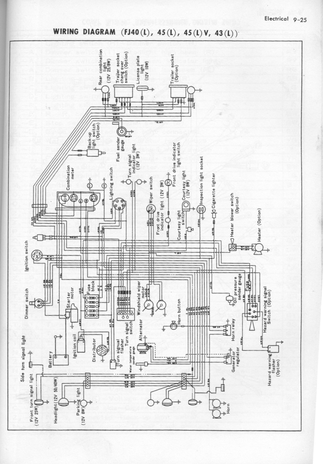

In2cruisers 10 Year 15 Year 20 Year Joined Aug 13, 2004 Threads 944 Messages 6,040 Location Normandy Park Wa. ........now in San Diego Ca. Oct 9, 2011 #1 Trying to un-F.U. my wiring..... seems alot of people have had alot of strange ideas over the years....have it basicly cleaned up...now just trying to square away Thx
destin 10 Year 15 Year Joined Apr 21, 2009 Threads 105 Messages 3,573 Location portland or Oct 9, 2011 #2 I saw this in a search ( different than my 1964 wiring chart ) this is supposedly 1967... no guarantee, but it should get you sorted enough Last edited: Oct 9, 2011
