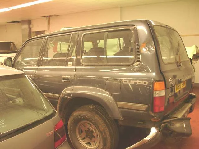

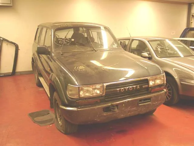

here's some pics of the vehicle in question. its pretty beaten up but seems not too bad apart from the damage done when the thieves broke in. i'm not too worried about the body damage, have been reading the custom rear bumper fabrication posts with afiar bit of interest :D

Looking at the pics it is a pre 95 model 1hdt disel engine, which will need the big end bearings checked, and / or replaced, if they havent been [aprox $400 Aus to do] and is done in car by removing sump.

Wow... that thing's rough as a cobb. I'd give it a good look over and list all the things you'll need to fix (with costs) to make sure you know (and the dealer) what you're getting into. Definitely a canidate for a pre-buy inspection by a qualified mechanic.

does that damaged D pillar make anyone else nervous?
did they back in to a concrete bridge with it, or what??
it makes me a bit nervous, too --
e
My 80 has a small D pillar dent in about the same spot. Not nearly that big. Mine doesn't make me nervous at all.
I thought about trying to 'ding king' it out.
I want that engine.... !
the damage apparantly comes from its involvement in a ram raid. i'm not sure which end when throught the shop window, presumably the front and maybe some part of the shop fell on the d pillar or something. assuming the dent hasn't caused any nasty distortion, it could maybe be hit out. i dont know yet, still at the stage of putting out some feelers about the vehicle to see whether is worth it or not.
let me draw your attention to the way the upper portion of the rear door lines up with the US DS d pillar.... there's quite a gap and it looks to be about equal from the roofline down to the upper/lower union. if the door were simply ajar the gap would be minimal at the top and wider at the bottom. the US PS side of the liftgate appears to be snug right up against the body. either the d pillar is deformed or the hinge on the liftgate is banged up...
maybe i'm just a nervous nelly or maybe the picture is presenting a funny angle, but i just don't like to mess around with the support over my occupants' noggins.

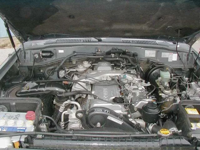

Here is one
As the label on the timing belt cover says Christo its a 1HDFT, The solid bar grille and turbo stickers make the pre 93 he is looking at a 1HDT :flipoff2:
PS 1hdt looks like a 1hz with a cross over pipe over the rocker cover with TURBO on it.

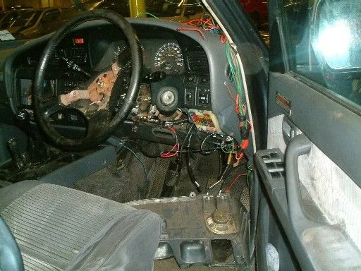

well, i got some photos back of the vehicle and i think i might give it a miss. for anyone that's intersted, here's a pic of the damage to the interior. The wiring rather scares me as i think it would be a major headache to put right again and there's quite a few bits of trim required. i'd post more photos, but i think i'm at my limit, i'll see if i can fit one of the engine bay, which aint terrible nice, at least in comparison to 'sleeoffroad's one.
any opinions on the matter?
