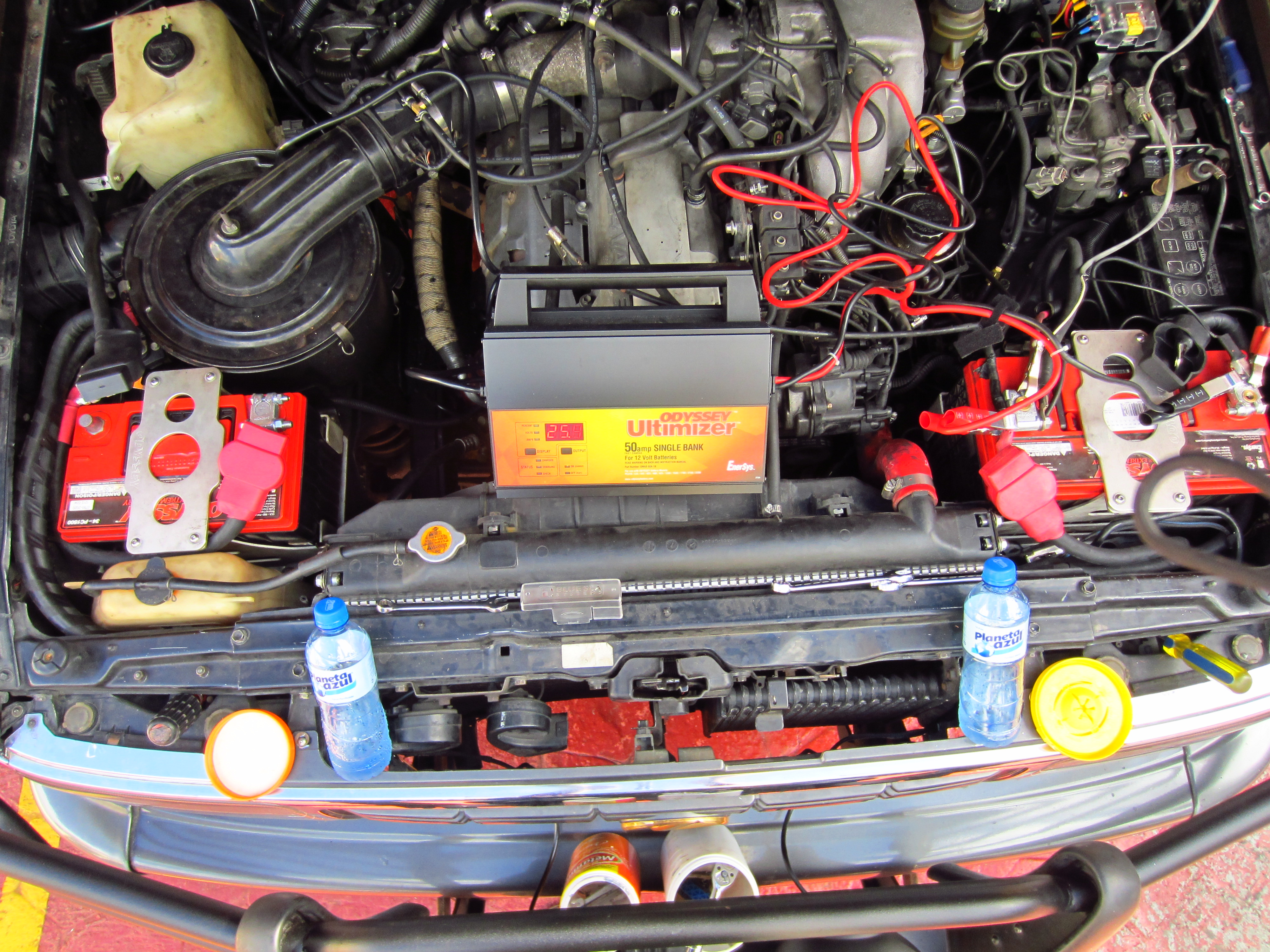

We have a PC2150 on the pilot's side and a PC1500 on the co-pilots side. We took out the stock battery box and used Odyssey's battery hold down brackets for an easy fit and finish.

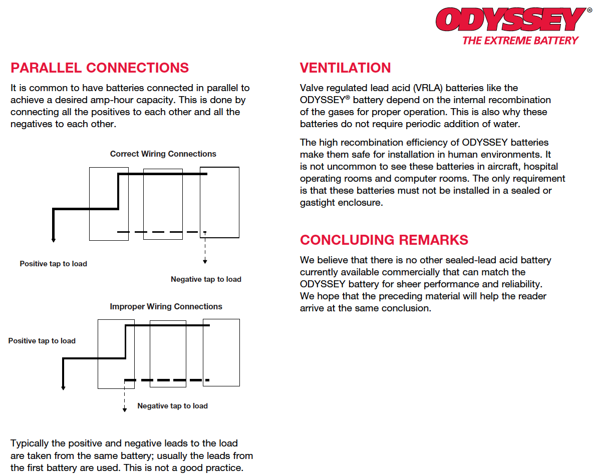

We also opted to connect both batteries directly in parallel but connected the loads per Odyssey's write up to maximize both batteries. The loads see just one, big battery.

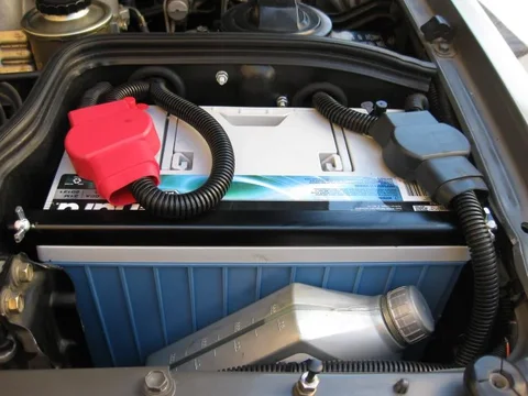

I don't have the Odyssey but the Sears Die Hard Platinum group 31. (same dimensions) It fits in the OEM tray but I had to make a slightly longer tie down bar, then able to re-use the OEM j-hooks.
Honestly the tie down example above is much better. The OEM j-hooks are pretty maxed out with the extra weight of the group 31.

I'm using one for Aux in the stock tray. I had to trim the fins, side & back, with a Dremel. Used 3/4" x 3/4" x 1/8" AL angle for the new hold-down bar. To clear the hood - J-hooks had to be trimmed and replaced the wing nuts for nylock. It's tight. Edit: I also used longer generic J-hooks.

Like Corbet said, you'll need to make a longer bar, but I also had to buy longer J-hooks. This battery is the same exact fit, no other mods done to fit.
