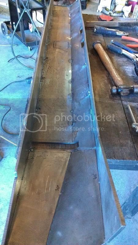

I thought this might be a weight and cost saving solutions for a back bumper.
Some more:
Some more:
Wow I had this exact idea to custom fab my own swing out and Jerry cans carrier. Do you have any shots of the work under neath the bumper? I don’t want to spend 2k on a metal bumper so this is a good alternative.
