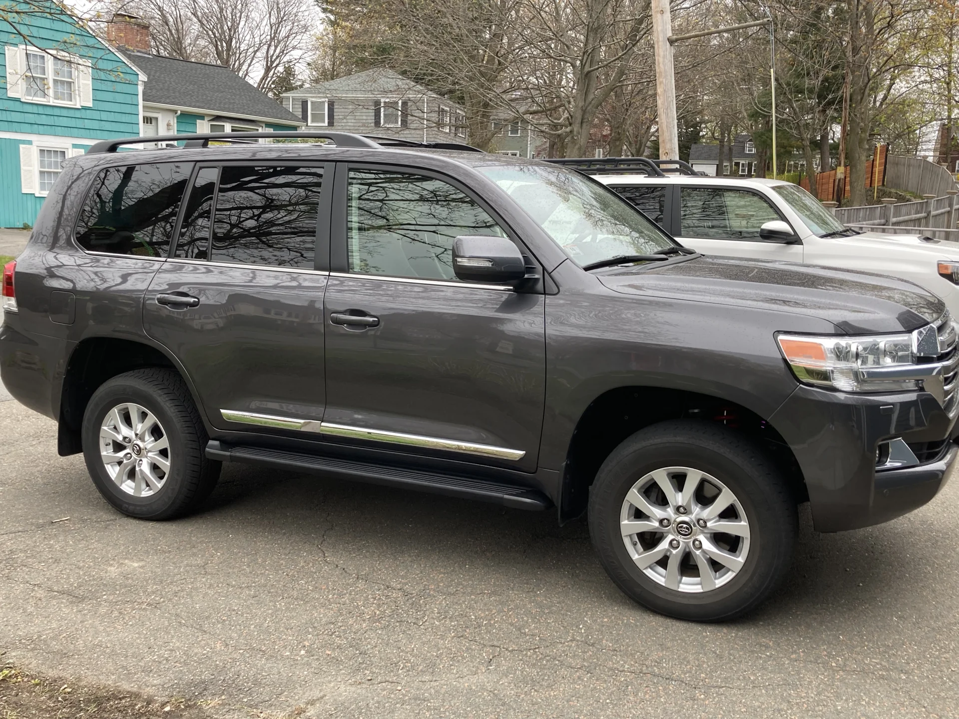

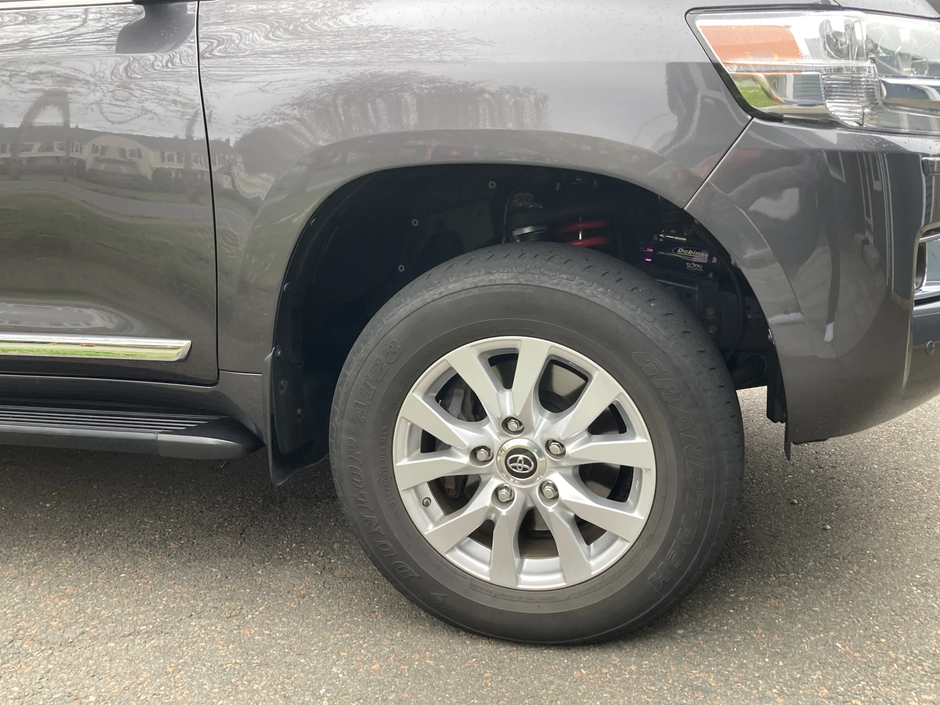

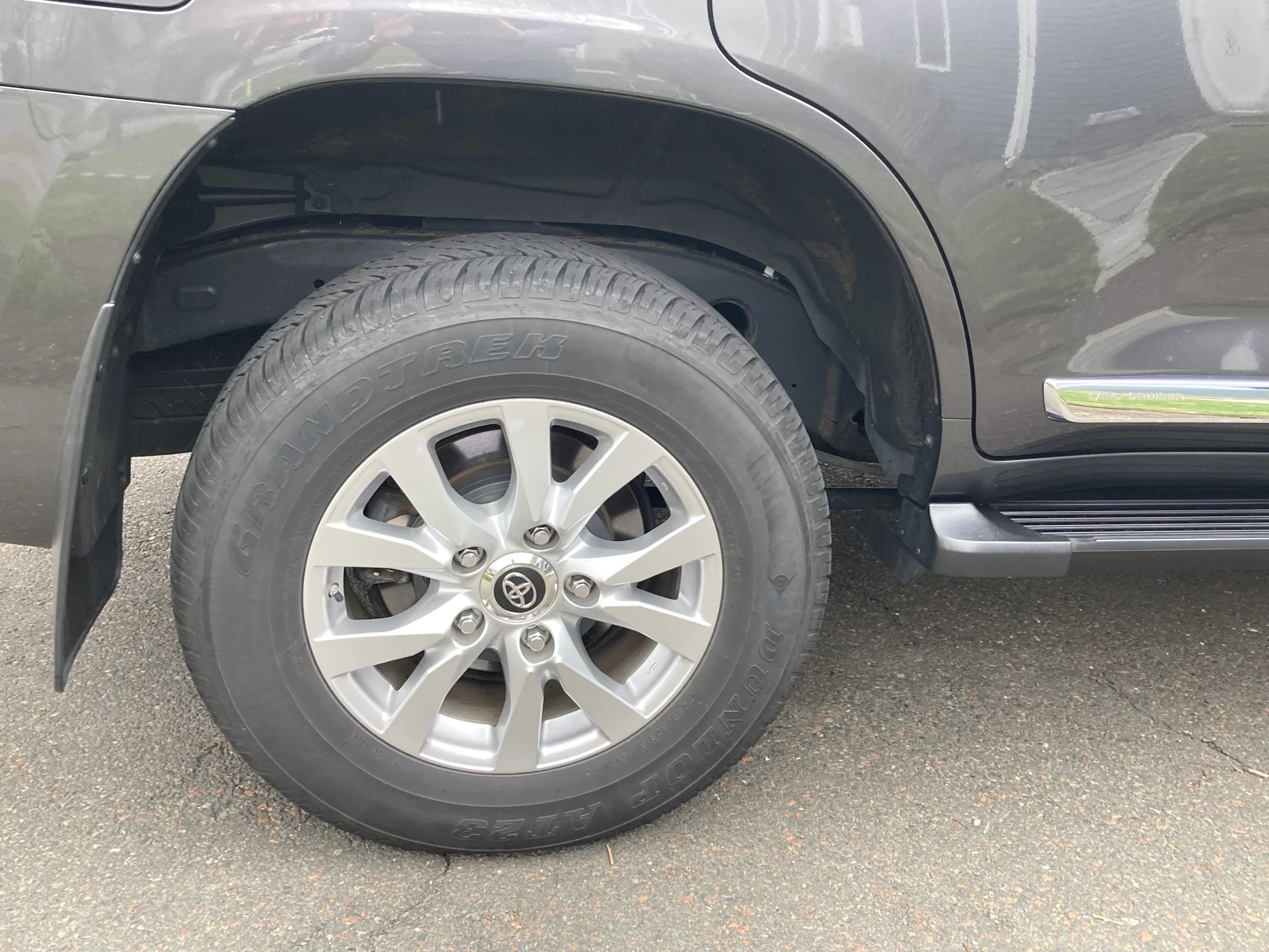

Hi everyone. I could use some help picking a good tire and tire size for my LC. I installed a Dobinson's suspension last year that gave me about 1" lift in front and 2" in the back. My truck is currently on stock tires. As you can see from the pics, I have a gap at the top and a little around the sides. Any suggestions on tire size. I'm going to run stock wheels, which I really like.

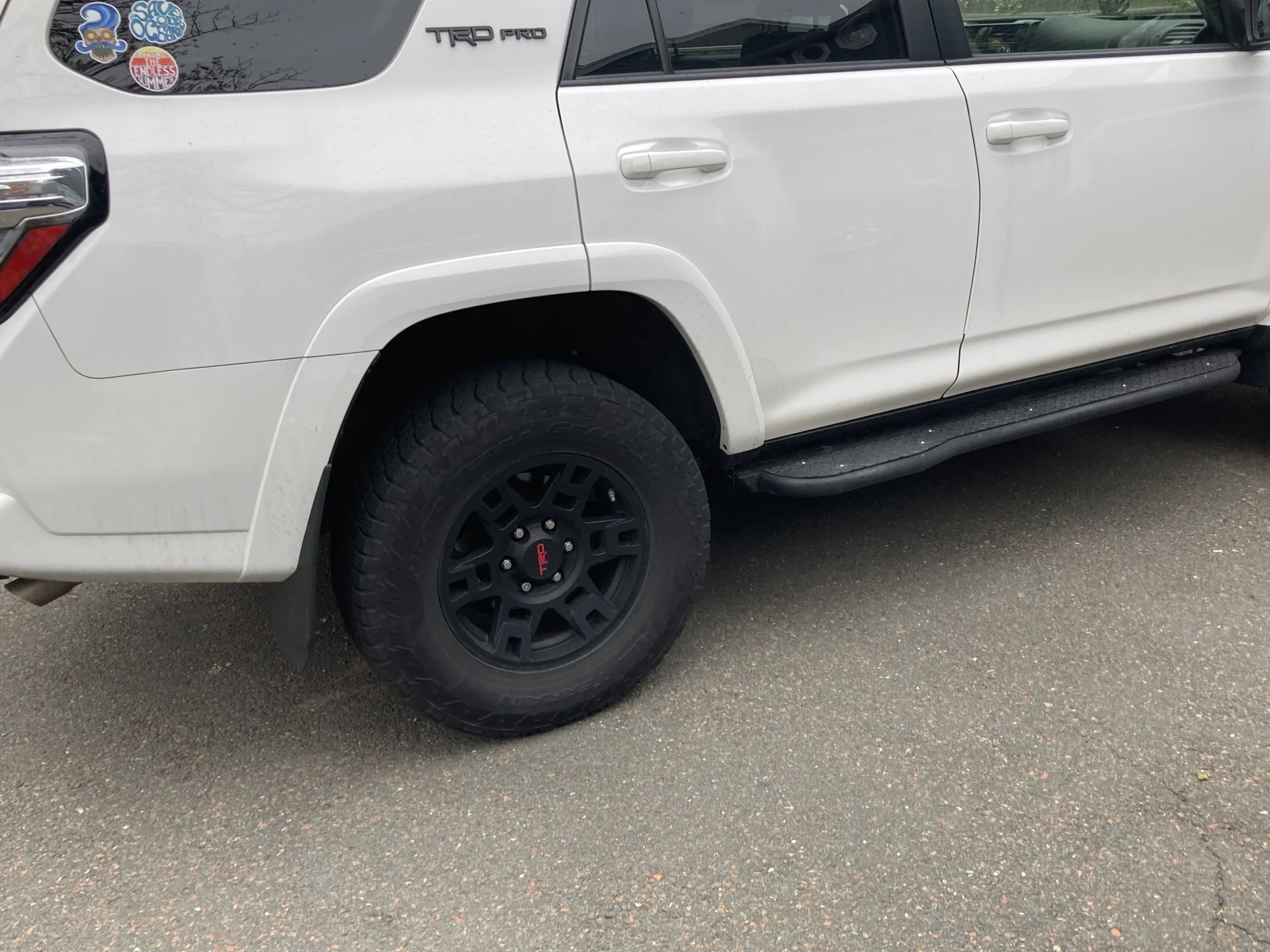

The final picture os of my wife's 4Runner. I would like the spacing in the wheel well to be pretty comparable. I don't like the look of tires that completely fill the wheel well from front-to-back, even if it means I have a bit of a gap at the top. Also, I don't want to do any trimming or need to remove mud flaps or anything like that. So I'm trying to be careful not to go too big and then have rubbing and that type of thing when I turn. I remember there used to be a google doc with all of the tire information but I can't seem to locate it on the forums anymore.

Most people on here agree that 285/65R18 is the correct size for what you're describing (a slight diameter bump without rubbing... usually).

275/70R18 (33.2") fills the wheel wells nicely. A smidge of heat gun and 2x4 to reshape the front splashguards.

If you do not want to remove or touch the front mud flap at all will probably have to go smaller then 285/65-18.
