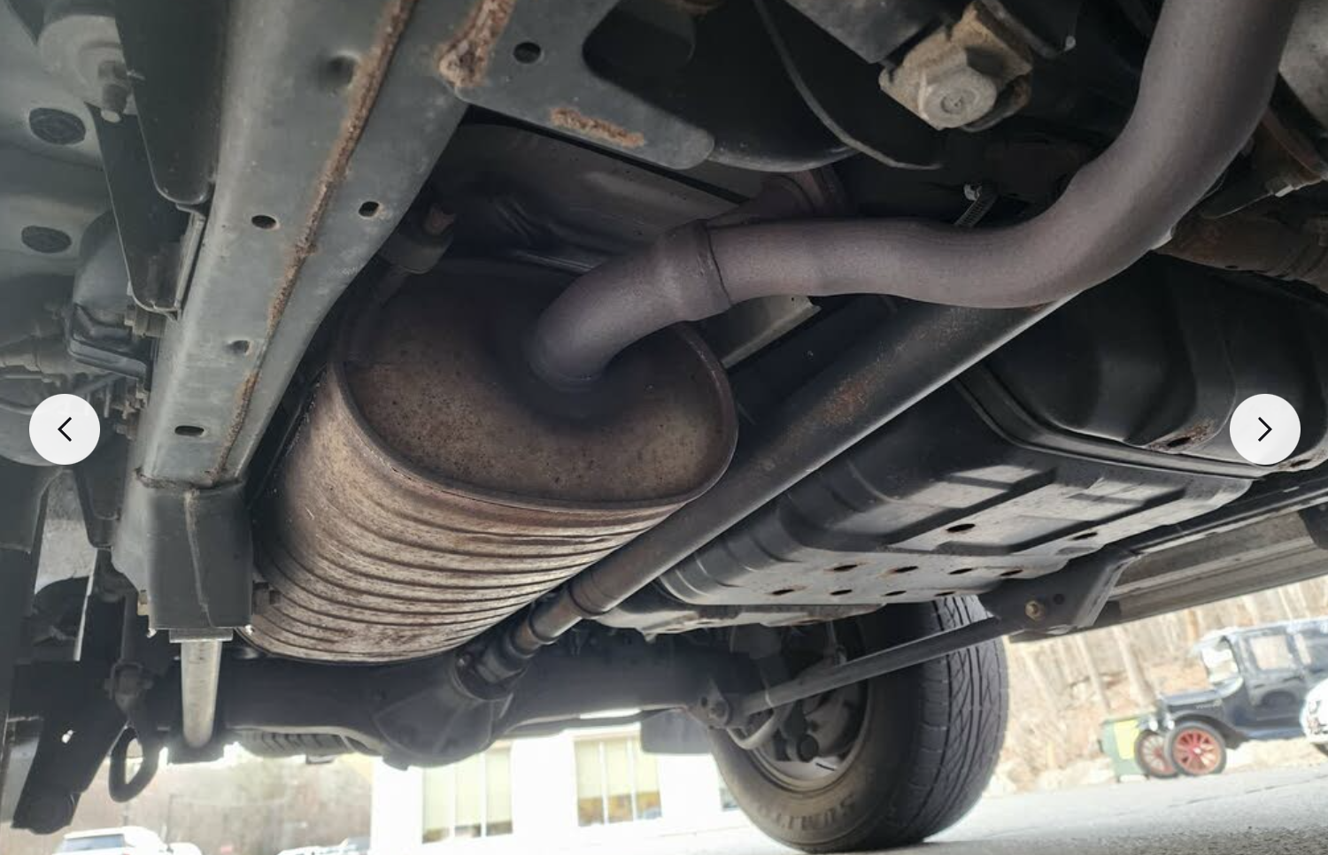

Going to look at a 2002 LX tomorrow. The pics look a little too good to be true for a 20+ year old LX that's spent it's entire life in the Northeast. It doesn't look painted to me, so only possible scenario it was garage kept. I'm wondering if anyone can see anything suspicious about it and/or offer suggestions on what to look for when I go take a look at it in person.
Also a seperate question, for the prepurchase inspection the seller is suggesting Lemon Squad. Has anyone used them or familar with the quality of the inspection? My instinct is to insist on taking it to a Lexus dealership, but it is more of a hassle for everyone involved.

I'm not familiar with the 470, but I have a 450 and have otherwise been fighting rust for a long time. The pics are decent, but still difficult to see exactly what is going on. That said, and as you said, this looks clean for a northeast truck. I can't be certain, but it almost looks like some of the frame has a film on it with dirt and bugs sticking to it. This would be a good thing and might be the result of one of the lanolin-based sprays like fluid film. I say this cautiously in that some of the frame looks dry. The 6th through 9th pics are the ones that seem / might have some extra film with dirt and bugs sticking to it.
Regardless, from what I can tell from the pics, I'm more optimistic than not, and if I were in the market, I would be on the way to check this out.
I always take a small and rather light, blunt metal working hammer when looking at a frames. I show the seller and ask for their approval to tap here and there. A small flashlight would be useful and less scary for the same. And do check out the area in front of the muffler on the first pic on post #3 to be certain that is is surface and not cancer.
Good luck.
@psmbfuer Thanks for all the insight and info! That's super helpful- will be sure to take some type of hammering tool and a flashlight to have a close look/feel. Interesting take on the fluid film/coating. Will try to see if I can tell if that's been done. From my untrained eye it doesn't appear to be painted as you can still see some rust and it's not all black also where it is black doesn't appear to have rust texture underneath.

Sure thing and good luck @abbenbrooke. I'd be interested to hear what you find out. And regarding something like a hammer, even keys can be useful - anything than can help you identify cancer vs surface - I like the hammer because you will hear an audible soft thud if there is cancer, or something like body filler, below the surface, whereas if you are taping on good steel, you will have a nice solid tap sound. I also don't see evidence of paint, but again, hard to be certain. Paint on a frame of a vehicle being sold is a red flag for me. Good luck with your inspection. A friend of my son got taken by a seller that actually covered holes in the frame with duct tape and then painted it black. It was very sad, the kid looked at the truck on his own, didn't have the experience, and bought into a real mess (I see no evidence of anything like that in your pics).

Just wanted to follow up after taking a look at the truck.....Pictures were accurate. Rust was fairly minimal and not an issue, no paint job, which is the first I've seen up this way. I'm not sure if they did fluid films or probably just garage kept and not driven a whole lot given the low mileage.
I ended up passing on it as price seemed on the high side and dealer would barely budge. The inspection report showed it needed a new steering rack, rear main seal leaking oil, rear and upper control arms had damaged bushings (or something like that), exhaust manifold was leaking. What they didn't catch was steering wheel was stuck in a high position and the climate control system would only blow hot air and wouldn't stop (not an issue in the 30 degree temps today). The truck was fairly solid, but it felt like and drove like a 20+ year old truck that needed some TLC, so kind of hard to justify the price with the known repairs and probably more unknowns.
