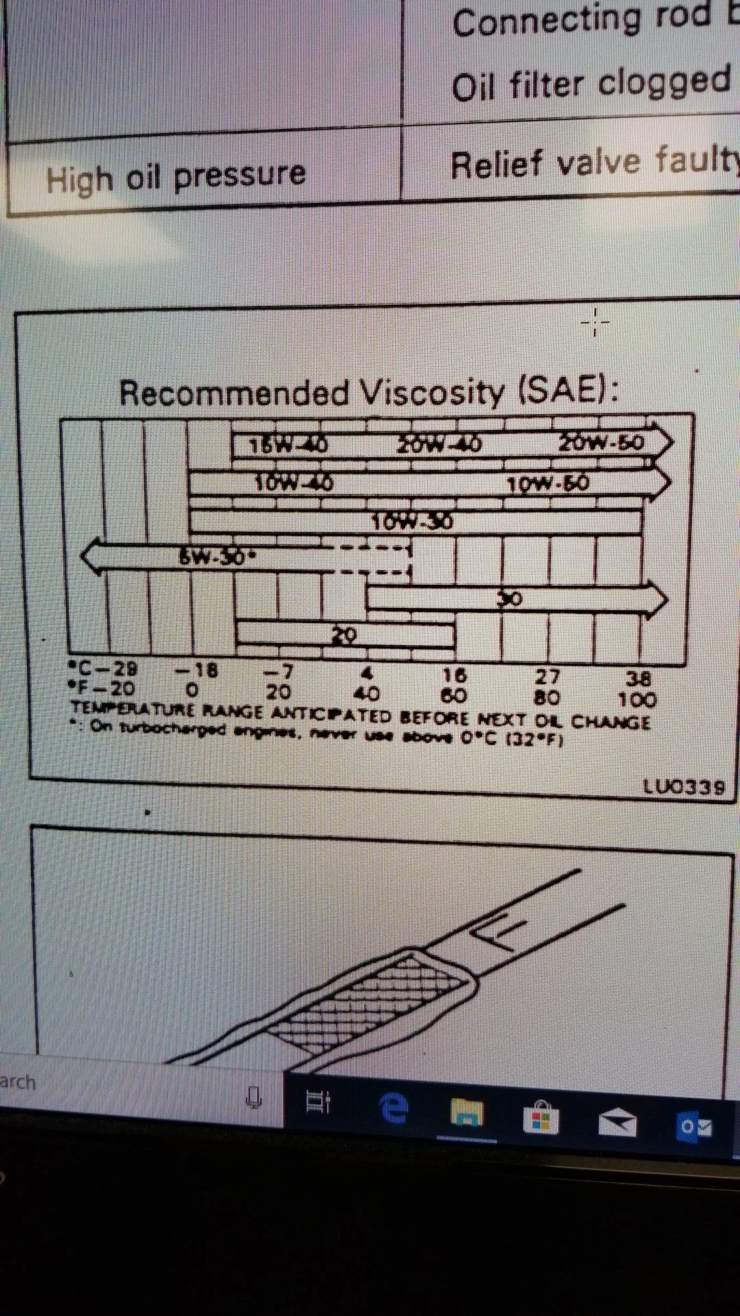

I want to change the oil before firing up the 60 again (3B). Rotella T4 10w30 is everywhere but I think I want 5w30 being winter. Should I make the effort to get it or is 10w30 good enough? Nothing too cold, usually above freezing here but it can get down to 10 below sometimes.
The FSM has an temp oil chart that gives you a graph showing which oil to use
For a 1hd-fte but any older Toyota diesels will be the same.
C. We are in the modern world in Canada and Australia. Looks like 10w30 should be good. Even 15w40
