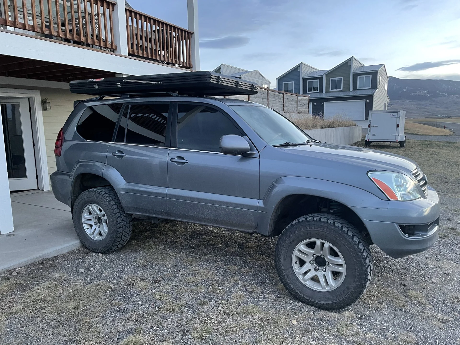

I have a dobinsons 2.5” lift on 285 St maxx with first gen tundra wheels and this is how it looks. I love it but I’m probably swapping wheels in the nearish future
Thanks for the reply. That looks great! Do you have any rubbing issues?
I had rubbing in the front and back of the front wheels so I cut the front bumper a bit (you can kind of see it in the picture) as well as a BMC and now I can go full flex lock to lock with no rubbing

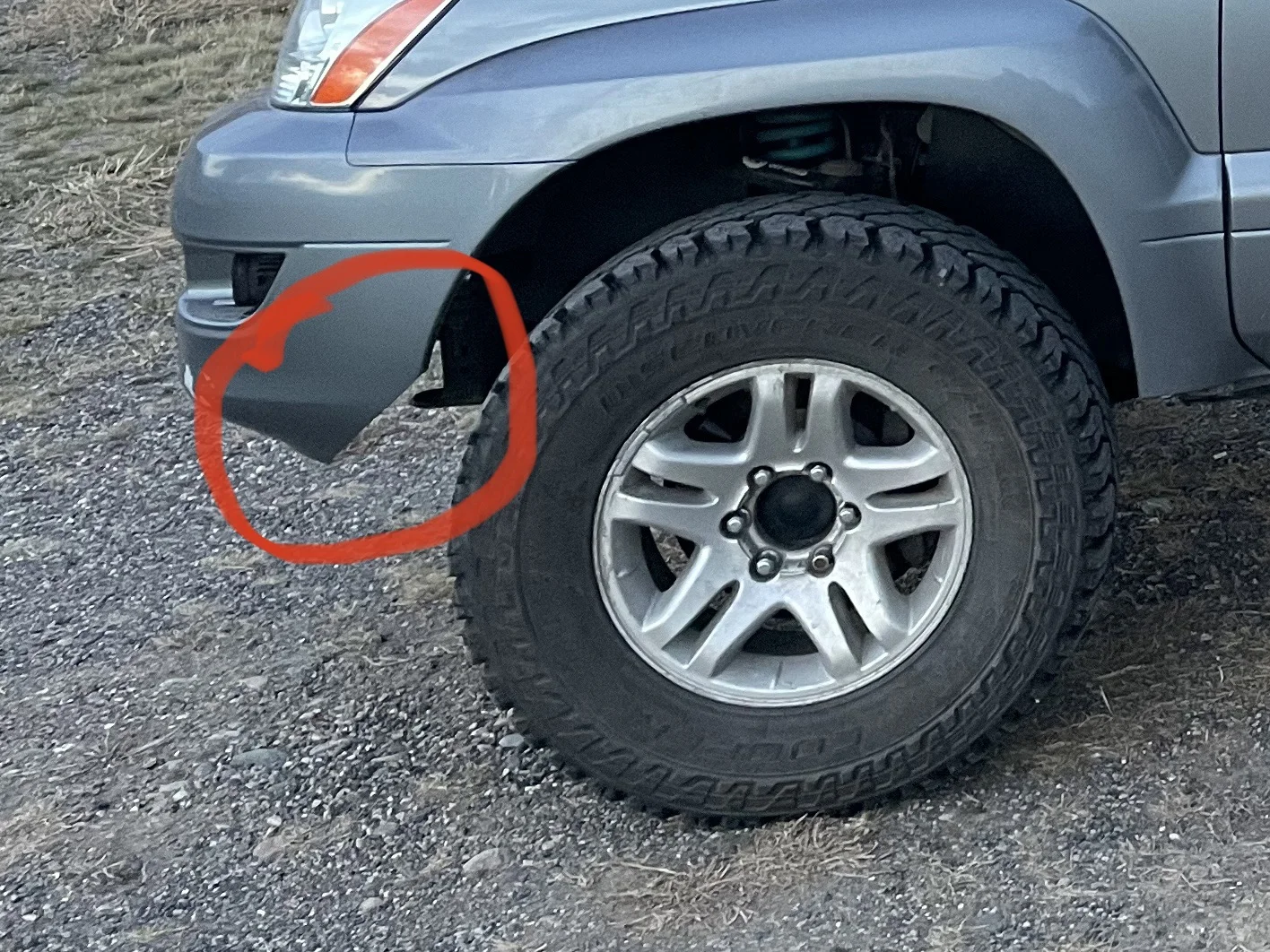

Gotcha, what is a BMC? And can you show me what your fenders look like close up and how you cut them? I’m assuming a sawzall or something.
Thanks
If you look in the first pic you can see where some plastic is missing. I cut more than I needed to just because I plan to run a steel bumper at some point so I wasn’t worried about cutting up my stock bumper. I used a multi tool with a fine tooth metal blade and it cut like a hot knife through butter. The second pic is the BMC (Body Mount Chop). Pretty common on Toyota/Lexus vehicles running oversized tires. Some people don’t like it, and many others don’t mind, all depends what your desires are with the vehicle and what you actually plan to do with it
