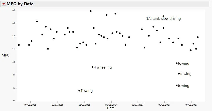

By your averages, you sound like you track it every tank. Publish up all your tanks. Not saying you are, but most people tend to exaggerate their MPG's at both extremes, and memory is easily biased towards the present. I'm between 11-13 all year long, unless I'm towing, or off-road, then it's straight-up abysmal. I don't take this one on as many long road trips, usually take my wife's '04 LC. This is unadjusted, straight odometer miles travelled / gallons per fill up (ACAR app). I run 295/75/16's, and a mild lift. 255K miles. AC runs pretty much all year. Daily commute is ~15 miles each way of surface streets with typical 45 mph speed limits, and an average of 1-3 stop lights per mile.
and dang, I am NOT getting out and burning full tanks of fuel on the trail enough. I need to burn my fair share of the earth's petroleum, before it runs out... On that note, have you ever calculated how much (gal and $) you've spent on cruiser gas? 250K miles at 12 MPG = 20,833 gallons of gas. :eek:
