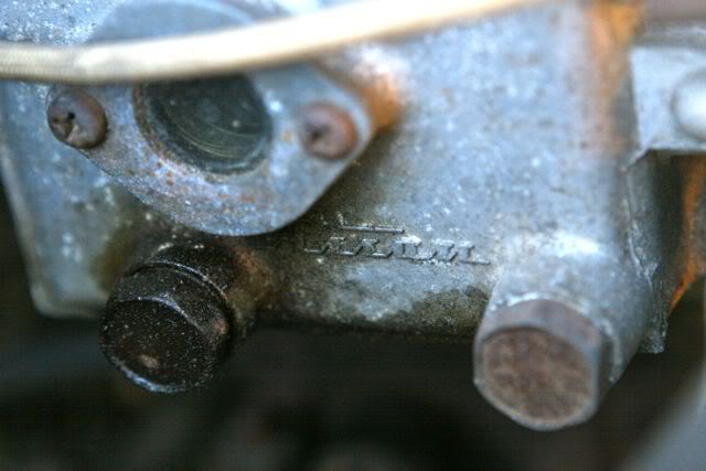

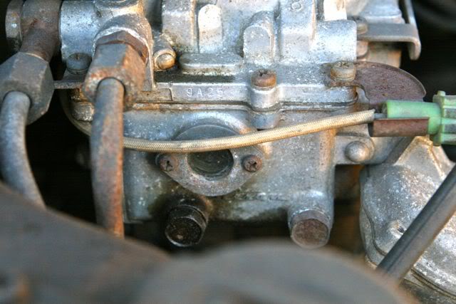

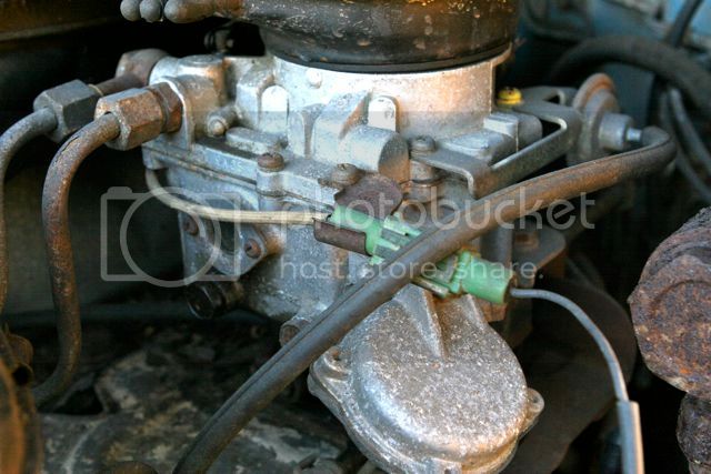

This has the "non-US" carb which means little to me being such a novice to all this. I ponied up for the FSM from Coolcruisers and don't see any type of model/part number in the manual. I guess I'm asking what was asked in another thread, where is the ID for the carb if I wanted to order a rebuild kit.
Even though I'd guess its a vacuum situation since its appeared to have been "de-smogged", I'd like to get a rebuild kit, just in case. Here are some pics to help with the identification. It should be from a 85 FJ60 2F.
WTF does that say...

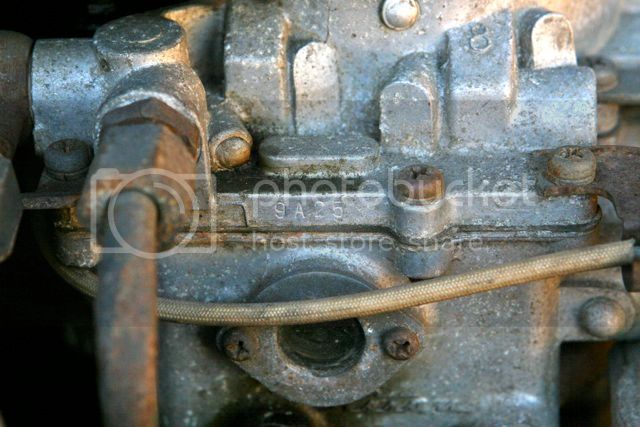

Can see the "9A25" stamped on the body...
Thanks in advance for the education and guidance...
that says aisan..........stock carb and hubs.
