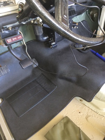

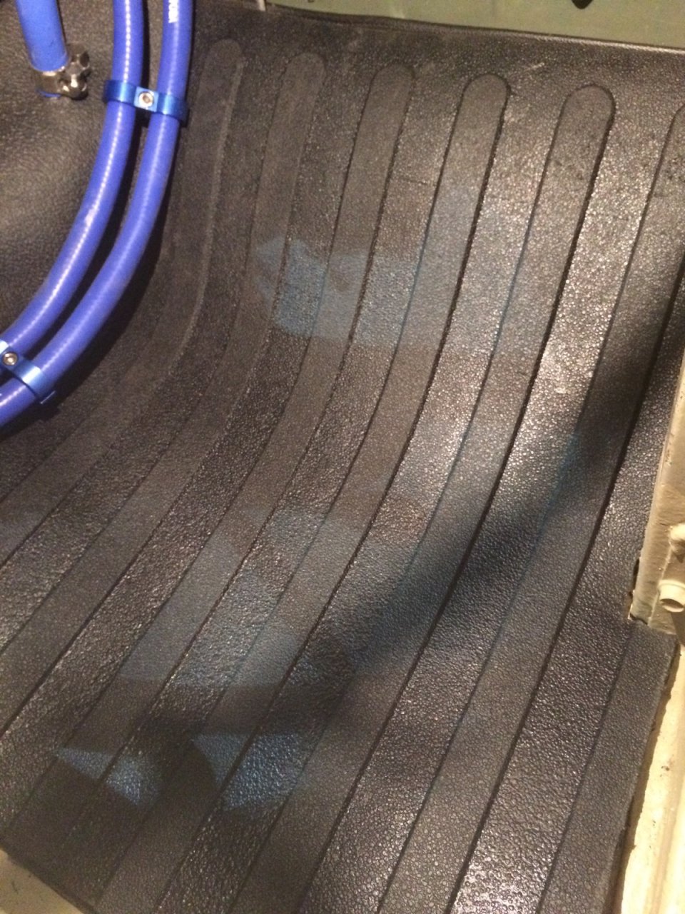

Back when the mule was my go to pack animal at deer camp, I went round the merry go round with the less than stellar heating and the effects of ambient air temperature on 16ga steal. Nothing to the extent that you are experiencing but problematic and irritating just the same. I solved it to a great degree, at least where the cold metal is concerned, with the CCOT front PVC mat and a horse stall mat.

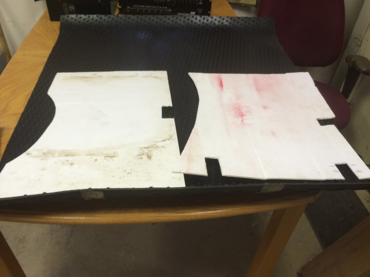

Shot of the aft section. Very similar pattern.
Front PVC mat. I used some target backer to make the pattern for the front mat. Same stall mat I used on the rear.
Again, I didn’t test it to the conditions you are experiencing but, it did significantly help.
